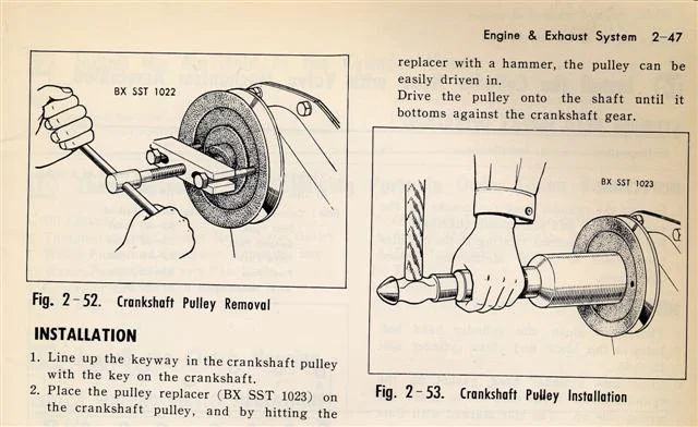

Anyone got any good tips for removing the crank shaft nut/pulley? Unlike the last one I did on my old '77 this one isn't a nut holding on the crank pully rather a solid unit.......
You need to use a puller:
attachment.php
Note this is from a '62 manual w/o the harmonic balancer (liked the pic with the install and removal), it works exactly the same with it ;)
Tucker

awesome Tucker!!
