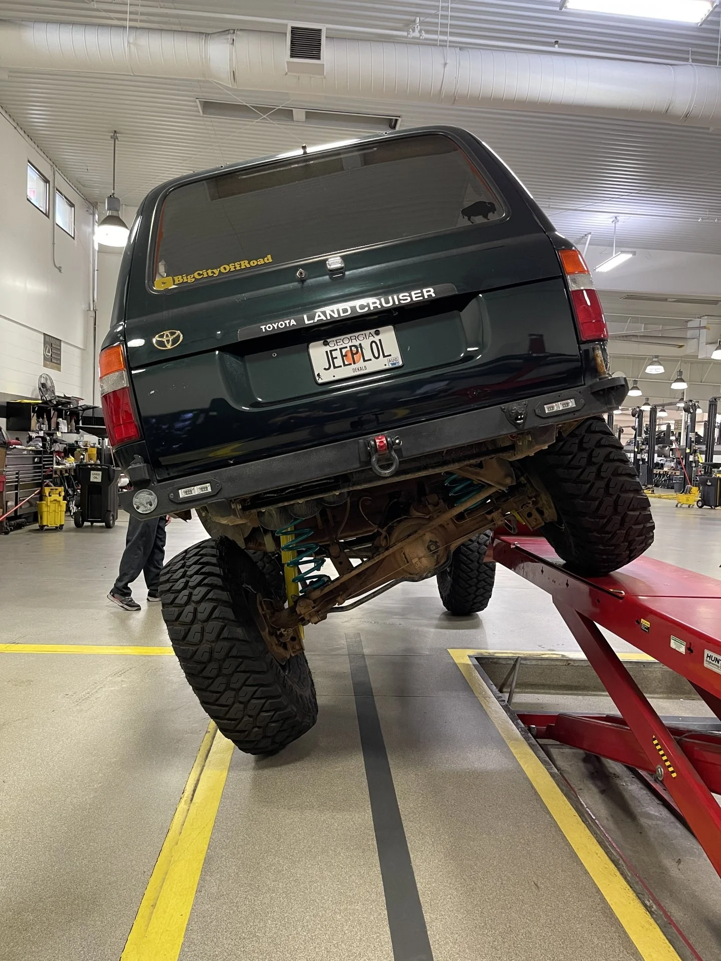

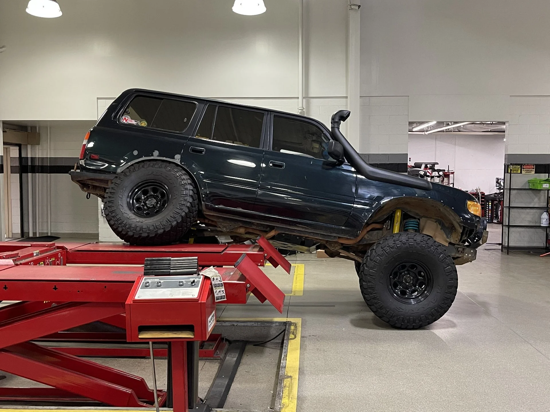

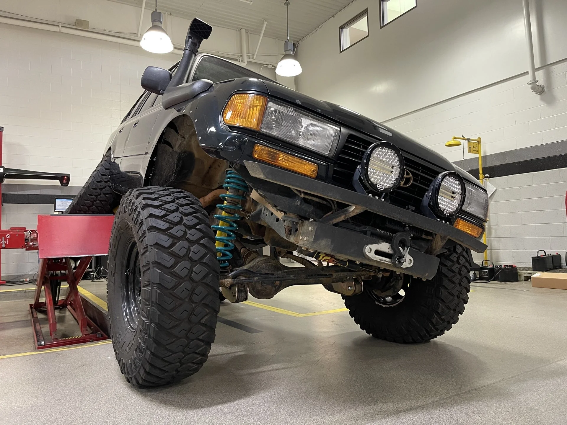

I running the C97-146VT as well, I getting 3.5" of lift from these 2.5"springs even with a heavy front bumper, 10k winch and a 78lb.battery. And the Rig is set for this ride height. My last set up I had 4.5" of lift ( OME & 30mm spacers ) had it dialed in for that lift extended brake lines, dbl cardan lengthened driveshaft. etc.etc.
When I went to the C97-146VTs I new they had a much taller free height and to try to take advantage of this I got the 6" lift shocks .
Well the longer shock do let the front axle drop out more but this was maxing out my extended brake lines (so I modified the hard line/mounts ) My Hydro Lines that
were fine with the 4.5" lift were now being stretched to the max !, My long spline driveshaft was extending to the end of the splines ( not good ) and I did not like the way the panhard would pull the axle way over to the side at full droop causing the spring to rub ( clank ) on the frame and bump stops.
Now if you have your Rig set up for a 5 or 6" lift some of these issues are already taken care of and I would have address them as well.
But for me the hole idea of the longer shocks was to try to get more articulation with the taller free height springs.
What I found was that with the stock control arm even if you grind the tops ( I did ) for more clearance , the arms are limiting factor.
when testing with the springs out, I was not getting any more articulation then with the 4" shocks and I could see it was trying to rip my brand new bushing right out of the arms ! Real world testing show the same results.
If one was to grind more and had old bushing maybe you could get more articulation 🤷‍♂️ not sure.
In short theirs only so much you can get out of the stock arms ! You need to go to a three Link to get those Sexy Flexy Instagram shots :rofl:
I ended up getting a set of the 4" lift shocks, They allow the same articulation with out the other issue.
PS, if any one is interested in the 6" lift shocks they were on my Rig less then 200 miles, PM me

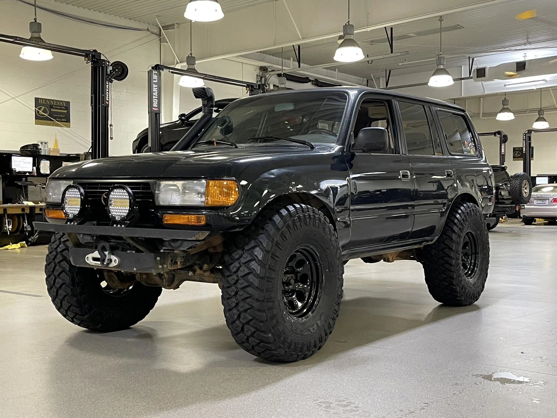

Just got mine installed. My truck is pretty light right now, my home built built bumpers are hundreds of pounds lighter than most and my cargo drawers and spare are not in the truck currently. I ended up with 6-7” of lift over a stock truck. This before picture has stock springs with 2” spacers all around. The second picture is an empty truck with the new springs. Im looking forward to filling it up and seeing where it sits then. A big thanks to @ExpoMax for the quick and personal service, much appriciated!
The 6-7” lift shocks, front and rear. I figured im losing so much up travel with 40s i could use the longer shocks to my advantage. That has yet to be tested, theyve been on a week, and only driven 15-20 miles on road..
I was thinking the same thing. but ended up going back to the 4" shocks. The 6 -7" shocks created to meany issue without any benefits that I could see. They wer on the truck one run and less the 100 miles. I am running a smaller lift and that could make a difference.
Keep a eye on the DS, brake lines and my Hydro lines were a issue. those shocks allow a massive amount of droop.
