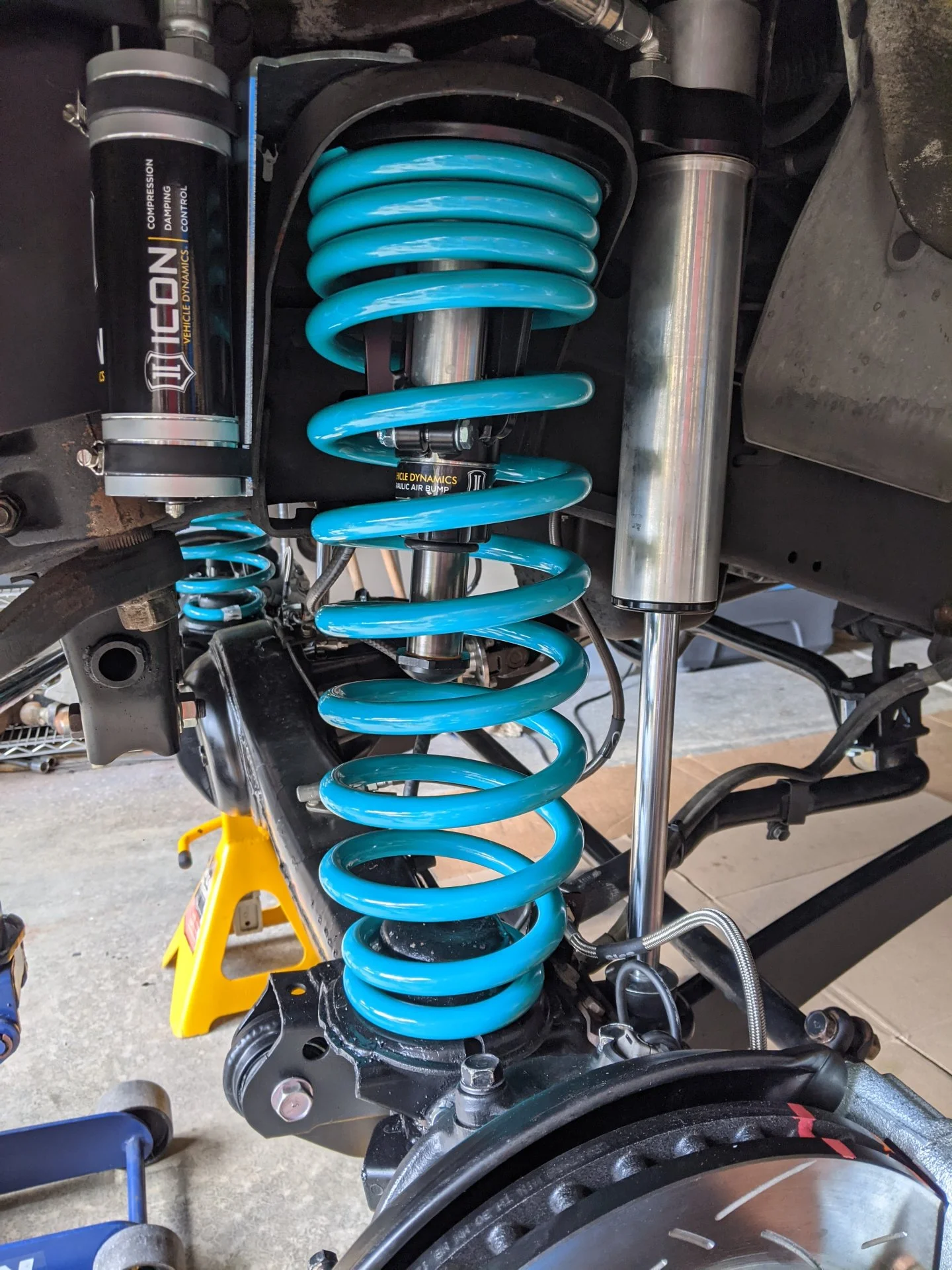

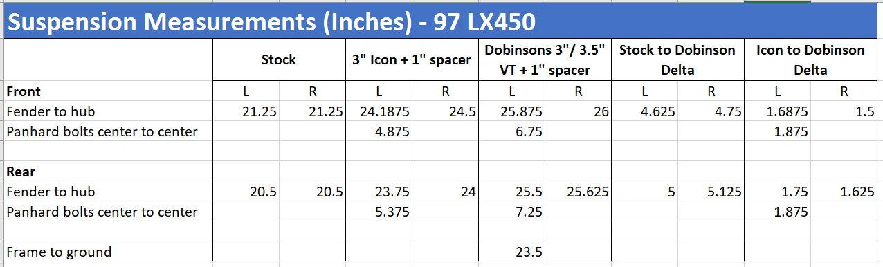

New VTs are in (144s and 145s). Front ended up exactly where I'd expect. Rear ended up about an inch high. Might pull the rear spacers if the rear doesn't settle with some driving and gear in the back.

Fronts installed w/ 1" spacer

Have you ever scaled it for actual axle weights? BTW nice looking rig

Thought about your setup last night and trying to figure how I have an extra inch of lift with just the springs alone here. One, obvious, I'm still on the light side but I think the 6" MRR's are adding another 1"-1.5" lift on the front. Set them per spec but thinking I'm on the light end of their setting so have to soften them up which probably has nothing to do with static height and, man these suckers did not like to be collapsed by hand. Pretty convinced until broken in I will be setting high. Thought it was funny that others mentioned shocks would add lift but I'm now a believer.

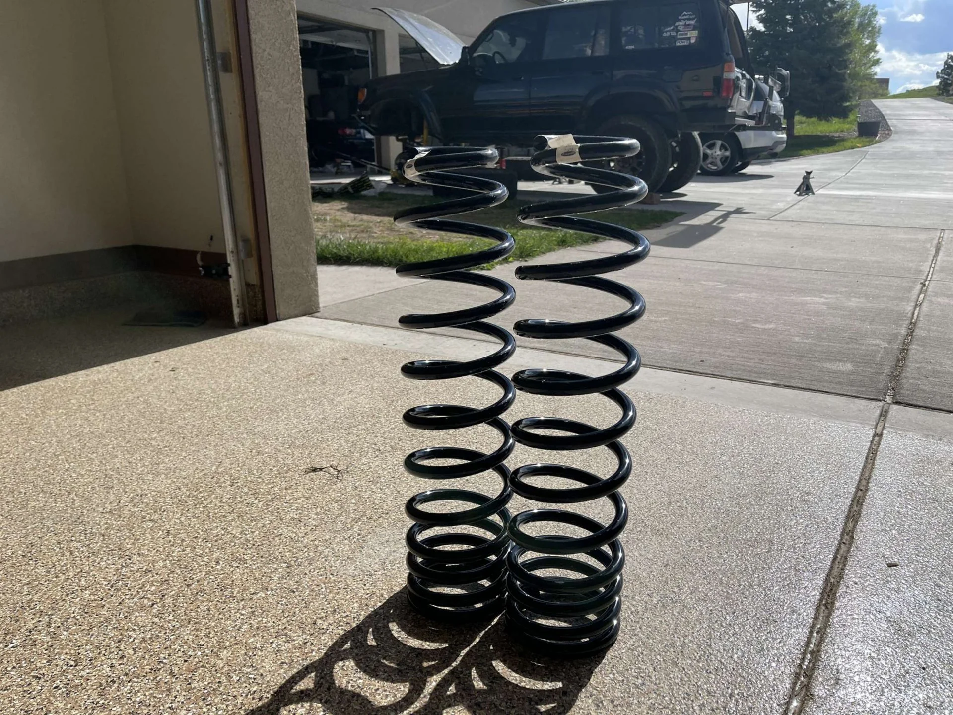

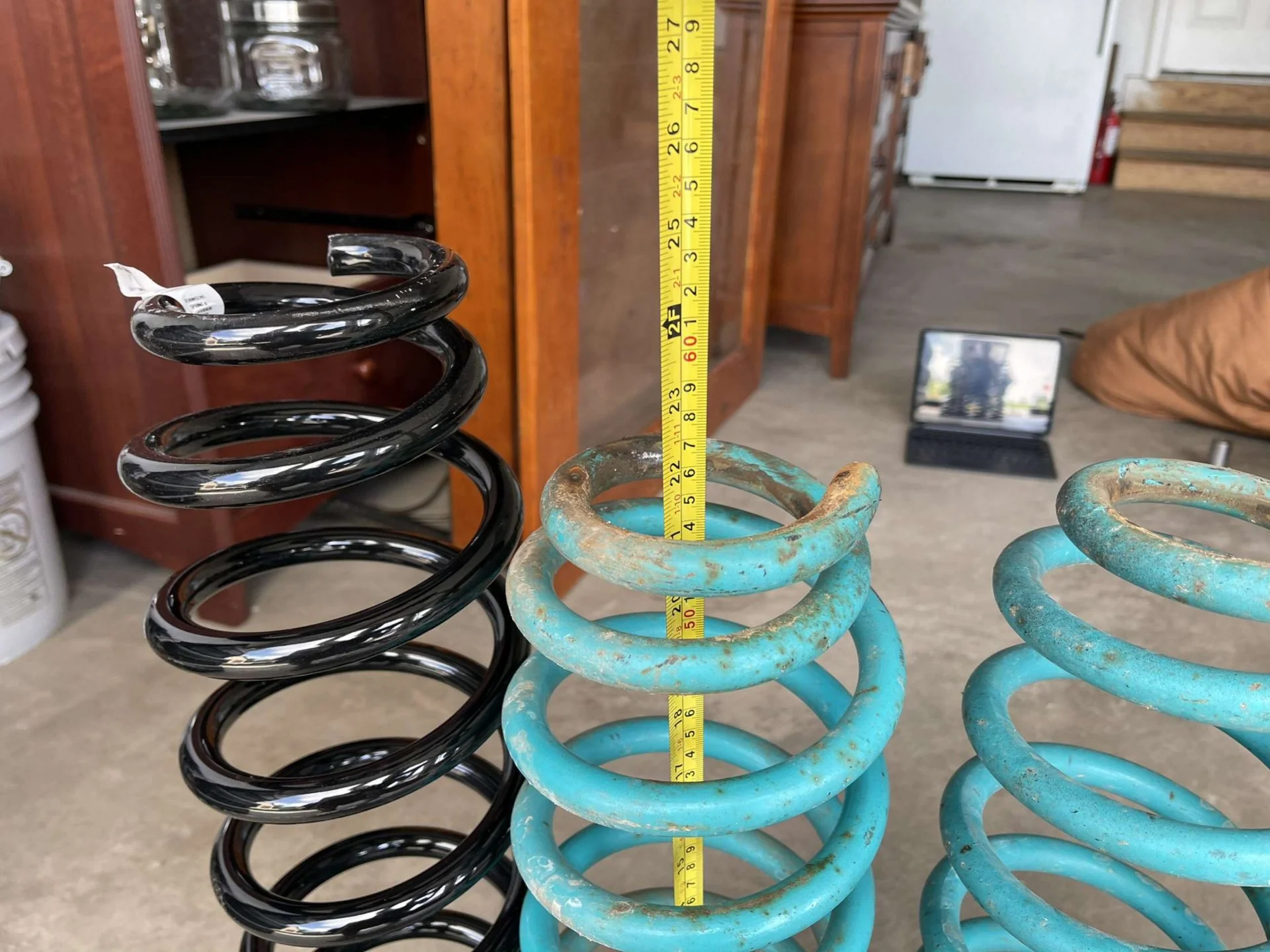

Unsure how to validate if I got the old VT's vs the new.

If the spring wire is actually tapered at the top of the spring = old VTs. If the spring wire is uniform diameter - new VTs.
