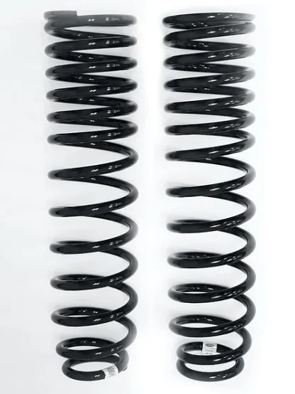

Hey everybody Huddexpo here! I was on the phone with David Otero earlier over at Dobinsons and I'm happy to announce a total redesign of their signature Tapered coils for our trucks! This new design will be replacing the existing tapered coil line. As far as I know across the board for all vendors all existing orders were upgraded to these as well. They should be out in the world very soon. They will offer the same ride quality and weight handling characteristics but will now be stocked in black and with no coil slap noise. Price stays the same at $400 a set.
Huddexpo will be running these on both our trucks so stay tuned for first impressions. More specs to come as well. If you have any questions feel free to message us or reply here! Mud members get a discount so hit us up!

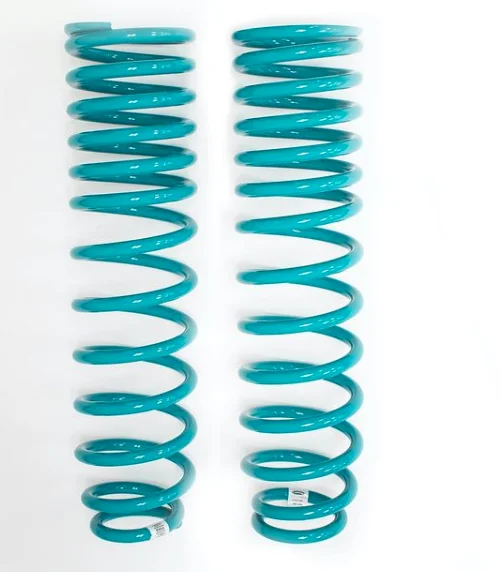

Mr. Dobinson redesigned the springs to streamline manufacturing so (hopefully) they can stay in stock and the old price point can be kept ($400 vs $440+). They are still "heavies" so expect more than advertised lift on lighter trucks, but the go to for heavy pigs. Reduced coil slap comes from the distance between the coil wraps and the spring zone your truck normally rides in.
^ So, I guess the pictures of the black vs blue springs are photoshop - since they look identical in coil to coil distance :)
Anyhow, thanks for the info. Certainly prefer the black colour versus the 'trendy' blue or green or ....

Sounds Great! They now come as an option in black, old teal is still available. Picture was not a comparison, just the two available colors. Sorry for the confusion!

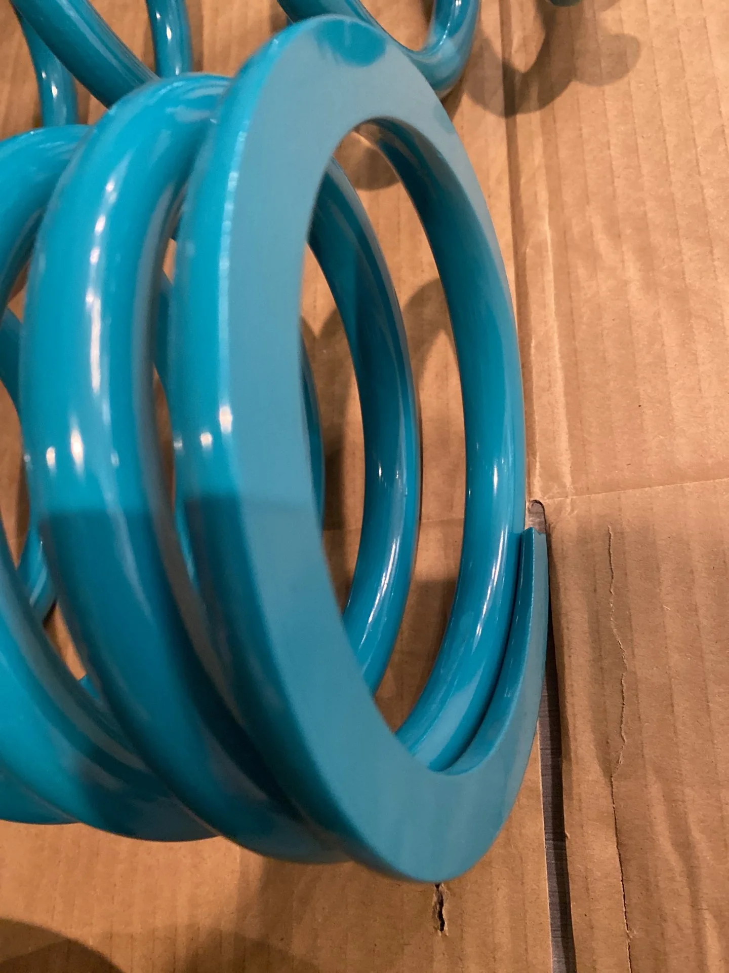

Just from looking at the pics given they seem to be of the same wire size all the way up like the Flexi coils. Also @on the rocks set are not ground down flat like the 1st pics. just chopped off.

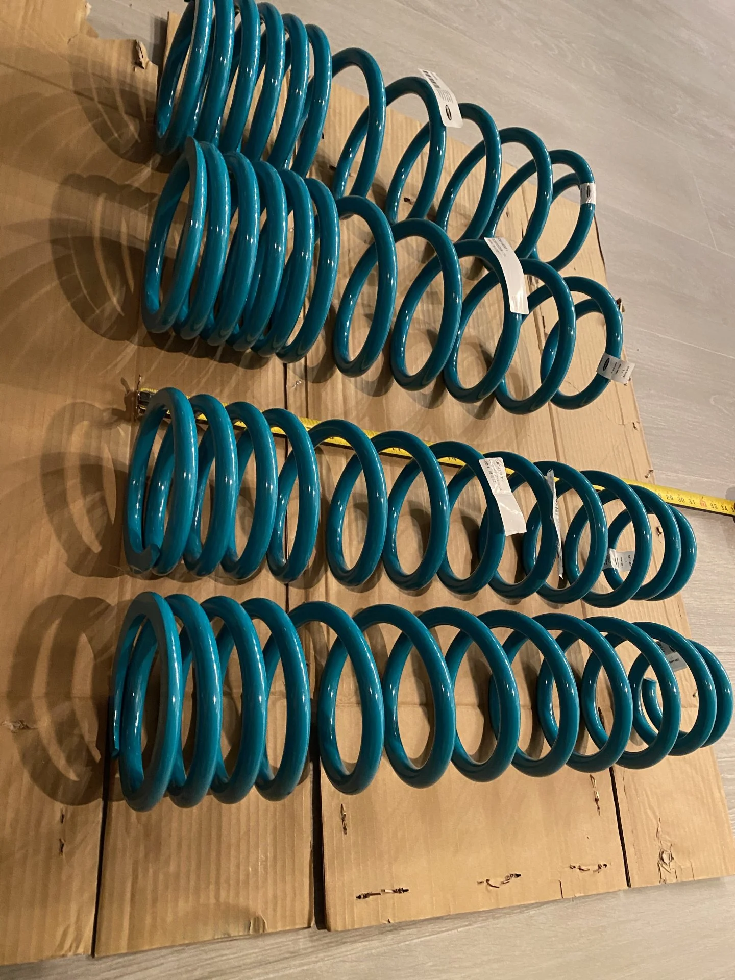

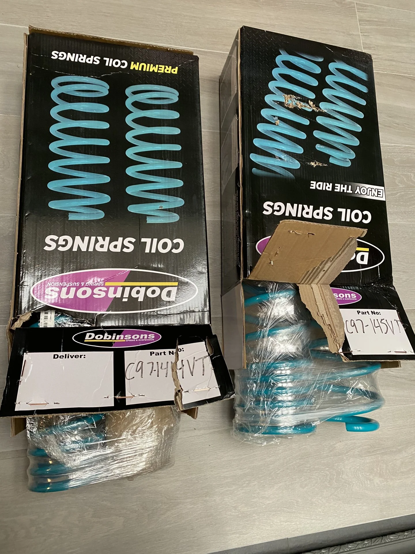

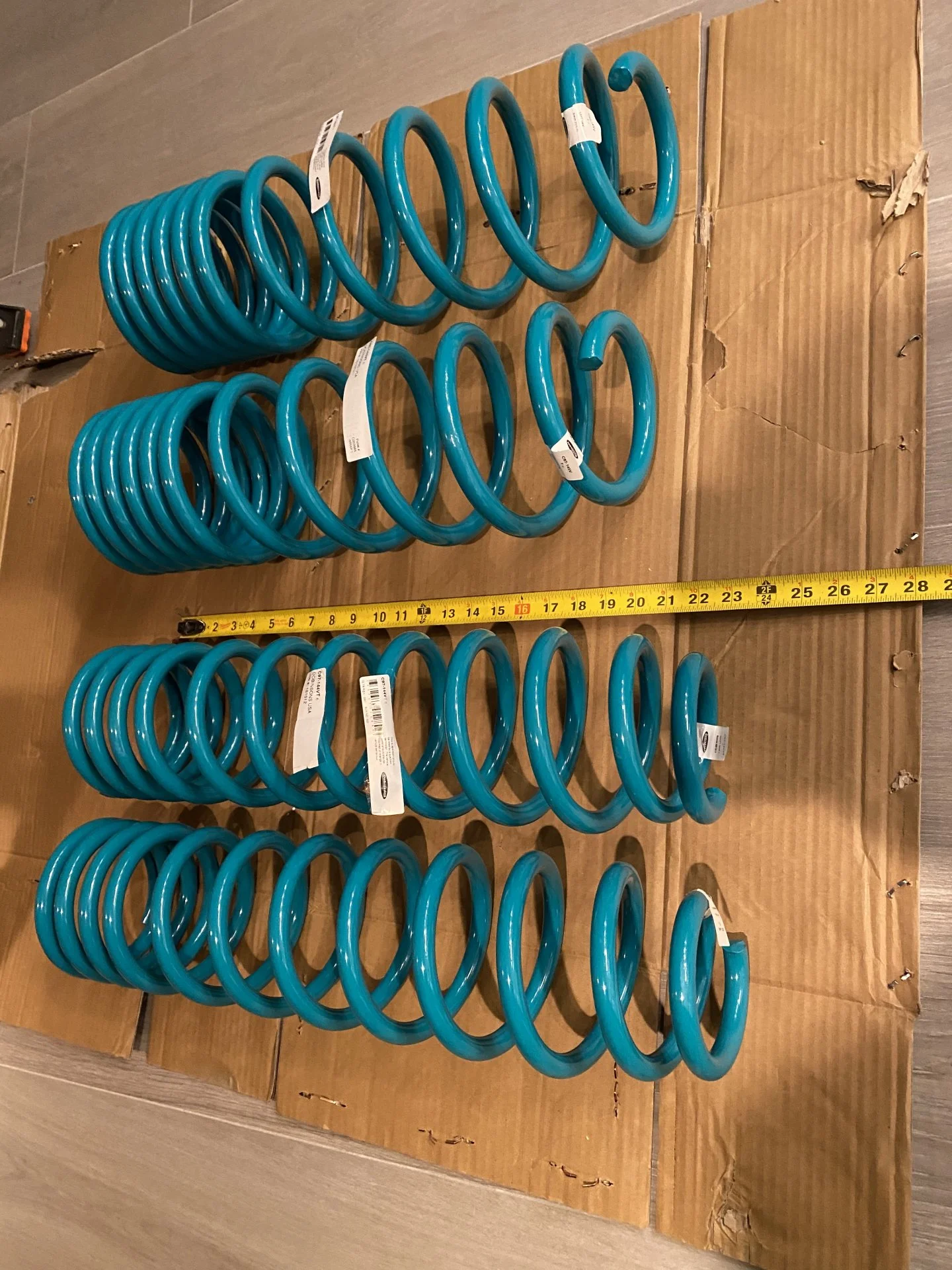

So are all the latest shipment the new production run? Outside a job number I have no detail. Both 161012 pallet C003686 wrap1. R-batch 21/1-15; f- batch 20/12-1
Coil diameter is roughly .715 rear/ .655 front. Seems fairly consistent. Round coil tapered end / flat top side.
about 21” rear vs. 24” front and do seem to be cut flush.
Good info.
Front .655 = 16.637mm
Rear .715 = 18.161mm
Those are just quick numbers but pretty close. I figured I would let the HuddExpo guys give an official measurement.Looks to be fairly similar on the front with thicker coil and more turns along with the thicker coil on the rear.
Speaking on the front coil, looks to be about 12 winds at a steady 16.6mm coil based on @on the rocks specs, so less winds with a thicker overall coil at the same free height to the old tapered coils.
Oddly enough comparing them to the 4” flexi in specs they are similar in diameter and turns but with ~1.5” taller free height. That taller height should increase the spring rate a bit for us heavier trucks.

These coils do not appear to be tapered but maybe a different version of the flexi coil.
All the pictures above are Flexi coils but the box has the Tapered coils part number. Am confused.

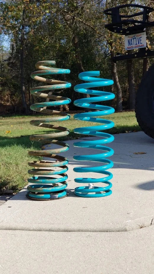

I just replaced my Flexi coils with Tapered coils and the difference is exactly what I was looking for. Unlike @Shoredreamer I thought the Flexi coils had a more linear spring feel and that the Tapered coils have a soft initial bump followed by rapid ramp up. The main reasons I changed from Flexi to Tapered was for the weight handling and bottom out resistance.
4" Flexi left with 3" Tapered right
The coils might have had a slight diameter variance of about .05-.10 from top to bottom going larger to the bottom of the spring(I grabbed the middle on the measurement due to this). I wasn't in a good position to get exact numbers and not today either but I do know it was something that caught my attention and had me checking throughout the spring. I'm sure @LC4LIFE can clarify this on the follow up. Not sure if this is in the design for the taper spring?
