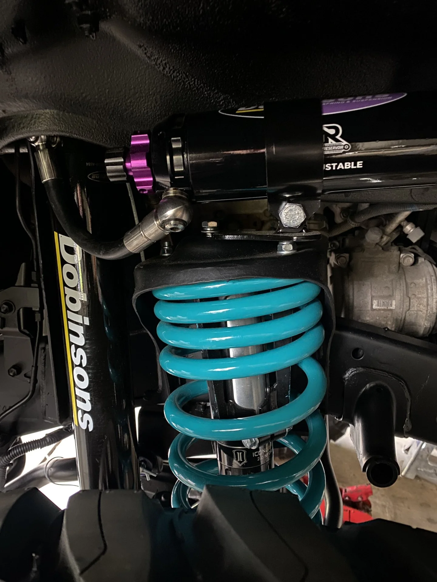

Got the front's in. Thinking it needs to settle yet as I'm seeing a bit over 5" of lift on the ground. In a bit of a holding pattern until I get my steering box back and the front together, Full extension with the MRR 6" and no issue of these ever coming out, especially with the radius arm setup. Need to get my replacement Delta bumper on and winch and hope to see it settle more. Target was 4"-4.5" and seeing well over that. Tried to compress and couldn't even get it close to tire stuff or shock compression. Crappy old OME rear shocks and no rear SB is keeping it from compression up front. Even with a heavy duty ratchet strap up front helping lol. Couldn't get to the high lift on the back. Rear still sitting at about 3.5"lift.

Wonder if they are engineered not stack like the Icon coils do.

Wondering the same. Those gaps are full weight on the front. Front is moving up and down fairly easy so no binding. Though I saw coil rubbing issues on the gen 1 VT's and I have tons of clearance on these so far.
