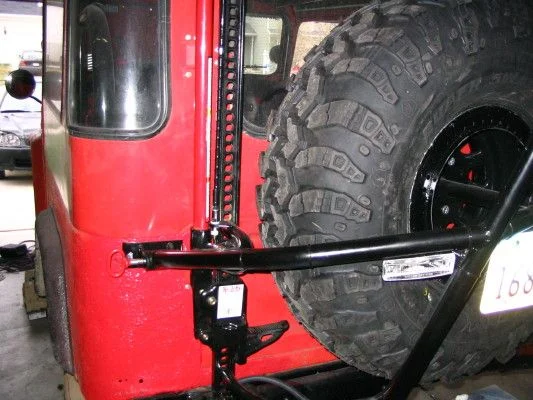

got some updated photos
got all the wiring (license plate, back up, cb) done
cleaned up and ready to rock. just gotta get the hi lift on her and it done.
Looks great broski. The lights will be real handy and add a nice touch.
One question: did you design it to cradle the tire itself? As in-does the tire contact the hoop to provide the support of it's weight or does that one tube that it will be mounted to support all the weight?
thanks dogg,
no just that one tube will hold it. it is gusseted and i hung on it and bounced, dont think my tire will weigh over 165 lbs. of it breaks i can fix it and make it stronger. we'll find out in a few weeks, my 6 knuckle 4x4lab arms will be here.

maybe not but if i hit a rock on the corner those lights ar toast, the stinger doesnt protect the whole rear end.

shes all buttoned up and done
Well Done. Nice and Clean, the way it should be.
here she is out on the trail
the bumper is tough, after going over this rock all the weight slammed on the tail light protector and it put a little scrape on it and thats it, weel pleased with the overall end result
