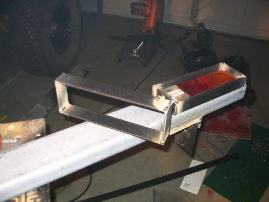

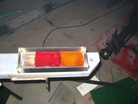

cut out light holes and welded on brackets
then i made some light guards ( i tend to back into things)

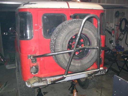

now was the time to figure what tire rack i was going to go with, itred of the spare laying in the back seat, so i went wit this design with a few tweaks
so i broke out the welder and some steel and here it goes
first i patched the holes, then got to work

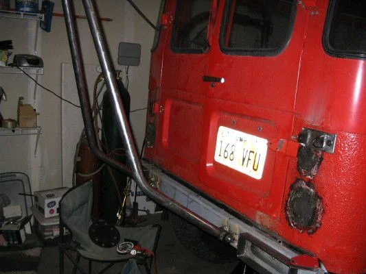

made a mount to the tub ( dont worry its geting tied in to the roll cage so it wont be prone to failure or bending the tub up
and hres where im at today, wont get to work on it till saturday, but its coming along, got a 60 inch hi lift yesterday ill slap on and some back up lights
just got to finish burning some welds and add the peice that holds the tire on. expect more to come in the next few days.
what think ye??
oh yes i made this to accomidate 38 inches of rubber, next on my list !!
how exactly does the wheel stay in there? how does it mount to the actual rack?
almost looks like a gravity setup.
i will incorporate giant magnets on top and bottm and using the forces of the pos. and negativity action caused by this, it will hover with no srings attached
much like modern day rollercoasters, sweet huh
no, right now its just held up by a strap, to center the tubes and find where to weld the brackets in. i have a tube and a disc with lugs thatl be burned in tomorrow.

i was going with b) but with 4 bolts
but now you got the wheel tuning? hmmm. i think 4 bolt might be best due to lack af space betweebn tire and doors. just hang tight ill get to work. its turning out better than i hoped,
