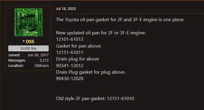

New updated oil pan:
12101-61013
Gasket for pan above:
12151-61011
Drain plug for above
90341-12012
Drain Plug gasket for plug above.
90430-12028
Old style pan gasket: 12151-61010
