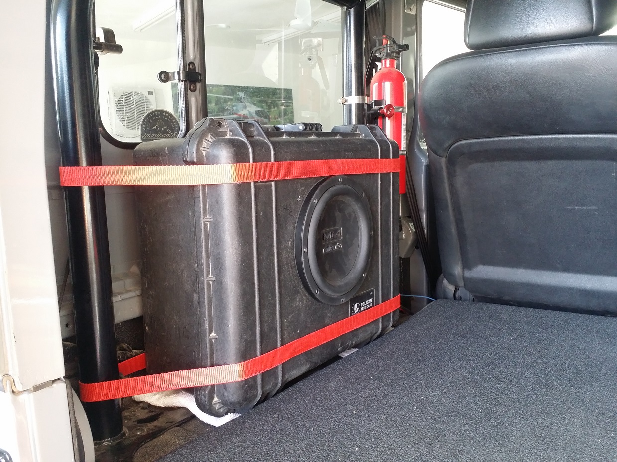

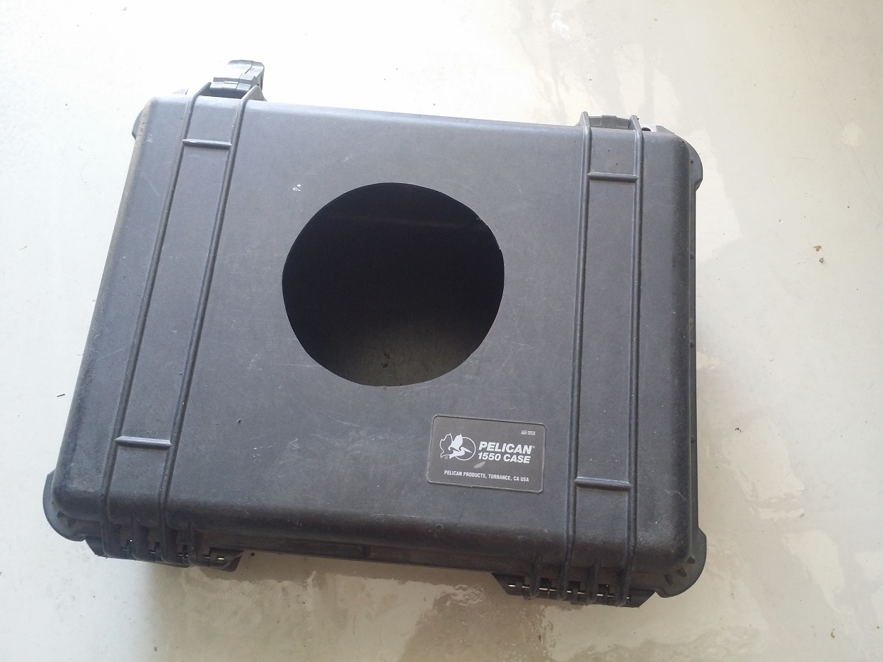

I have had a Polk 8" sub for a while that matches the rest of my speakers, but I haven't installed it yet because I couldn't find a place to put it that I really liked. I decided to get a matching Pelican case to make a 'box' for it. It now contains my 8" sub and Polk amp, so I can remove them in about 5 seconds.

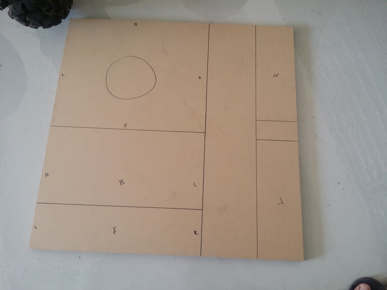

Marking cuts on 3/4" MDF. The Pelican case is not tight enough or the right dimensions to work as a box itself, so there is an actual box inside of it as well.
Sub and amp in and sound great!
Nice use of the pelican box! A bandpass box would've made it totally stealth with the port facing forwards on the side of the box. Or even facing backwards towards the side of the cruiser. The configuration below would need to be slightly tweaked for the depth of the box but doable. Since you have that cool trailer you don't have to worry about gear but might be a good idea to throw a grill on that subwoofer to protect it.
Do you have a simple 12V plug for power to the amp?
