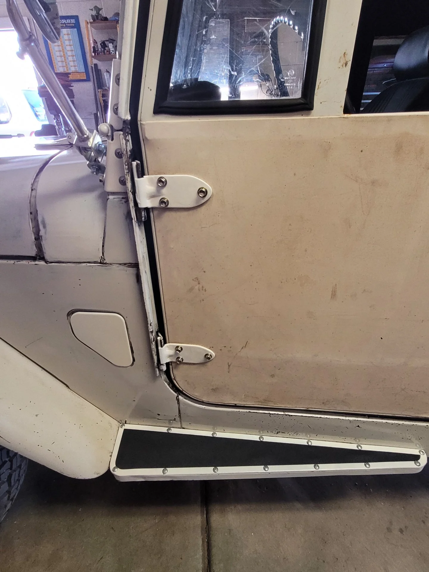

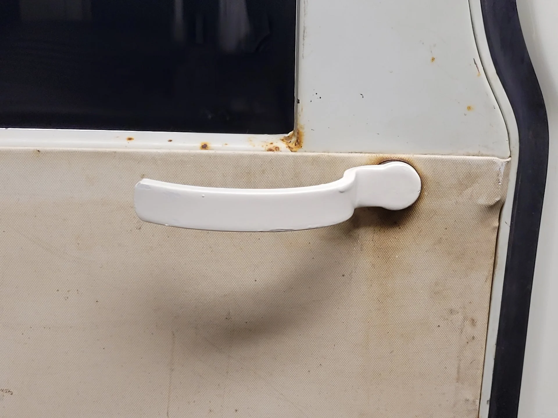

Fitted the doors with the correct hinges. They fit pretty good. I need to pull the handles off for a clean and repaint though. Will probably pull the doors back off so I don't melt driving this thing around.

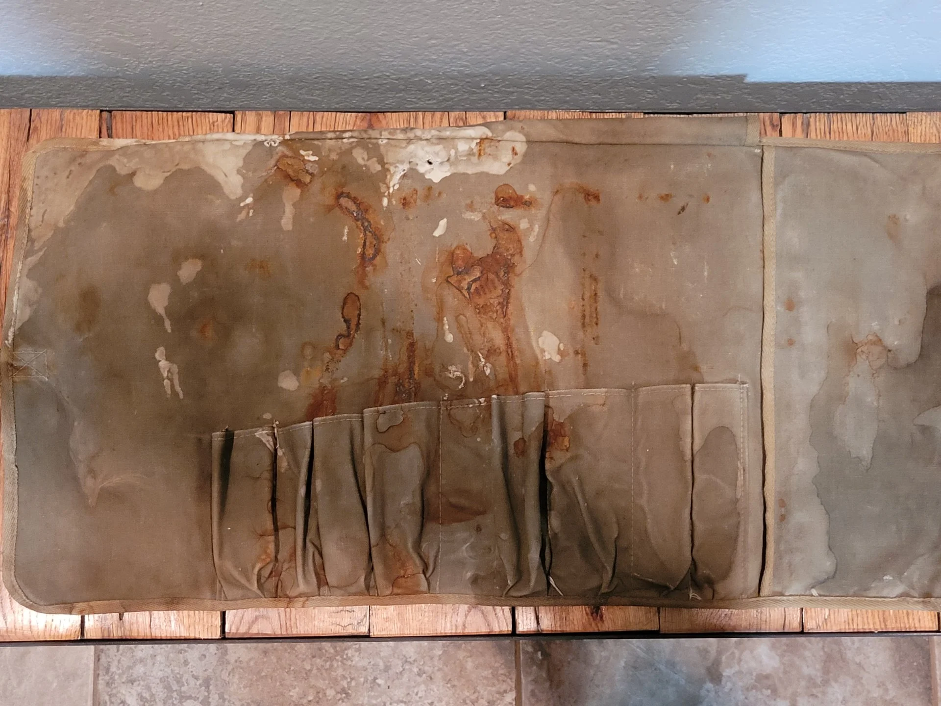

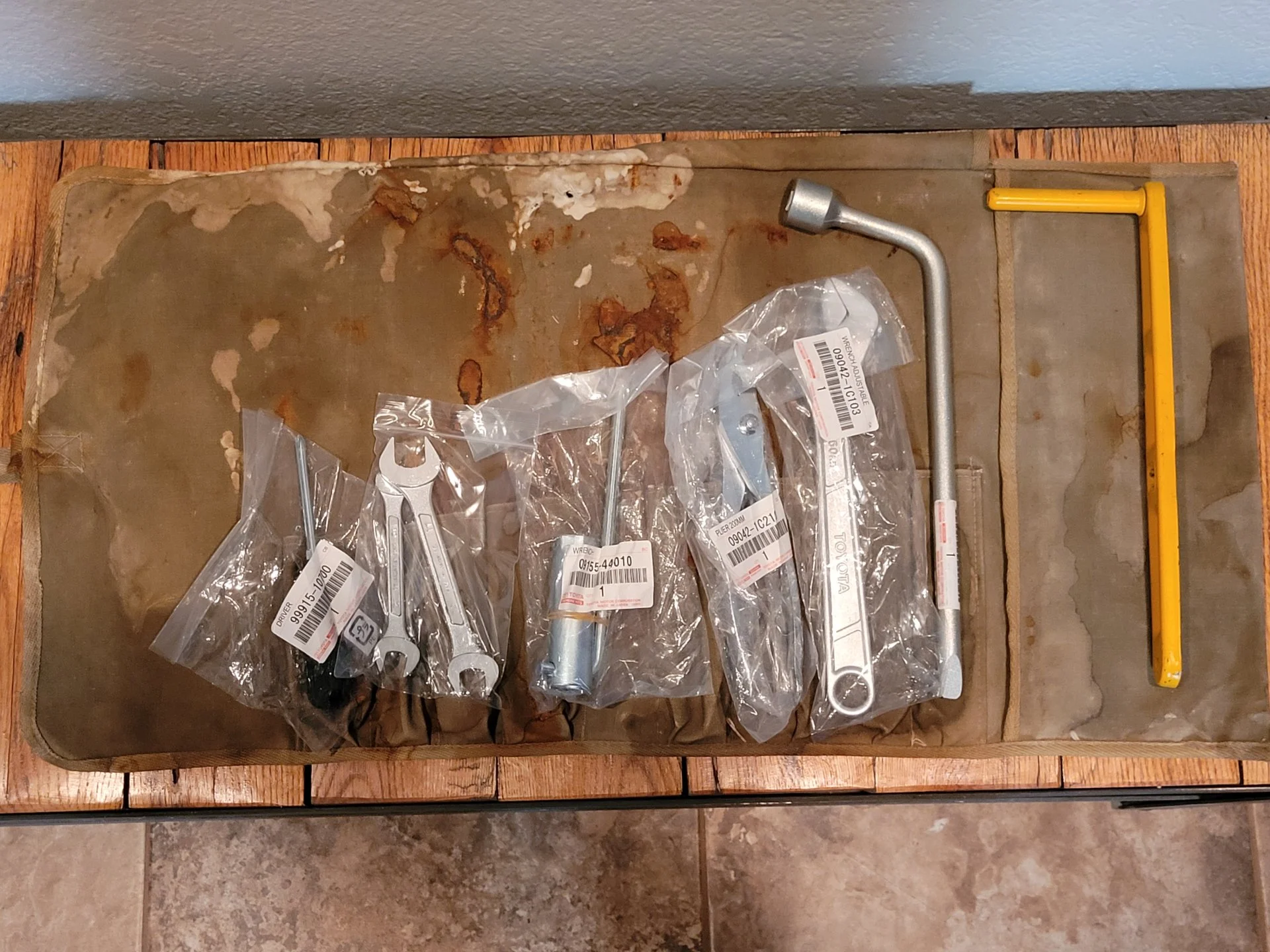

Putting together a tool kit. I got this beat up tool roll years ago. I am gonna try to remove the rust staining with some vinegar. I almost used some CLR, but it says do not use on fabric.
Most of the tools I got are not the correct vintage, but close enough.

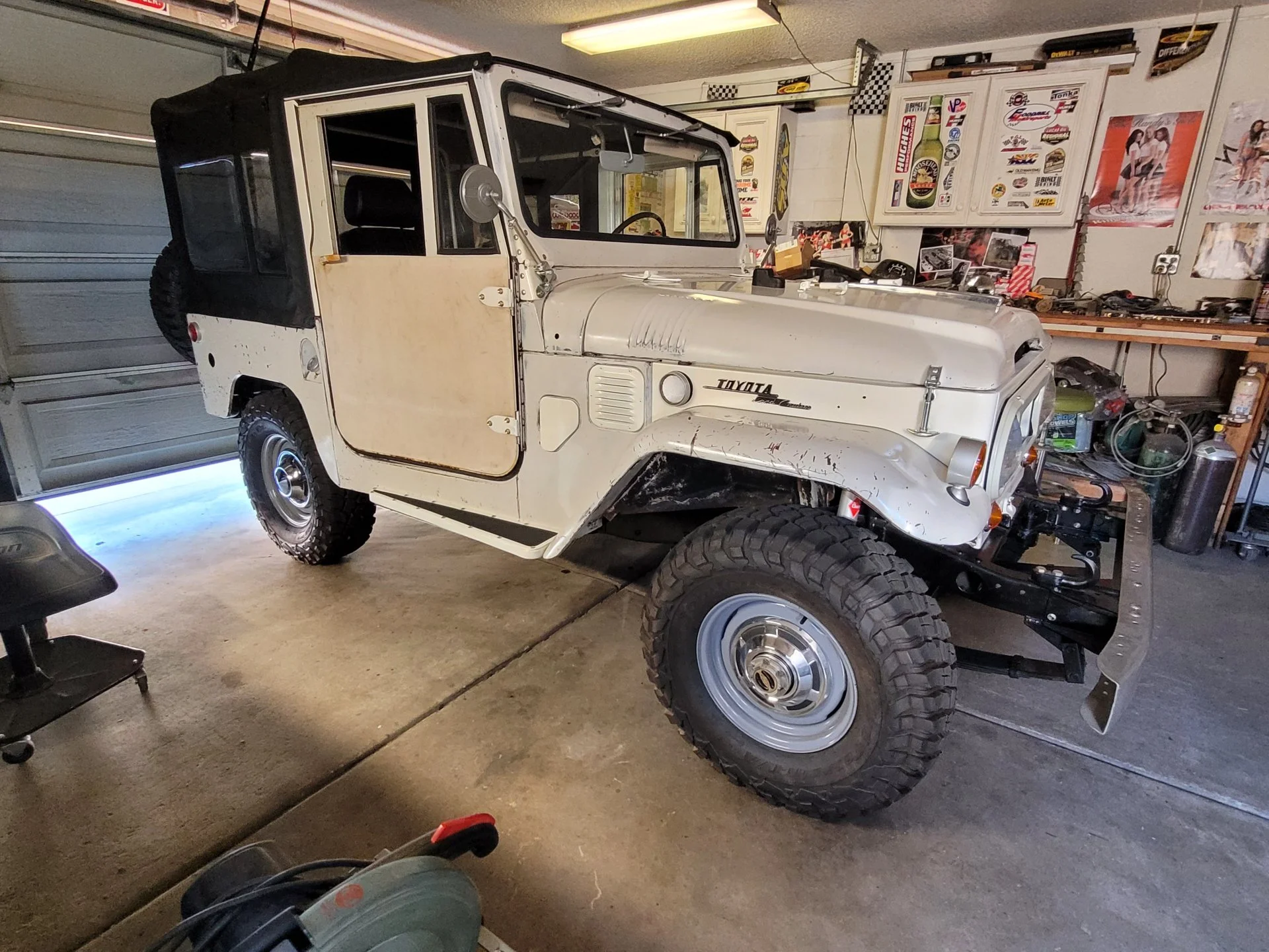

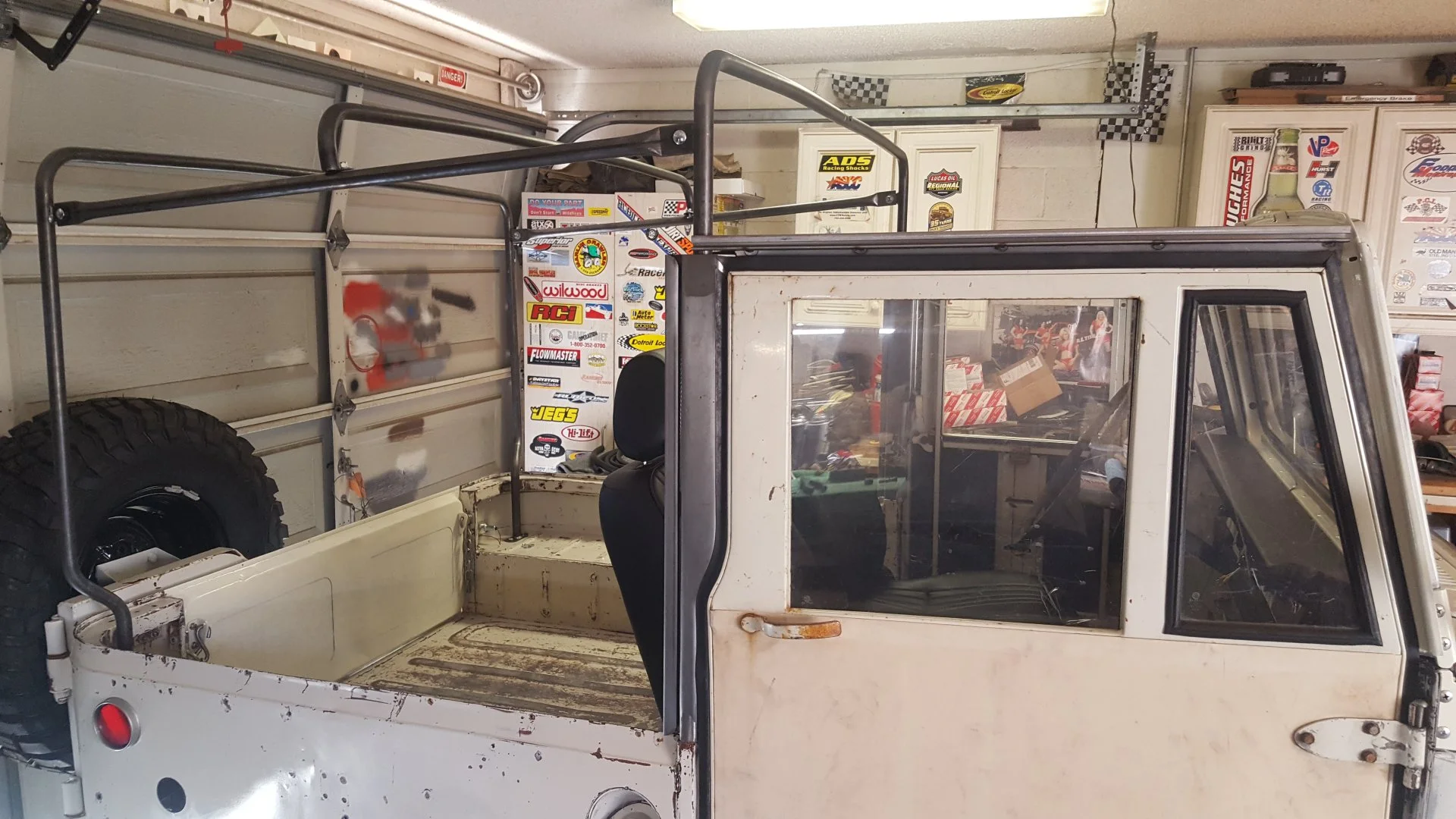

My repop soft top bows showed up today. I installed them and the doors as soon as I got home. It seems decent so far, but needs some adjusting. The b pillar is way too high. The legs need to be shorter as they are bottoming out in the tub. I love cutting up new parts......lol

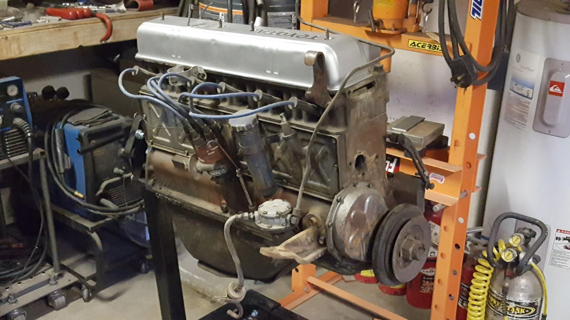

Spent most the day rearranging heavy stuff in the side yard. Got the "new" donor motor on the stand and ready to work on. Need to get the rest of the drive train sorted, cleaned, painted and resealed. Let the motor fun begin.
