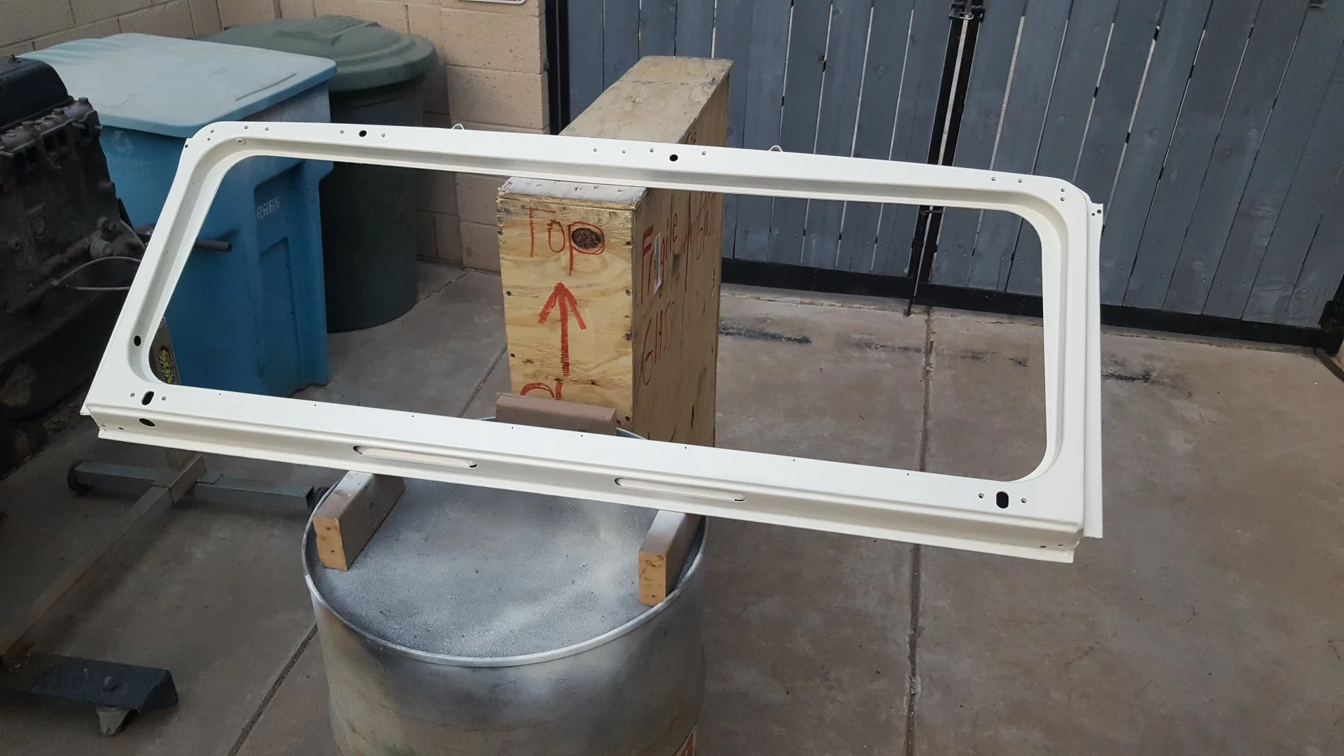

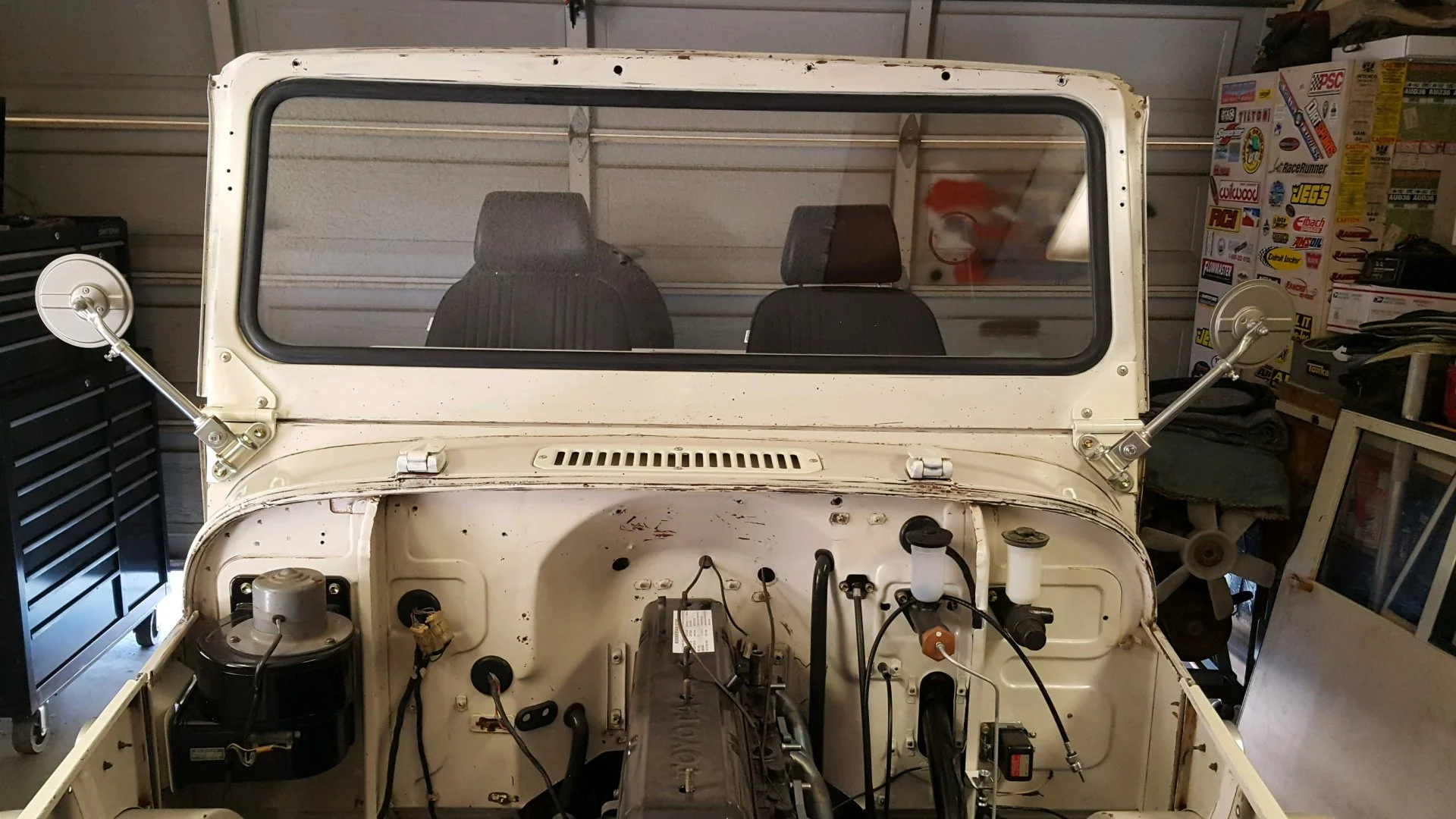

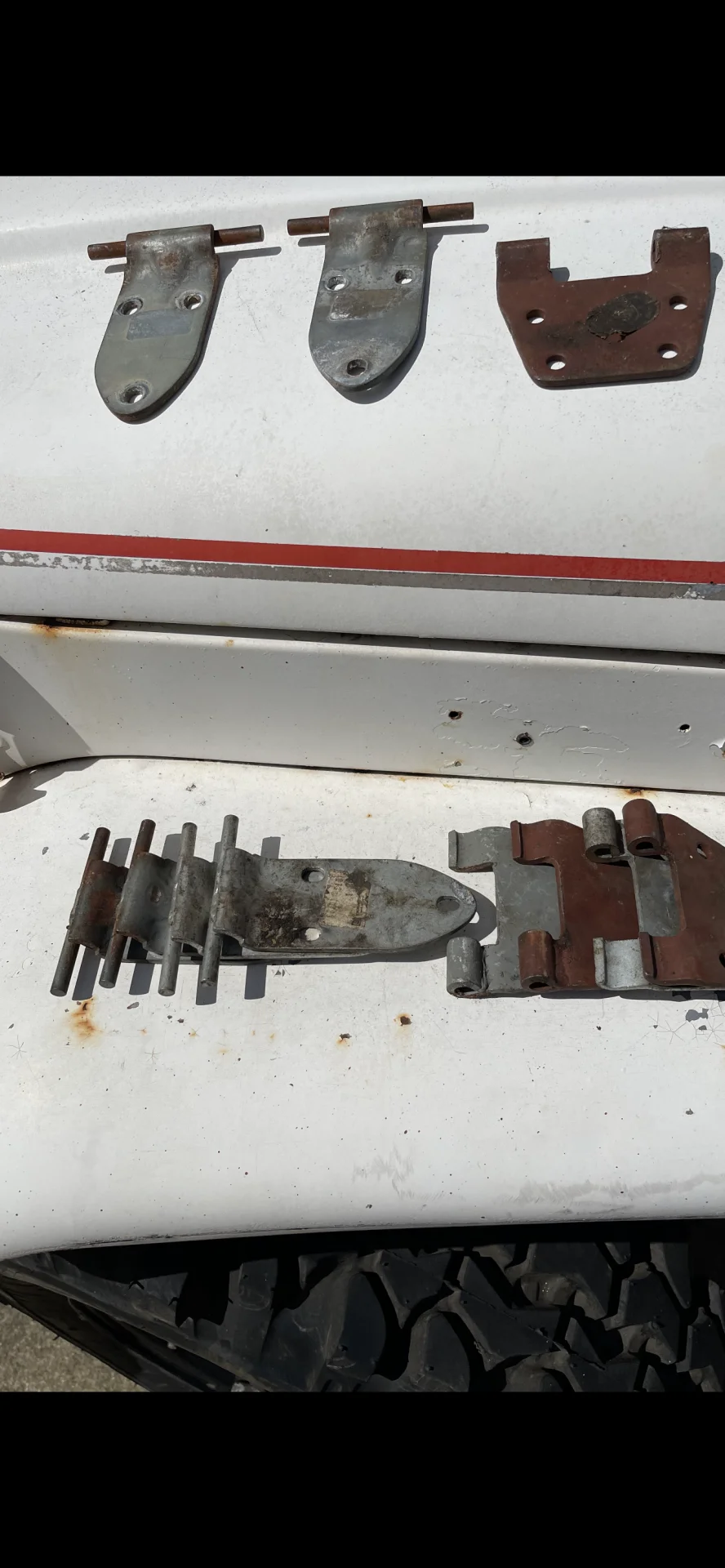

These are correct hinges, all ZI have now are the 2 upper door side hinges. Also the early trucks had the windshield strip welded on from the factory.
Thanks for the info. I have the correct body side half. I am getting another set of FST doors and they have the correct hinges. So I should be good.
Would my top channel pieces be considered the same style as factory or more of the Tiger / aftermarket channel ?
I could use that after market channel you have pictured, both parts. If you replace with OEM please let me know.
Have both 67 and 69 soft top bows including the windshield strip. The 67 strip is shaped like the earlier welded on strips but bolts on. 69 has the later shape that forms an almost complete square. Without a parts books from that era would have to assume 68 is the same as the 69. Have run both the 69 and a 73 strips on my 68.
