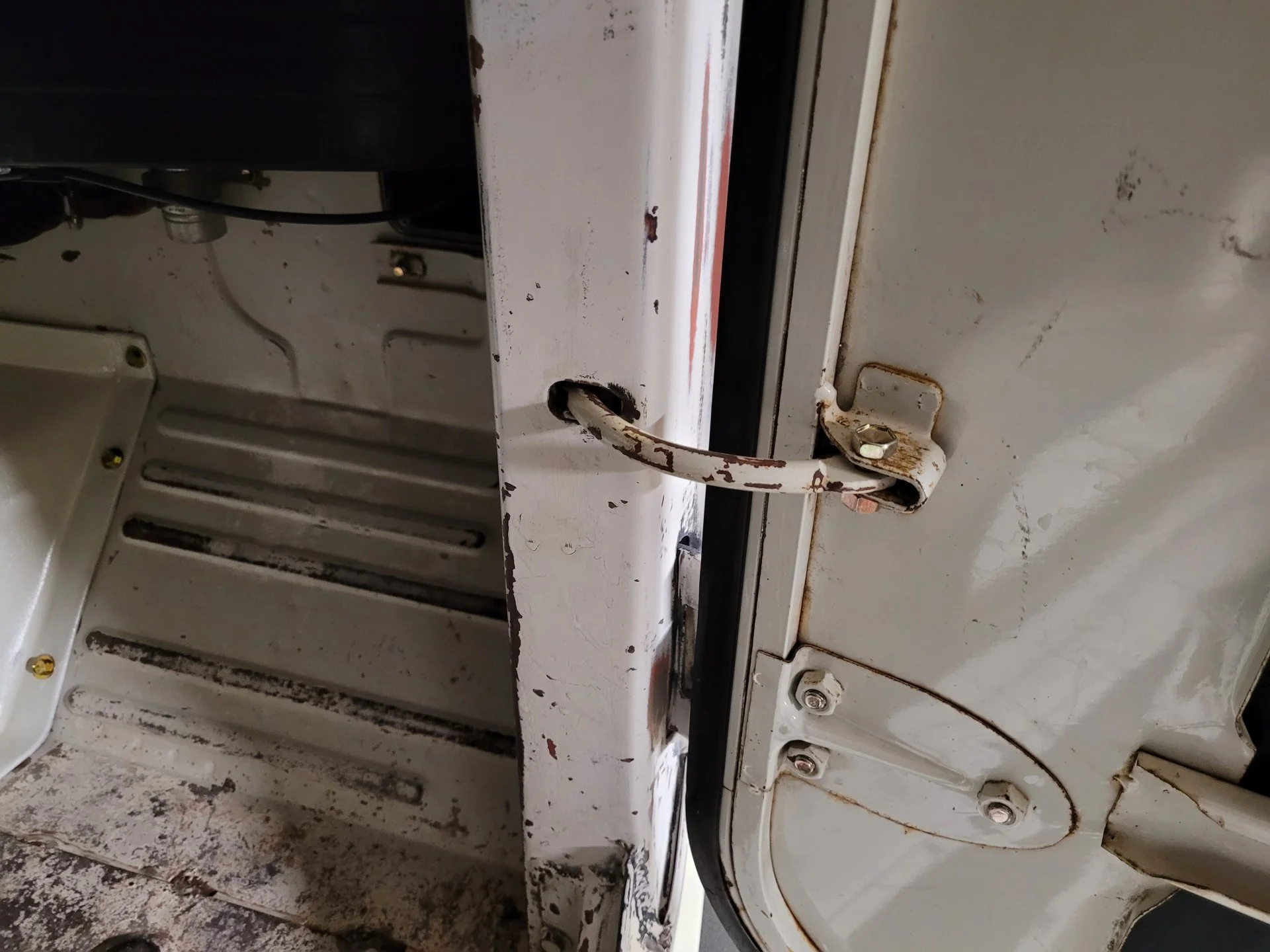

In the meantime, I installed the door stops. It's nice to get original paint, worn, that matches this build. Thanks @77HesterSue
