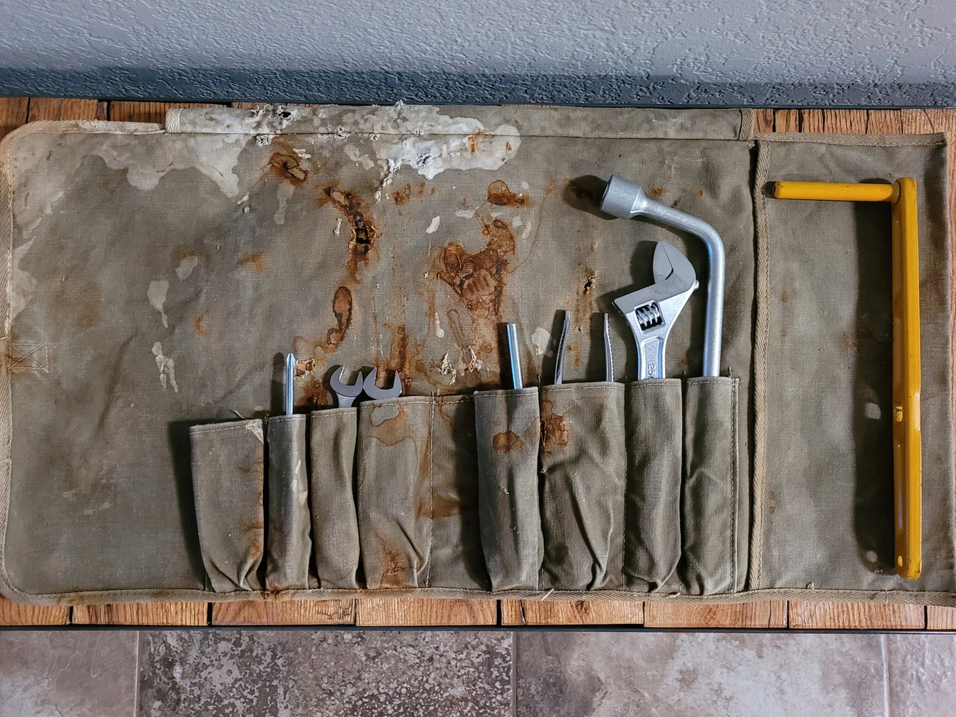

Despite my vinegar soak, the rust on the roll remains. I did wash it afterwards, so now it smells good. Filled it with tools and placed it in the tool box.
I have some of the Zep made CLR type stuff. It says do not use on fabric. Not sure on Evapo Rust, but I don't plan to mess with it anymore. Thanks for the suggestion though.

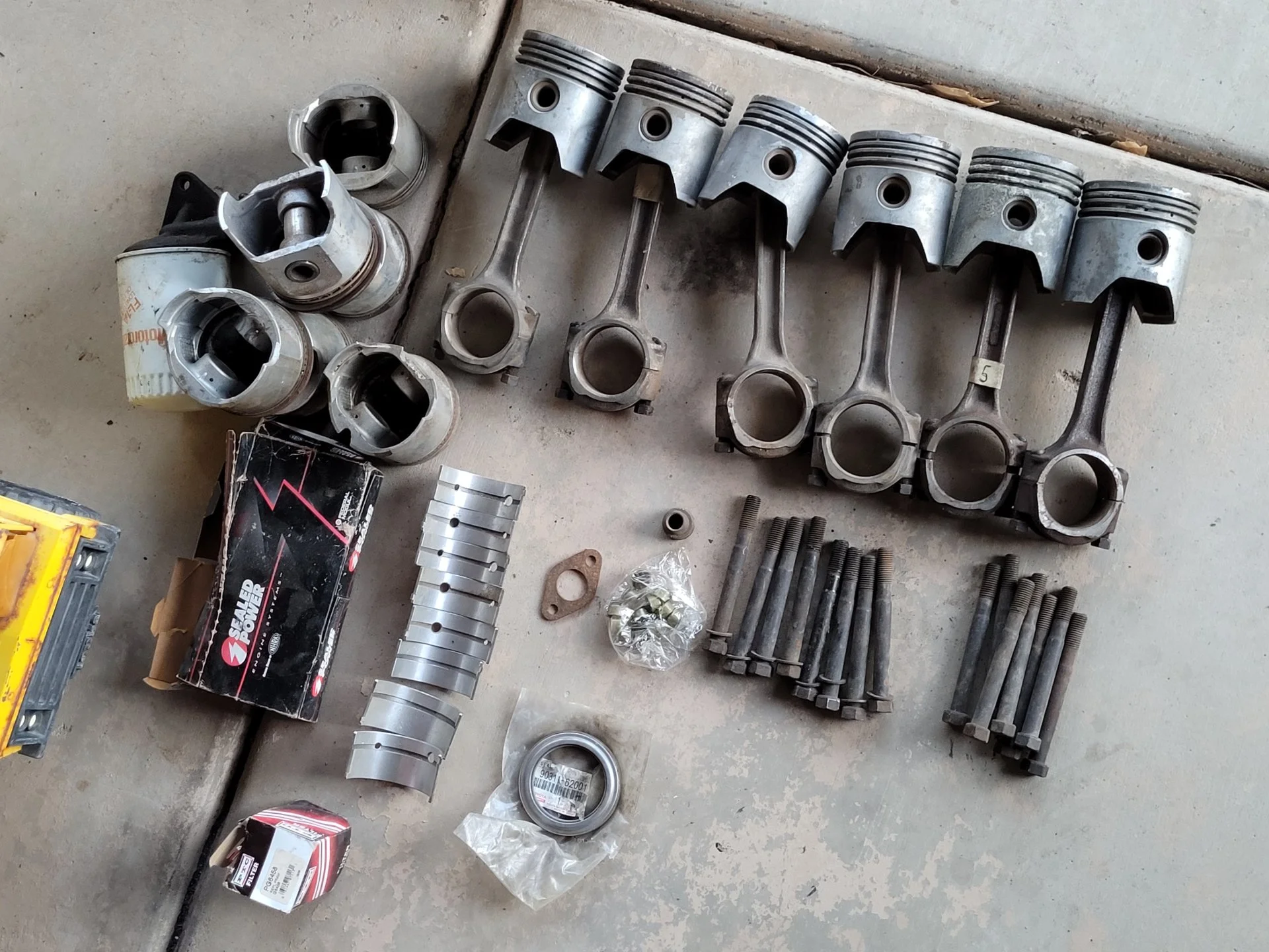

Dont throw another used 50 year old motor in it, just rebuild it, not hard or expensive
Define not expensive. I've seen many many members state having over $5k in to a properly rebuilt F / 2F. The days of $1k rebuilds are long gone :(
Having just rebuilt a 2F - it took months to get the right bearings for the crank - the supply chain sucks - I am North of 6.5K - seen rebuilt ones on the net about 2 weeks ago for 8K
I know the supply chain sucks but think it's also the age of these engines that complicates things. Did everything except hone the cylinders to my 68 F145 in 1980. Spun a rod bearing in low range. Besides turning down all the journals had the crank straightened. The cylinder head was done. Did the assembly myself with the help of a neighbor. Neighbor was a mechanic with his own shop but crankshaft and head were farmed out. Borrowed a engine hoist and did the work in my garage. At that time believe only had about $300 into the rebuild. $6.5K for a tractor engine just seems crazy to me. Thinking Jack does not intend on paying that much. If did would had done a complete restore including body work and new paint. Not sure what Jack has into this one but if it's like me probably less than the $6.5K. Last engine I bought was a 3FE that has all the accessories, engine wiring harness and ECU for $200. Running engine that was replaced with a V8 for more horse power. Didn't need the engine but I do have an FJ62 and may need it some day. Not sure what project Jack has in mind for his 2F but guessing the 2F would go into this one and he will shop around for another cheap 2F.
Thanks for the better explanation. Honestly I am not against getting the motor rebuilt. I just keep hearing about back logs and long wait times.
Like I stated above......I have a small collection of F motors and I would love to save them verses scrap them.

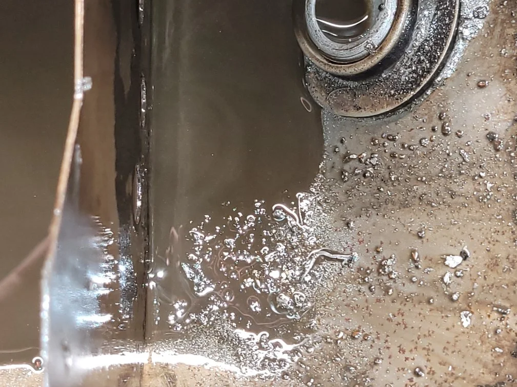

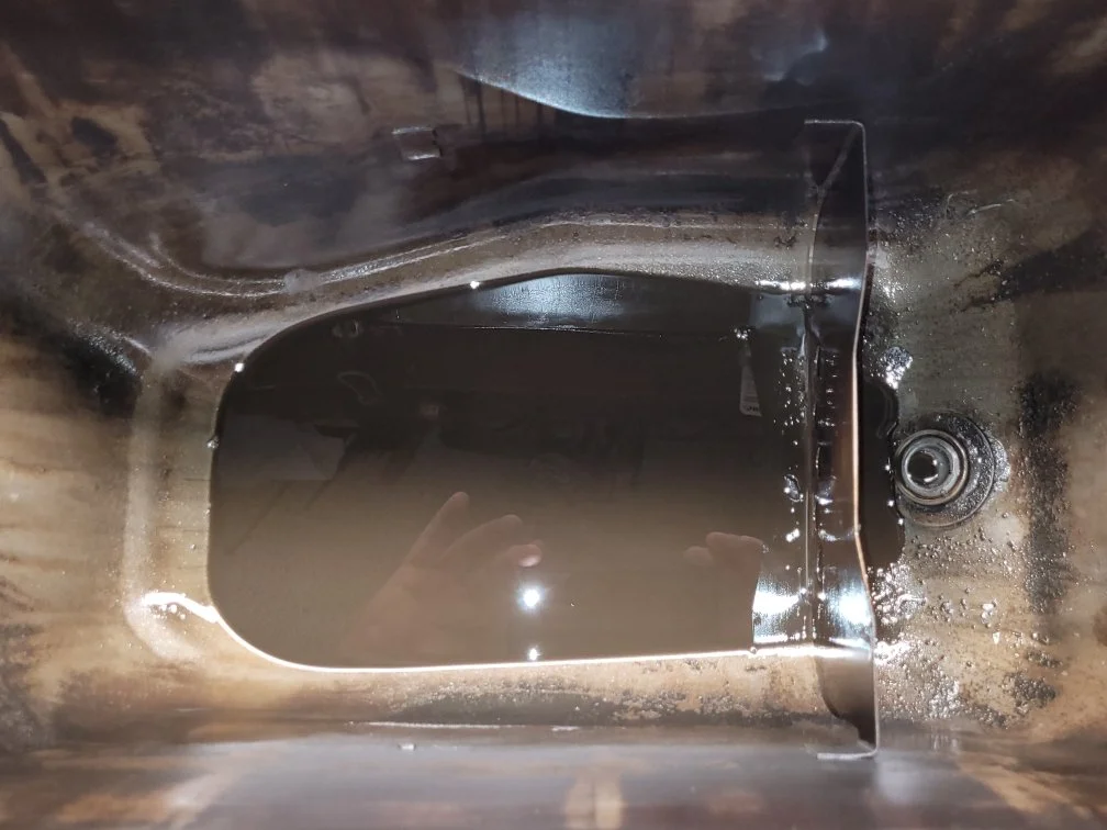

So.....I have another mystery motor to use. The plan will to rig it up so I can do a compression test. Visually, it looks good and the internals are super clean. I can tell it has been rebuilt or at least completely apart at some point. I will pull the oil pan and check that stuff too. I might even borrow an engine run stand and really test it. Once deemed good I will clean, reseal, and paint.
I am also researching local rebuild options.
