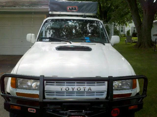

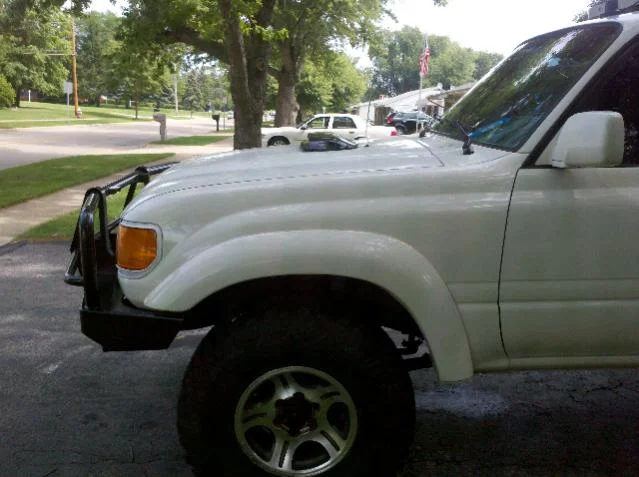

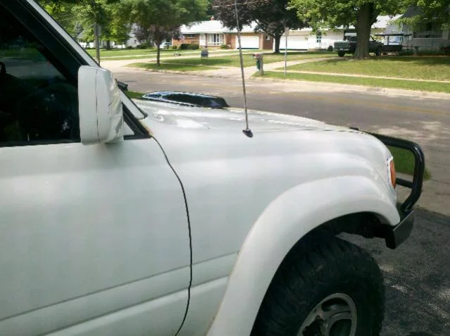

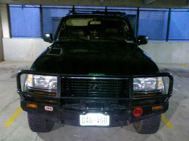

Hung out with DR GIL today to FINALLY finished my tailgate lid install. Figured that was a good time to see how cutting the sheet metal was going to be on the LX. It wasn't as smooth as I had hoped but I was more confident.
So my vents haven't arrived yet but Gil was awesome and gave me his set until my set finally came.
Couple of measurements. Some blue tape and a laser guided eye ball. My good arm is a precision instrument :flipoff2:
Eyeballed the holes, center punched them all and drilled. Each one landed spot on. We were both floored :D
So one side done and the other side for another day.
Now when I got home I had a nasty surprise waiting. The wifey was PISSED. Turns out I only "mentioned" adding vents was a good idea. I failed to mention I was GOING to carve up her hood. :(
Couple that with the fact that it's unpainted, it's held on with blue tape AND it's only one side :P
So now I need to hurry up and finish. :)

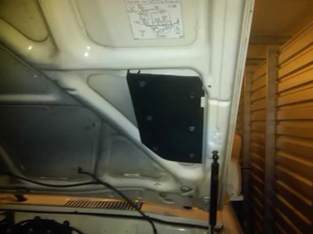

Do you mean like this? I don't run with these on but modded them up while doing the install.
I would guess that they would be handy in an extremely wet & cold environment.
Pretty happy. Although we only installed the vent on the passenger side I can notice a huge difference.
Wife and I driving right now to Vegas and coming up to Baker. It's 107 outside.
IA reads 107 and WT is at 193.
Typically we would be in the 140s for the IA temps and between 205 and 210 on the WT.
Huge win here.

Update: sitting in bumper to bumper traffic in las Vegas on the freeway.
IA rocketed to 150 (not enough airflow). WT is 195.
Just started moving to 40mph.
IA plummeted to 132 and 190 on the WT.
Movement (airflow) is everything.
Edit: my wife actually said she was sorry for yelling at me for the vent. She loves the addition now. I WIN!!!

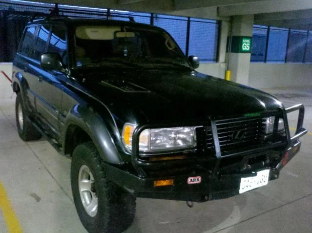

Nice pics and write ups. Here's a pic of my lumina vent I did a few yrs ago. Haven't decided if u want to do the ds side, but the ps definitely dumps a significant amt of heat that would normally be trapped. Probably helps out the SC as I haven't had any overheating. We'll see if I need any more interventions when I move to Tucson this may.
A couple more. I had been considering this wrx scoop along with an intercooler for the 97, but I think I might be better off with an air to water I/C so I don't know if ill end up using it.
That WRX scoop looks good. I have one waiting to go on with an IC.
DONE !! I took me a while to find the louvers, but it was worth it.
They look perfect, it is almost like they were made for the 80. They fit perfectly with the body lines, and also when the hole is cut it does not disturb the hood bracing.
As far as performance I don't have a lot to report, but I am going to Houston today and I am eager to see the performance at high speeds which is when I see my temps go up.
THANKS Rob for the template ! that thing is stupid proof !
