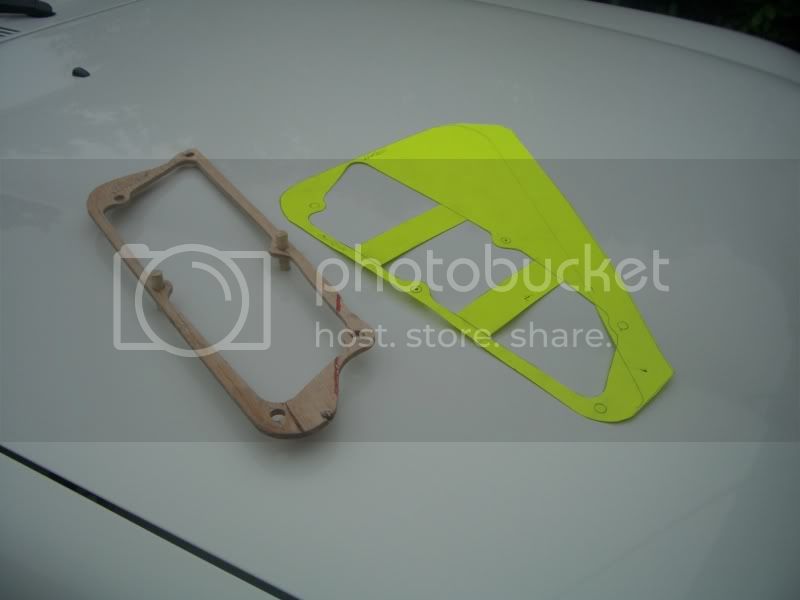

The template and marking guide that I made (just flip them over to do "the other side)

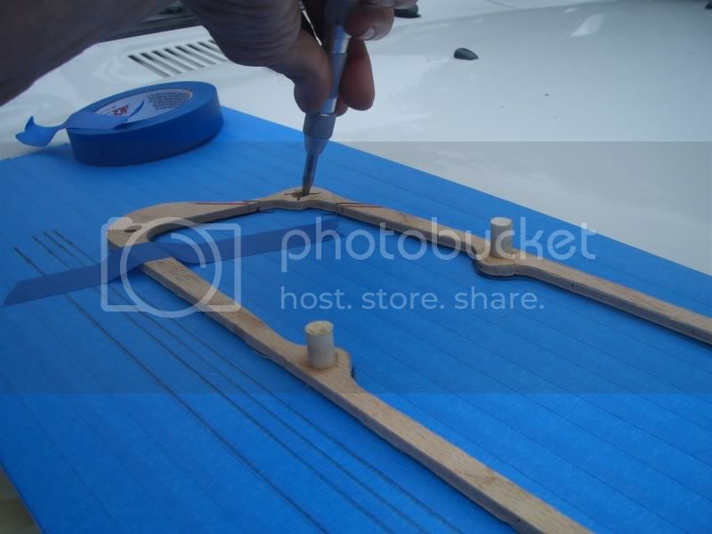

Center punching the holes so my drill doesn't wander all over the hood!

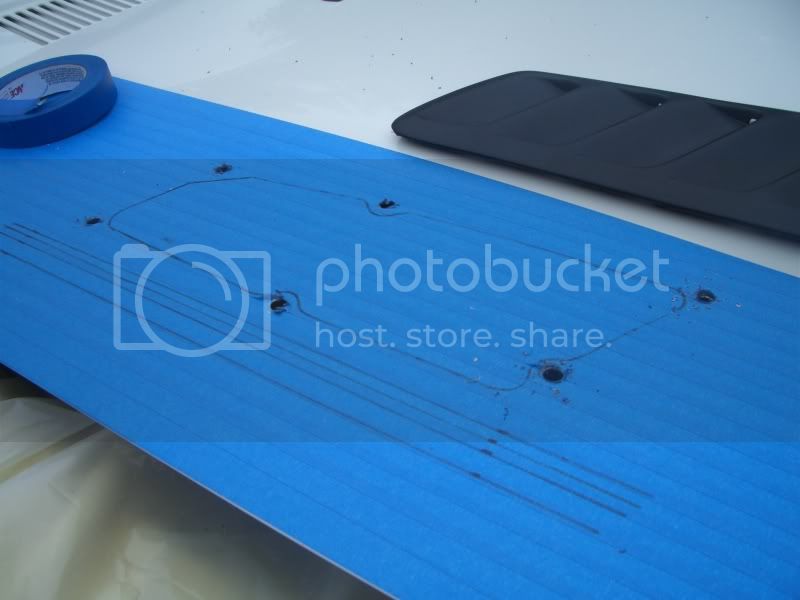

I marked and drilled thte other four holes for the vent louver "pins" before I started sawing the hole.
All six 3/8" holes drilled. Ready to start sawing!

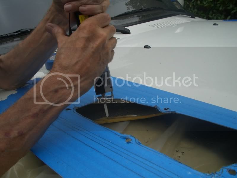

Sawing the hole. I used the same super-cheap air saw that SUMMIT CRIUISERS did (Harbor Freight, just over twenty bucks!)
'Bout done!

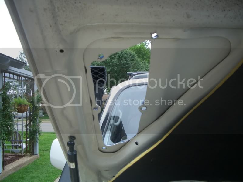

The hole from the inside
Cleaning around the hole with alcohol. I used 3M "VHB" tape (3M 4949) to hold the vent louvers in place
Pressing the vent louver in place
Repeated all that stuff for the other side... here's a look at the completed project
