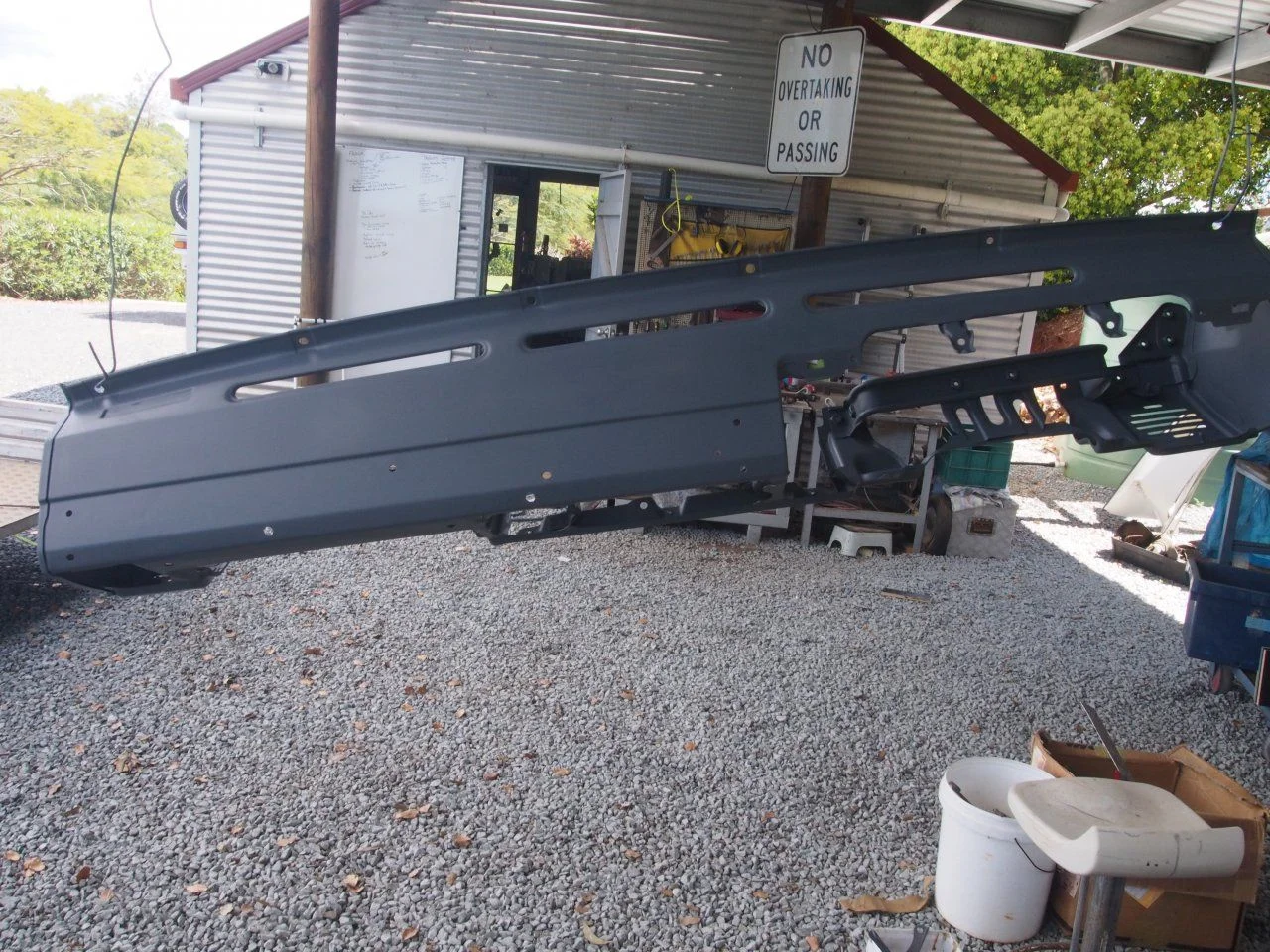

Found an OEM Dash Pod from Toyota ....
JUL9XHIuJcr5XpO6ex8shdNJHA8I6B46SabwoCEqqfoDVm1uFKTZn_nUDkd1R-SH2TV9FTp6GbQ-r-HxJrCLlVnGPxO6qaArB-xLQ3cwqfhu12WP4FDVKrelv0rNaEX0AGfaVU4fpHp3q5YLfwn7h98VCKXs23SeThyhHUdz4xztvwLSNoifPxRFcYVl3JITPr7Aq9QwXfBT2qCXlt0blIBbxfLu9DLdERg9OGaASHjvfai1xIUghGlq-VJTeY5RoNKCZPuuFnc-xmL0DBo4ssh8RUekW4skscL6Hw8FTQwwN0g49zxPS1cEBz2nxnRLOs2Y9M7qFc-4KooSPFJMCzTB-CQb4thLSKrwGWw7l2npvVoP8nxOXHKgjJZxvzCS5gLv8_xNbo6dcRDyVQG0PxdcrYgODfGeEMENl3FAGgczcDDmShNZIll70fygzfKTOUSRhGkqRZsbafmGjhKVgIiIIAdMrwKmu-DeRxl1V6ebuqpKSQKPjaVYFxY8yJzIREd1ZRgzMuw7lxzBQTNjxvdyXNhH5Fd9ID2HLY9moza5HNVoh0Q-7mwemVRyVdLlT7pGVq1UXoGYLS_bXuJLDBZMO_G-dJM0TWOWY-SCjJvuLCPH=w453-h805-no
BuGBREWg5U-owV2lzeLGS8s5vBkkfQHZ2Lnxx28P9KUhJBpm4ADwoWpq9OTHHdfwh-GlFwUZc9vyaNa-1hN-2Bu_W5bJenqllsP4triquqBdLc8Out5v1AsdYtUmShF_hPrfOef5ZeknHI3yGyBT_0HJpedVBoIgWCJWbhY02K0nmsV_3Hkw-DbY1GVP4GZeFAuSfQRL8iXmiwSCgXF3rJhfDDYey0zk7twq1fqQ_AgiACCtuyD-q2nrFWFKZjHeNOaI52JhDNC1tBAHfzu14iXivgC6YtlVTjpZUbKwZ1wlDcfDatYb2OuU_HX2E87jS3fUgRlvwIWRYMHCPlV6spzcahKEDGfqPoGlbW5Mio7aNwDJ9cNWz3tSOzkynJIyaIeIJyMCU4oEehvjEnTMLoDgn2XjwHBk9ra0WqB-ZmHv9V4nAh7YEuM8OKg70LDVIhiJRb8DzwQS_7m5YpfLGdnRWmy6tmTmc_ppiVZ9wiZAEmQWeUiMSJoCcXn7NuUcHXAeQ_Gfw0dKk4HM6NJ8F7KGLjmW8GY9KpBTEA9r0VSRwZhjD0uGczbVYyGyaqfndlciGJZIgjWrqCQzWCDcoCRiV91xBb0uCTnyv8tfbyLLzOiy=w453-h805-no
now to take a drill to my perfect dash :rolleyes:
How do I remove the dash itself after undoing those 6 screws in the front ?
do you mean the dash pad?
Yes the dash pad, sorry mate.I saw that there are the 6 screws holding the "frame" and another 4 holding the radio bracket/box thingy but I have not opened it up yet and was wondering if there is some trick to it as I cannot see any screws holding the pad ?
There are 10mm nuts on the underside, if I can remember, or it is held in by clips, it's been a while since I had one off.
Yup, your right mate. some nuts and some clips. I just did this. The 3 back holes are push in clips, better if you squeeze them from underneath if you can.
EDIT: you will need to remove the glove box and vent cover i think to get at nuts.
