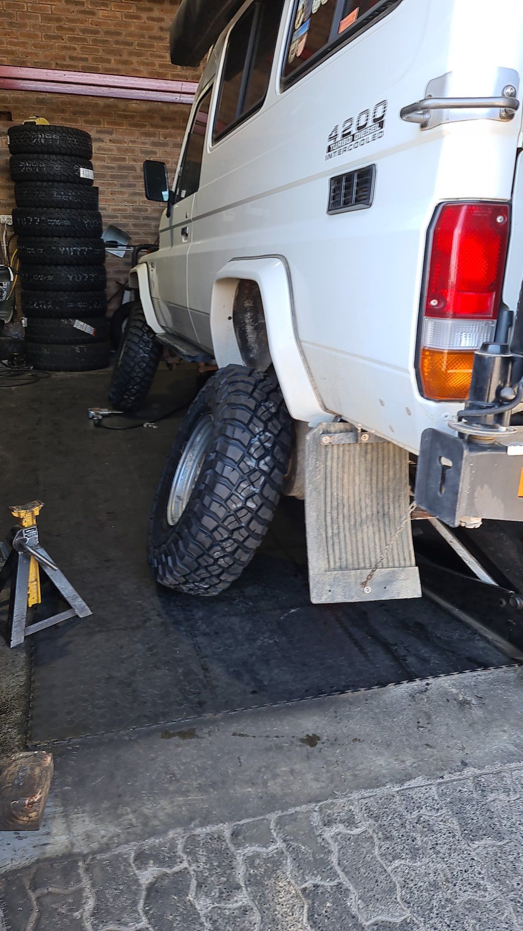

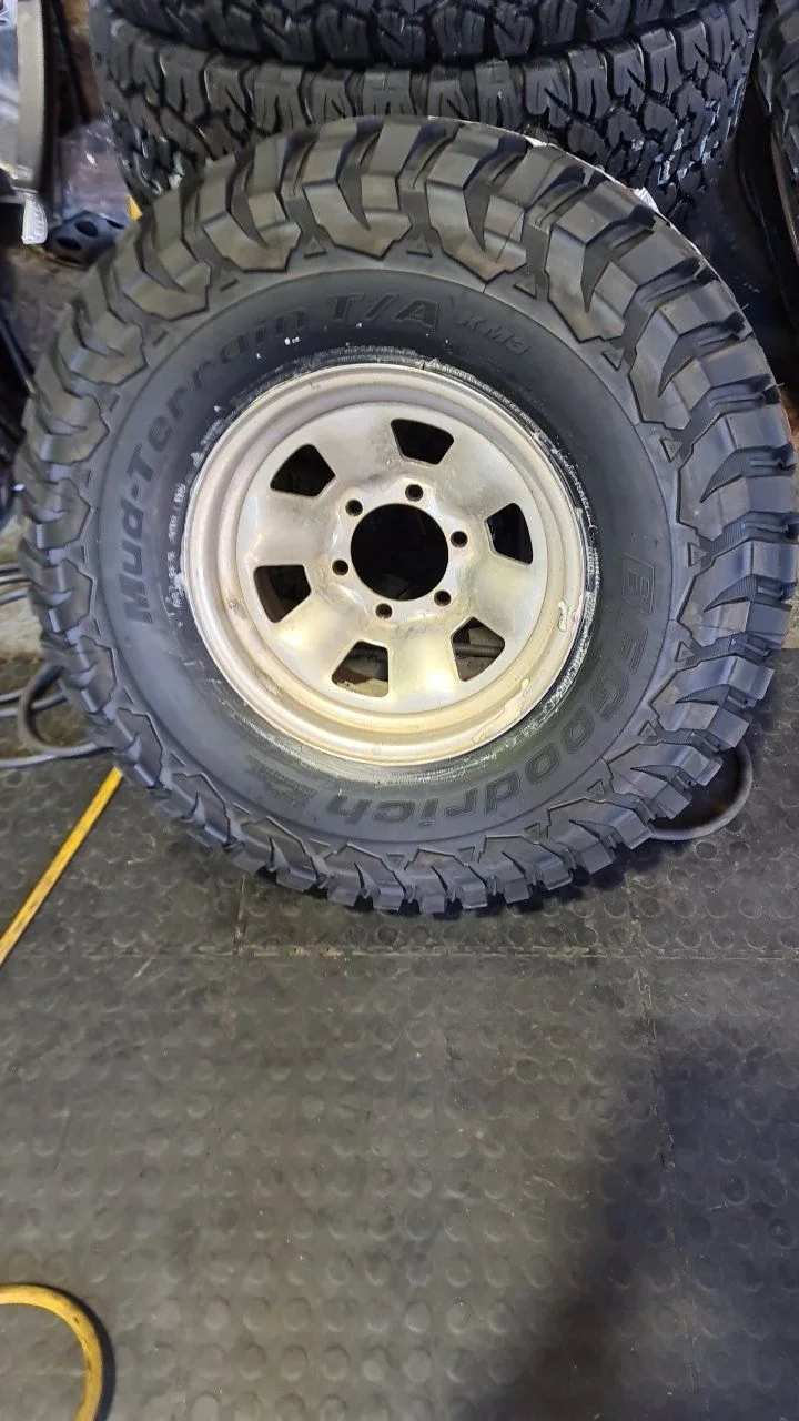

BFG just replaced my KM2 tyres for the new KM3 tyres due to some cracking - great service from a Co that stands by their product.

And thanks to a very good old friend, she now runs on OEM 16 " 80 series steelies too.

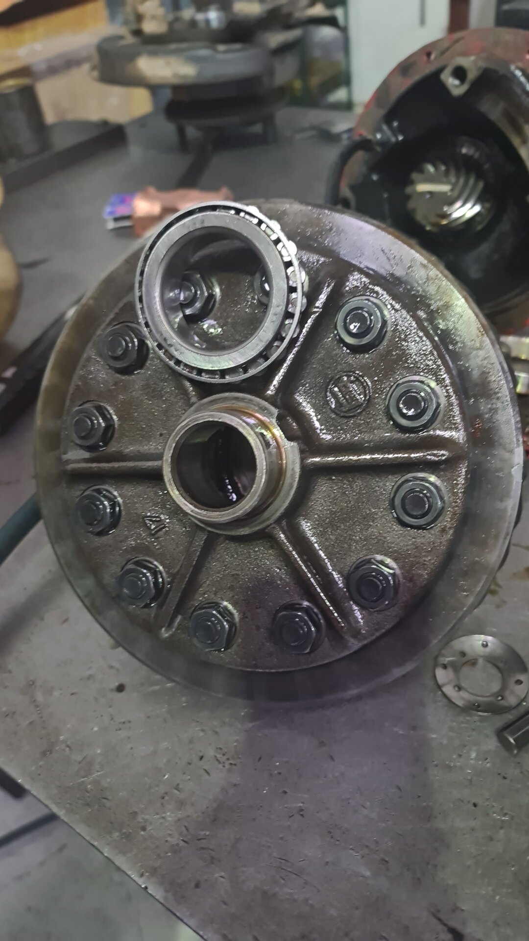

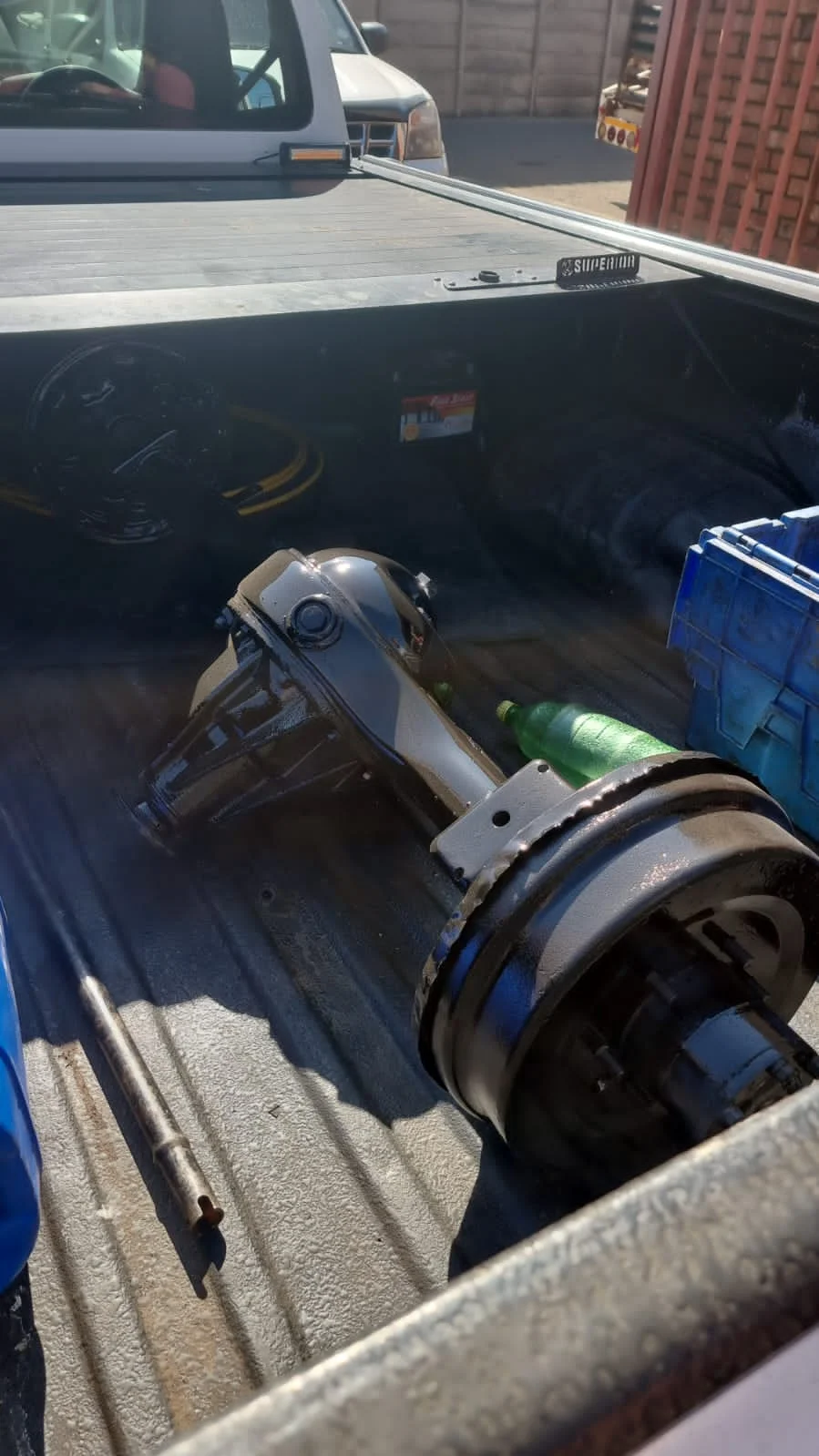

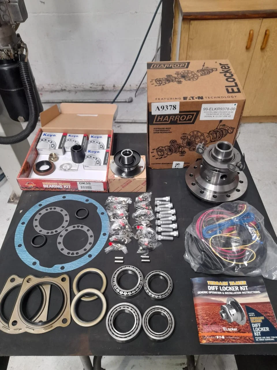

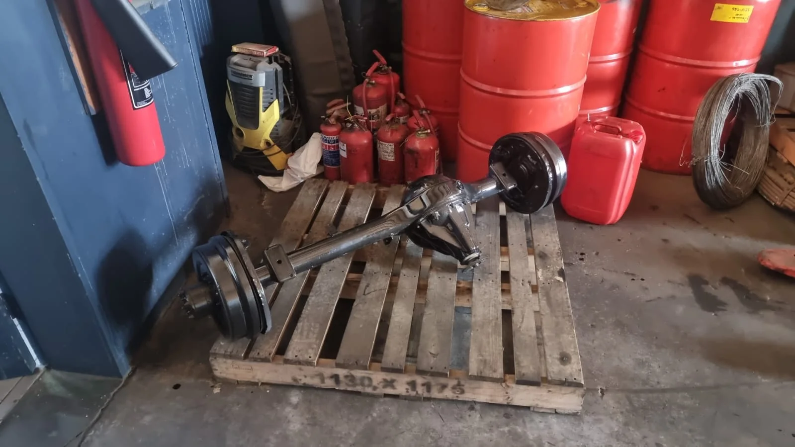

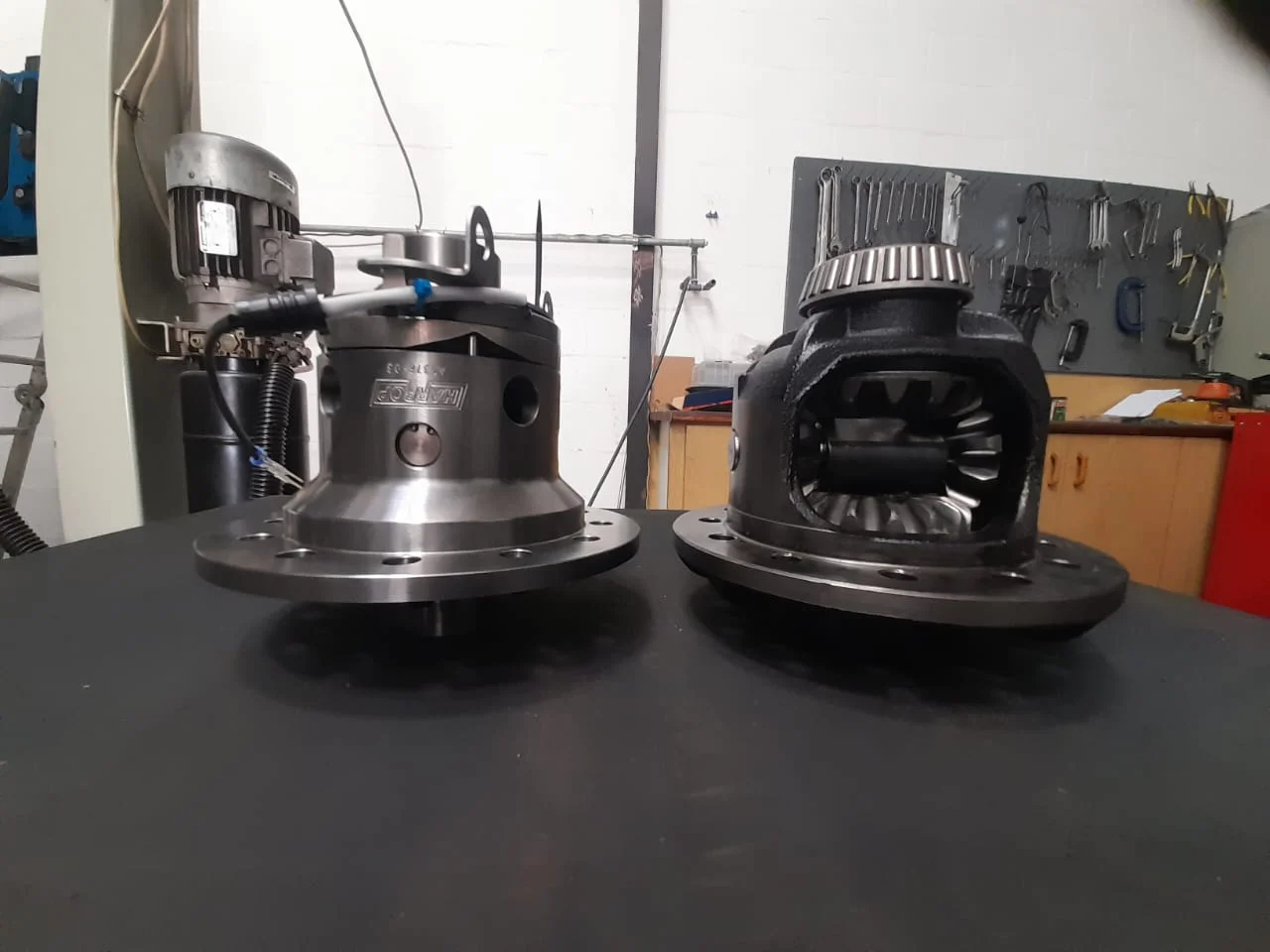

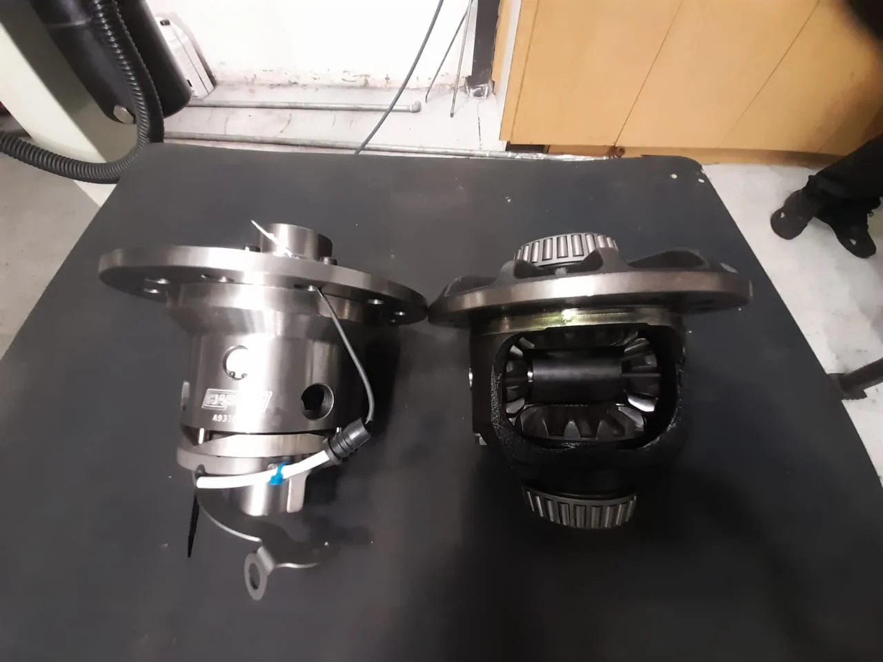

Spacers? That full floater is all painted and clean, is that how you bought it? If so, I'd be suspicious what the paint it covering. What's the plan with that, slap it in as-is or add a locker?

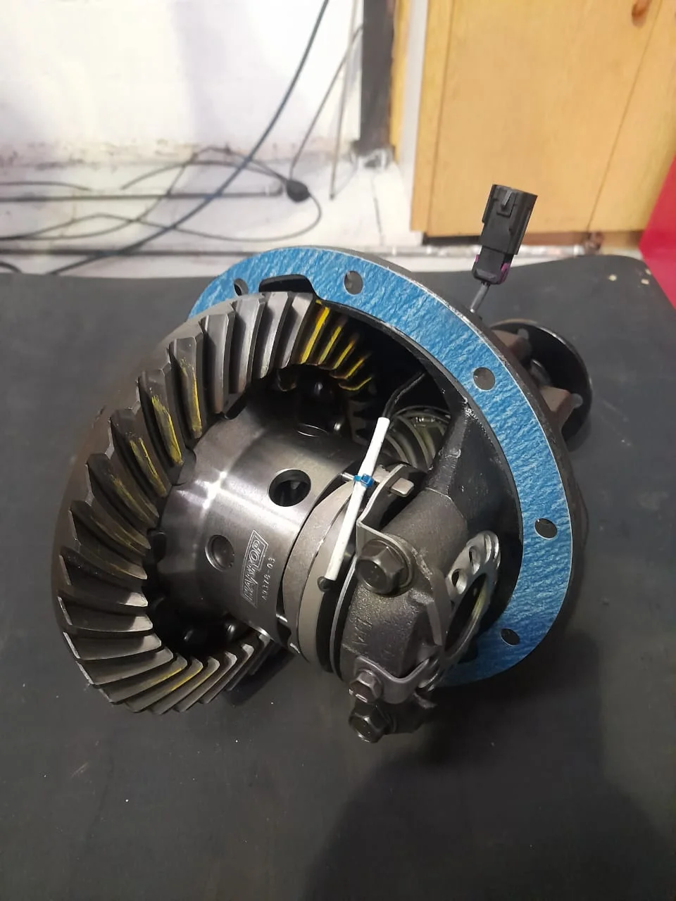

My current spacers will remain. Ignore the paint as it is from Botswana so we will strip and go through it from top to bottom. If there is enough $ left in my limited kitty, I might get to fit a Terrain Tamer elocker before we go to Moremi in October ..

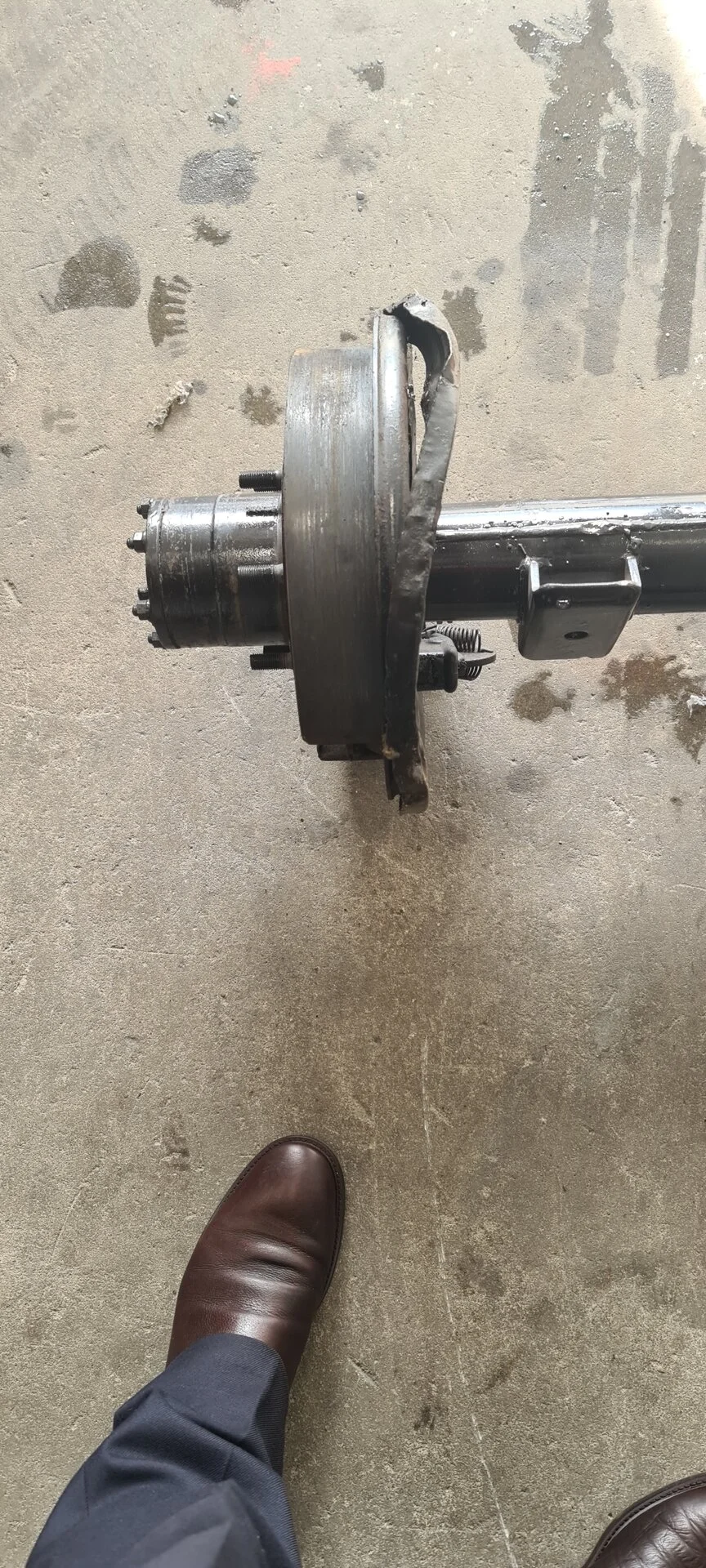

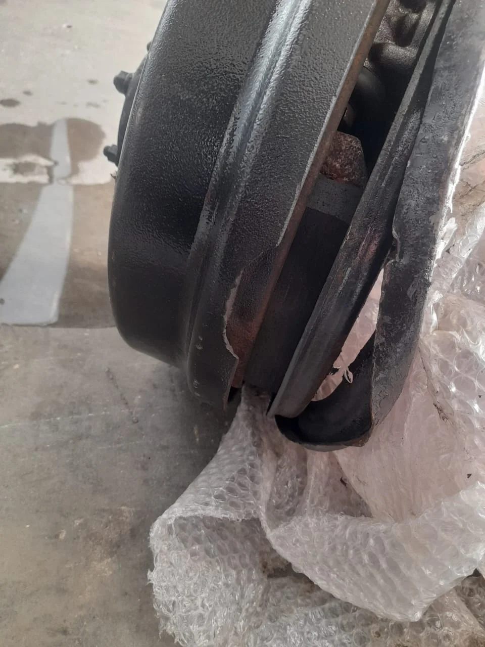

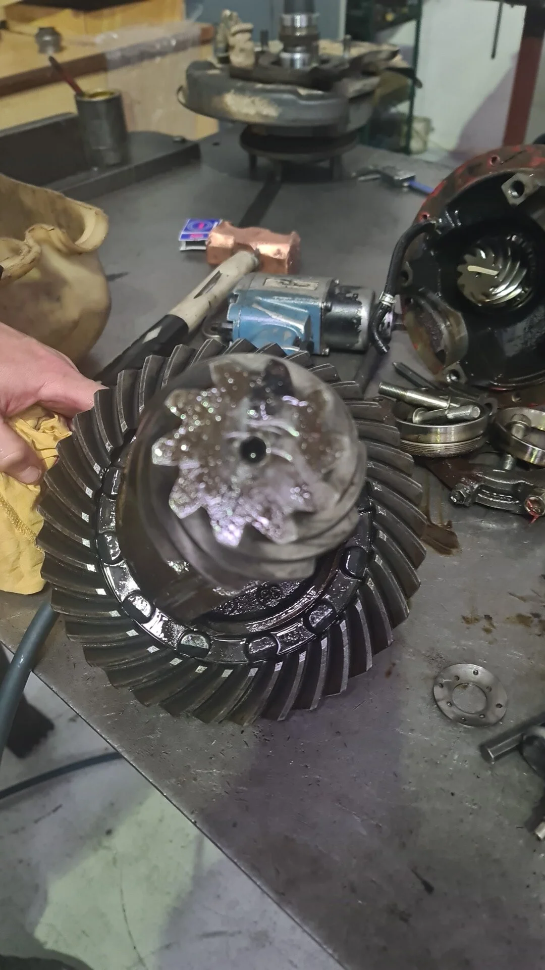

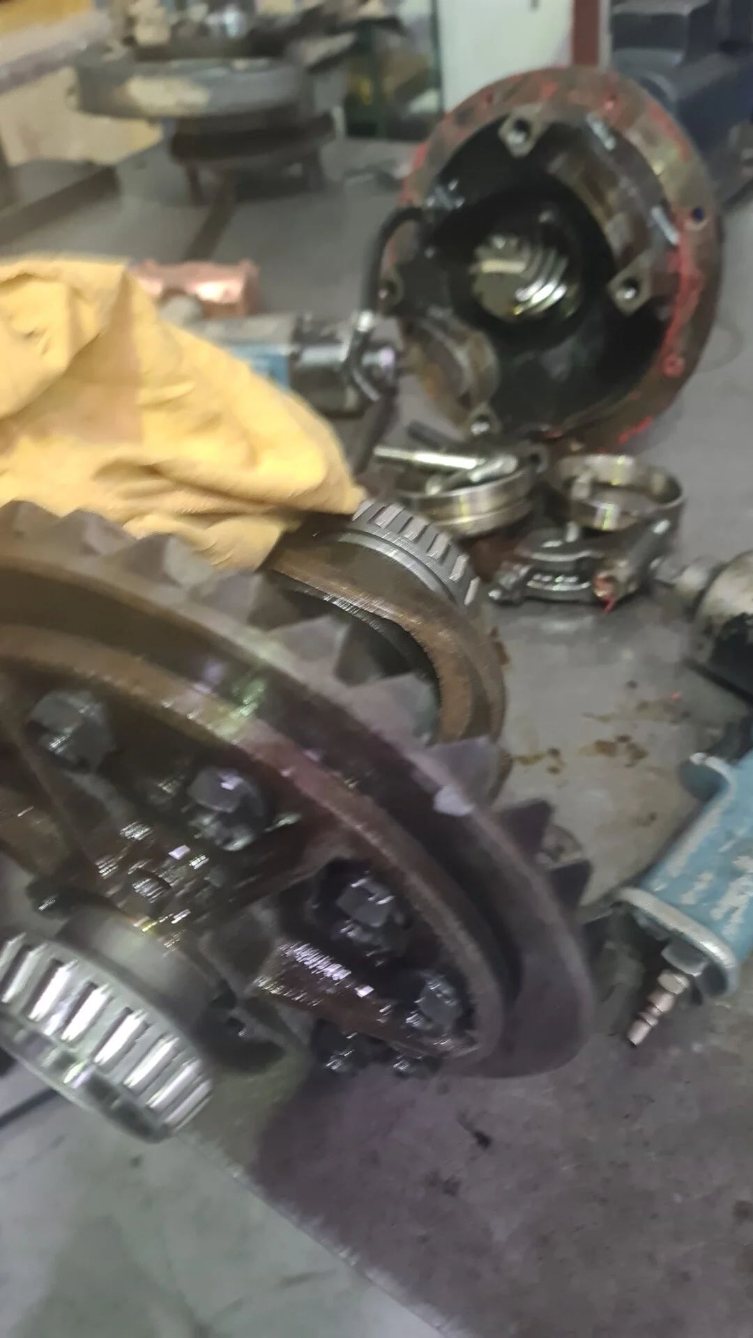

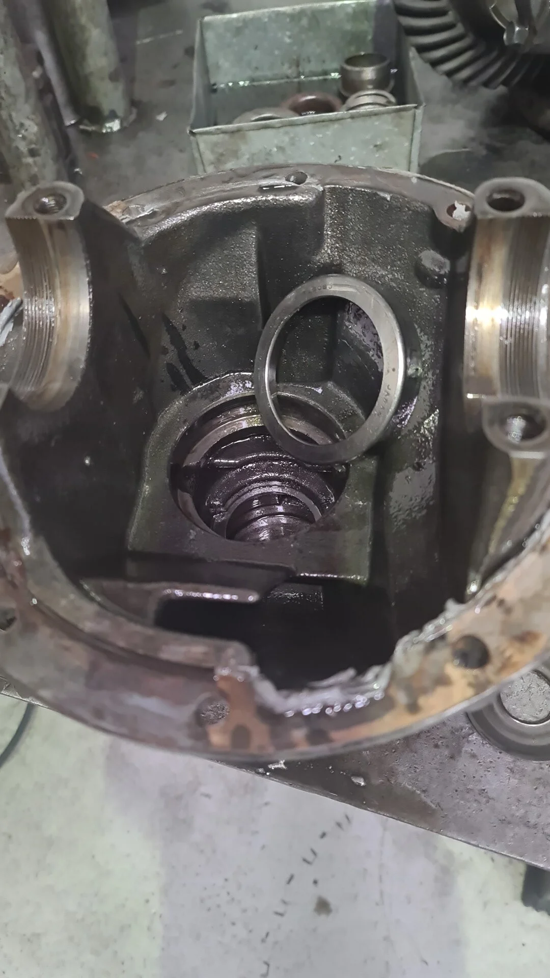

So when the FF axle arrived, it was not as rebuilt as it was said to have been, the ratio was 3.7 instead of the claimed 4.11 etc ...
But the housing was clearly a replacement unit as its condition did not correspond to the rest of the parts and the halfshafts were also still goodso after getting a partial refund from the seller, things changed. We then decided to use all the required bits from my "old" 129k km SF axle.Surprisingly it all swapped over and together like a lego set.

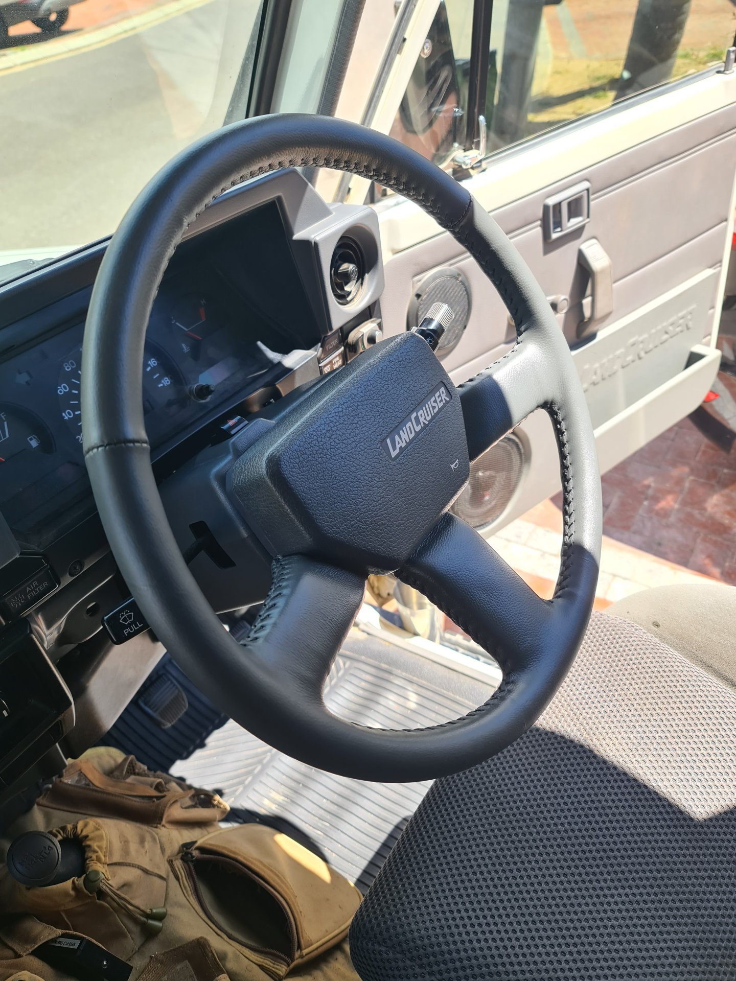

Found one !
But it is not for the narrow nose so we will have to modify it some and make provision for the gauge pod also ..
