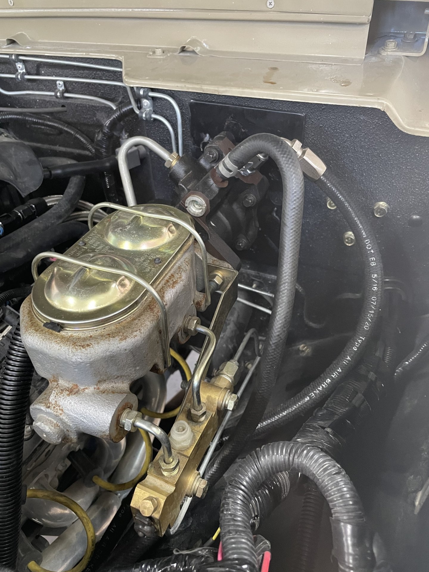

I’m waiting the a seal kit for the hydro boost unit I picked up but decided to get things prepped for when it’s here.
The original mount needed adjusted to center with the firewall hole so I did a little fabrication. I also cut the GM end off the pedal rod and threaded it to fit my spare clevis pin.
Swapped out stock hoses for -AN fittings although I ordered a stock GM pressure hose since it should attach directly with my GM power steering pump. It was $20 and much cheaper than buying -AN fittings.

EDIT...That big nut on the hydroboost, I had to buy a 1 7/8" open end wrench for that. That wrench is almost 2' long.

I tackled the nut with a hammer and chisel. I couldn’t bring myself to spend money on a tool I would never use again. My dad had all those tools for working on heavy equipment and I had no use to keep them. (Until this one nut).

I probably spent about $200. The lines fit right up but I needed a new reservoir lid and a proportion valve.

It's my understanding vacuum isn't as constant as the hydroboost from the power steering. LS motors are not known for a ton of boost in all situations, especially motors with hotter cams, etc. Better stopping power all the way around. A good example is my M37, the more throttle I give it the slower the vacuum wipers go.
I had the late 55 booster and MC with disc brakes and it did not like to stop. I always had to down shift on a hill. Just going to GM hydro and MC and not doing anything to rest of the system it stops as good as any new truck.

Yeah! I can lock up my 35’s. It stops now! What a difference. Everything bolted up just fine. My $20 stock GM hose is a bit tight but functional. The 55 must place the booster a couple inches further from the power steering pump.
