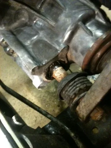

Back to my transfer case. The boot on the front flange of transfer case is shot. Been trying to find a part number, but cant find one past 1980.07

Toyota Part 36318-60010
OEM Toyota BOOT, TRANSFER FR DR
My truck is an 1981.01. Will this work?
Is it necessary for me to change the boot?

You've got a split-case, so order one for, say, a 1984 FJ-60 and you're good.

Hmm. I dont get it according to www.utoyot8.com my 81 FJ40 has a Dust Deflector vs a Boot. Late Model FJ60's show the same Dust Deflector shown below (Part # 36104B / Toyota Part # 36325-60010)
Per my previous picture, I definitely have a boot not a metal deflector. The only thing I can figure as being a Jan 81 I was between changes or something. Anybody have any other clue...?
The part you listed is for the output shaft not the shifter. It doesn't look like they show it in the diagram. Do you have one that shows the gear as such? Maybe on that one.
