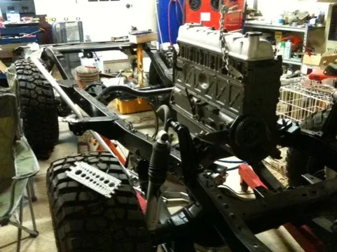

Got the 2F back on the frame after mmm several years!
Next, working on getting bellhousing, clutch, tranny and transfercase back together.

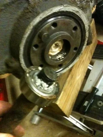

I've heard of doing that with grease- but that has got to be the coolest way to remove a pilot bearing! And damn easy to remember too!
