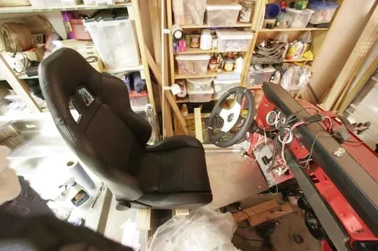

I went and picked up my seats also, and set them on wood blocks so I could determine the proper height.
OOO guages and steering wheel
