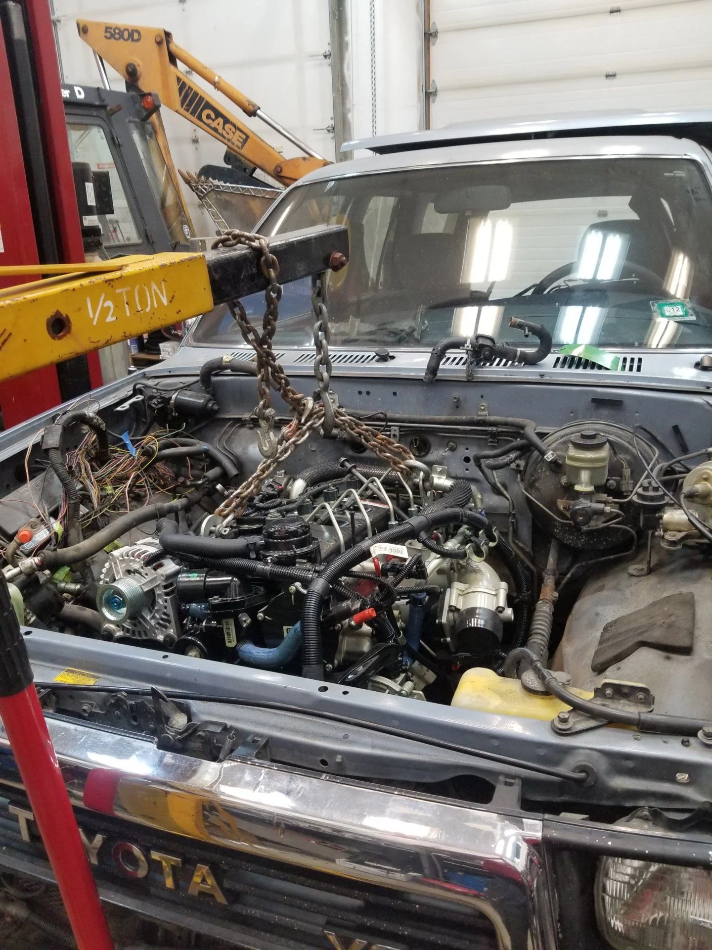

Hey guys, I am also doing a r2.8 swap on my 1990 Toyota 4Runner. The previous owner ran it until there was a hole in the engine block, so I decided to this swap to it! There are still a lot of work to do, but I am projected to be done by May.
I am running with 4l60e with a np241 passenger drop.
I still need to lift the back up, but it is looking good so far.
The engine wouldn't fit on the stock IFS, so I went with trail gear's IFS eliminator kit.
View attachment 1616722 View attachment 1616726I am running with 4l60e with a np241 passenger drop.
I still need to lift the back up, but it is looking good so far.View attachment 1616731
The engine wouldn't fit on the stock IFS, so I went with trail gear's IFS eliminator kit.View attachment 1616733
