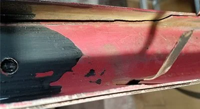

Prepping the bib. I looked at the gaps between the spot-welded pieces and decided to put some thinned rust encapsulator in all the places I could.

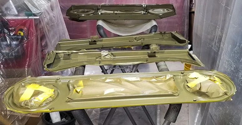

Painted the insides of the bezel, bib, and aprons.

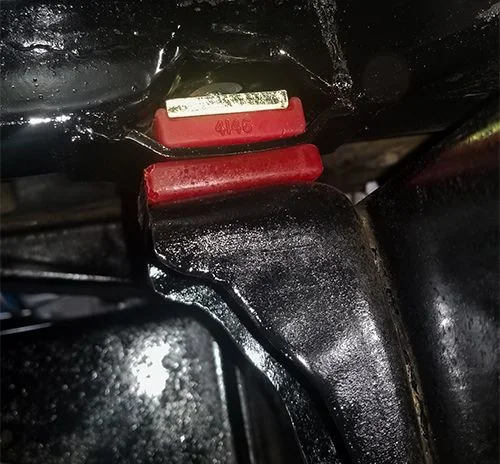

Installed new body mounts with the help of two floor jacks, reciprocating saw, vise grips, and angle grinder with cutoff disc. Despite spraying with penetrating fluid two weeks prior, they fought me all the way. I tried the nuts and bolts and they felt loose but that was because they were spinning.:bang: I didn't get to the two in the rear, they'll have to wait until I drop the fuel tank and that's not happening soon.

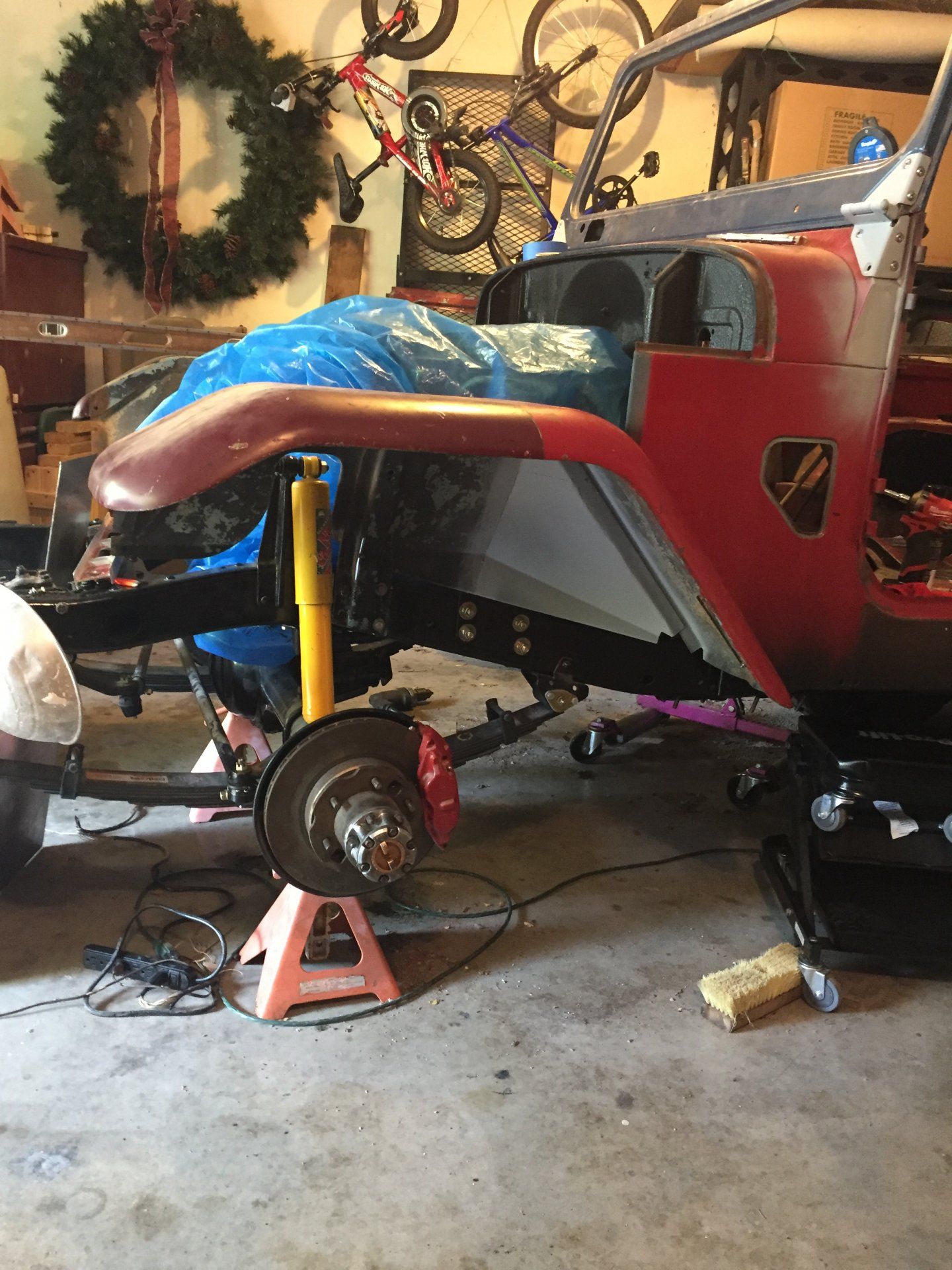

POR15 on the running boards.
Working on the fenders now.

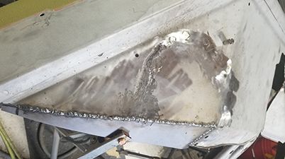

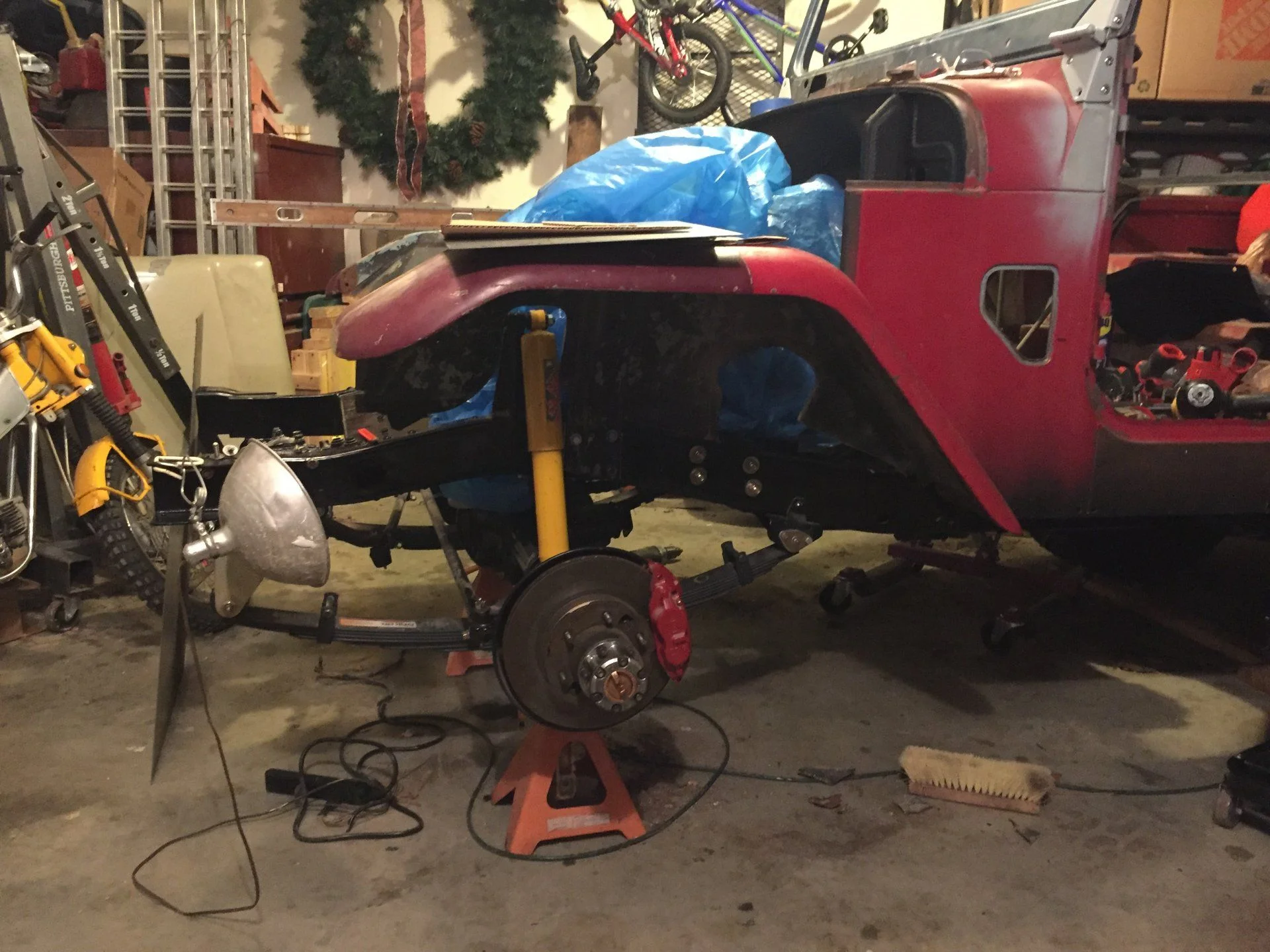

Another branch of the rabbit hole. Looking at the driver's fender, I decided I didn't need the clearance bump for the old steering gear box, so I cut it out.

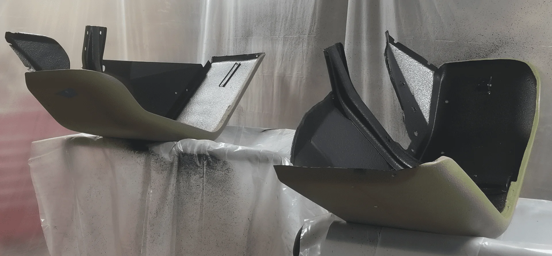

Duplicated the look of the passenger fender on the driver's side.

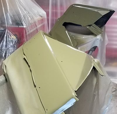

Painted.

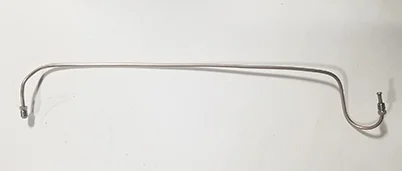

One transfer case vacuum line down, two to go.

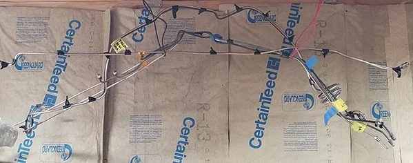

Finished the vacuum lines to the transfer case and some of the brake lines and placed them up high to keep them safe.

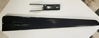

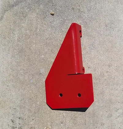

Powder coated the slave cylinder bracket.

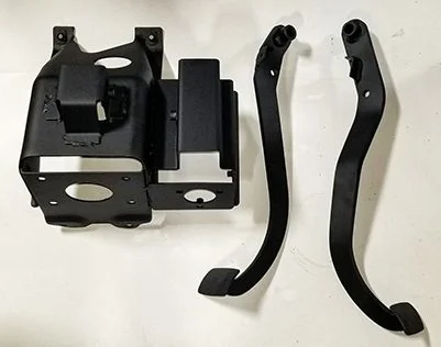

Sandblasted and powder coated the pedal assembly.
Surprisingly, the plastic bushings still looked good after 50 years.

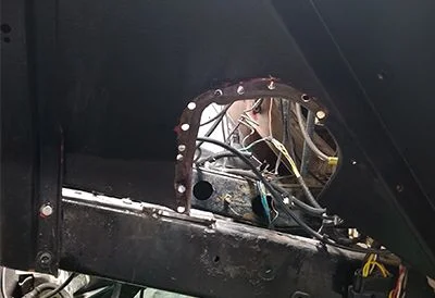

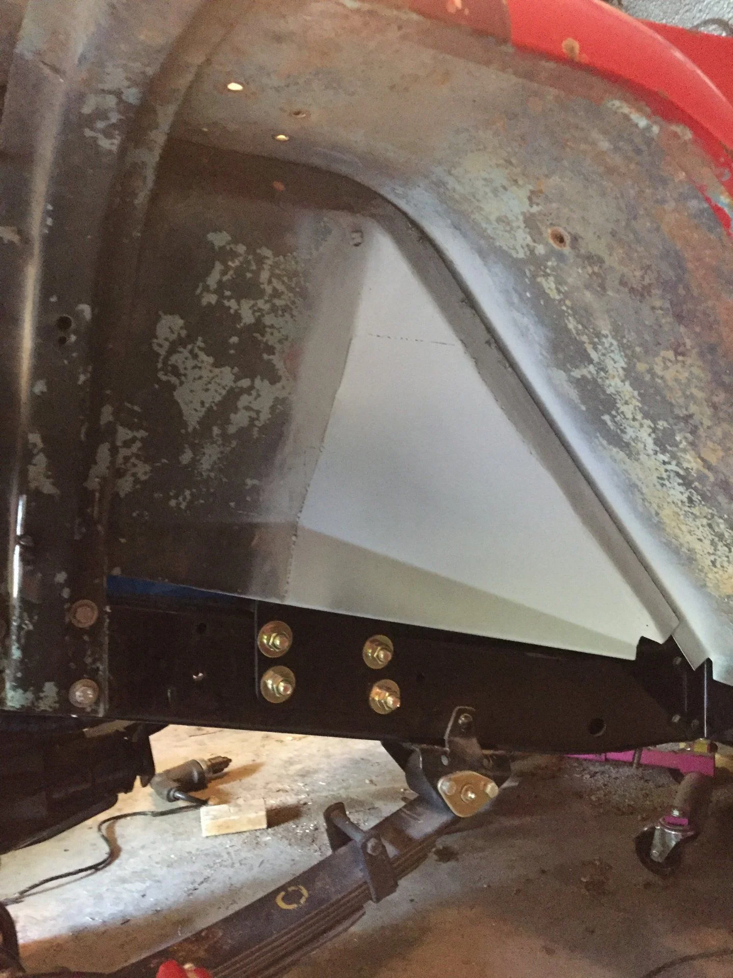

Finally finished the wheel wells, epoxy primed and Monstalined.View attachment 2504751
Look good! Just curious - when you (or anyone) does bodywork do you do anything to address the seams and spot-welded lap joints? That seems to be a spot rust festers, just curious if anyone really cuts the weld and gets weld-through primer in the joints or if the hill just isn’t worth the climb.
When I welded any kind of overlapping joint I used a weld through primer. I posted some pics of seams or joints I couldn't take apart. For those, I used some kind of rust encapsulator injected as best I could. Luckily, my cruiser had very little rust.
