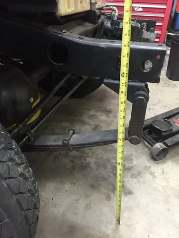

Who's lift is the "in" lift these days? I have what I think is a skyjacker lift that came with my FJ40, and it seems very tall, maybe 4 inch. Your off to a great start.

I'm not sure on the lift preference myself... I just installed a 4" Rough Country (SUA). Without the body weight and on short shackles I'm thinking it is yielding close to a 5-6" lift right now. I know this will settle a little, but curious to see how much.
Overall I was not impressed with the kit.. Missing nuts and sub-par paint on springs.. kit only came with large eye bushings (kit was for a 64-80 year range), glad I had already changed all mine from the small to the large eye hangers or it would have been a real inconvenience for anyone, including a weekend project that if not known or caught in advance would put a guy behind a few extra days waiting for shipping...
Price was 545.00 plus 52.80 shipping. For 600$ (yes, i was being a cheap ass and trying to lower build costs) I guess I got what I paid for..... Last time I ever buy a RC kit for sure.

I was thinking OME, on all the FJ40's I've ever owned, they all came with a aftermarket lift. So I've never purchased one. 2.5 is what Iam thinking with 33 inch tires. This lift seems tall.

I just went out and measured mine... I'm sitting a 26-3/8" to the bottom of the frame on a SUA... VERY TALL!!

Sitting on 33s my new ome 2 1/2" I'm at 21" at the same point as your measuring tape. I only have the engine in the frame. If you didn't want to spring for the new lift, it looks like your shackles are pretty long compared to stock or even the ome.
I had to go measure mine again after J posted up his measurements on new 2.5" OME and new 33s.... I too just have the motor/trans in... With a true 36" SS tire and the "4 inch lift", YUP.. 26-3/8" DAMN!
