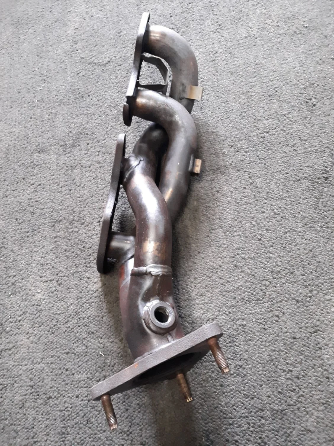

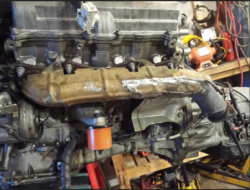

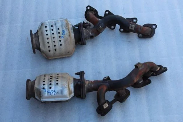

As for the manifolds. Retain as much stock as you can. They are well designed, and the aftermarket headers that arent 1500$+ split like bananas. You can look for different versions, and the 2UZ manifolds are the same. Early 2UZ manifolds are log style and hug the block to the rear, while LS400 and SC400 ones will have different length runners and cat flanges in different position. But from experience, ANYTHING stainless is not going to last at all. Elate makes SCH40 ones, which if youre going aftermarket would be good. But otherwise the stock ones can take some serious abuse and heat cycle well.
Thanks guys, lots of good info here re the headers, for me though, that ship has sailed (assuming the gasket blanks that Sraps suggested work). I am in the mode of 'git her on the road' right now as the project has been sitting for over two years largely untouched.

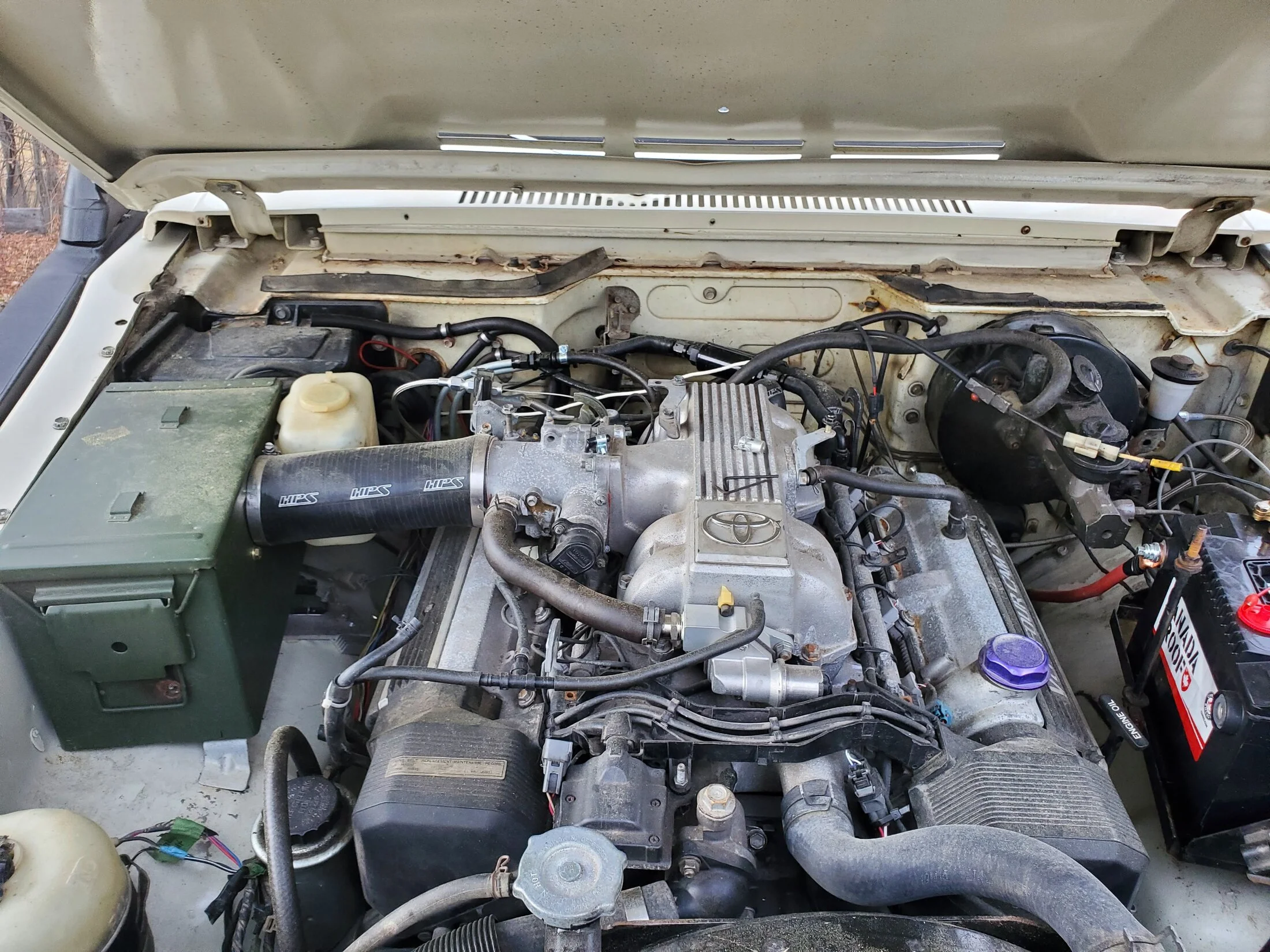

engine bay picture i promised of my crusty old daily - not terrible for a 300k mile sh!tbox that lives in the middle of nowhere on a dirt road lol also dont mind my cut out shock towers. Its because the car is slammed on its nuts and the upper control arms bang the towers so you cut holes lol
considerably cleaner than mine...
that airbox is awesome lol but you have cast round fuel rails, which means your engine is a 95+, and since your PS reservoir is on the pump and the brackets for the engine cover, its an LS400 engine. That one does not like the timing belt to go bang. But they have standard valves and not the sodium filled ones the 89-94 have, but slightly larger cam profile.
That vacuum line that goes to the nose of the manifold - that one ziptied to it is for the idle up valve which vacuum assists your PS but mainly at idle, and full lock. Its completely useless. I use an M14x1.5 oil drain plug from a B5.5 VW and remove that valve completely. Hit the plastic off with a hammer, and makes getting a wrench on the base easier. Definitely use some sealant. Otherwise they leak like an SOB and will deteriorate the connector on the back of the alt, which will fry alternators like mad. Then getting a connector is a PITA. Should be round plug because 89-92 was oval but sometimes things get wonky.
I am not seeing your fuel pressure regulator. You are running one I hope?
Keen eye @BoomerUZ , bought the engine from a relatively well-known JDM importer, was told Celsior (LS400), 96 and 75K KM. When I got it I did the timing and water pump before install. Good advice on the plug, that plug was temporary. Yes re the fuel pressure regulator, but I still have to get it installed - likley just inline prior to the fuel line or will weld a bung in - it's on the list of many small things todo on this truck before it hits the road.
The capped line on your throttle body is the vac ref for the regulator so I was concerned. You can use any aftermarket one, I use ebay ones just fine and set the pressure to 43lbs and then adjust everything else by the tune.

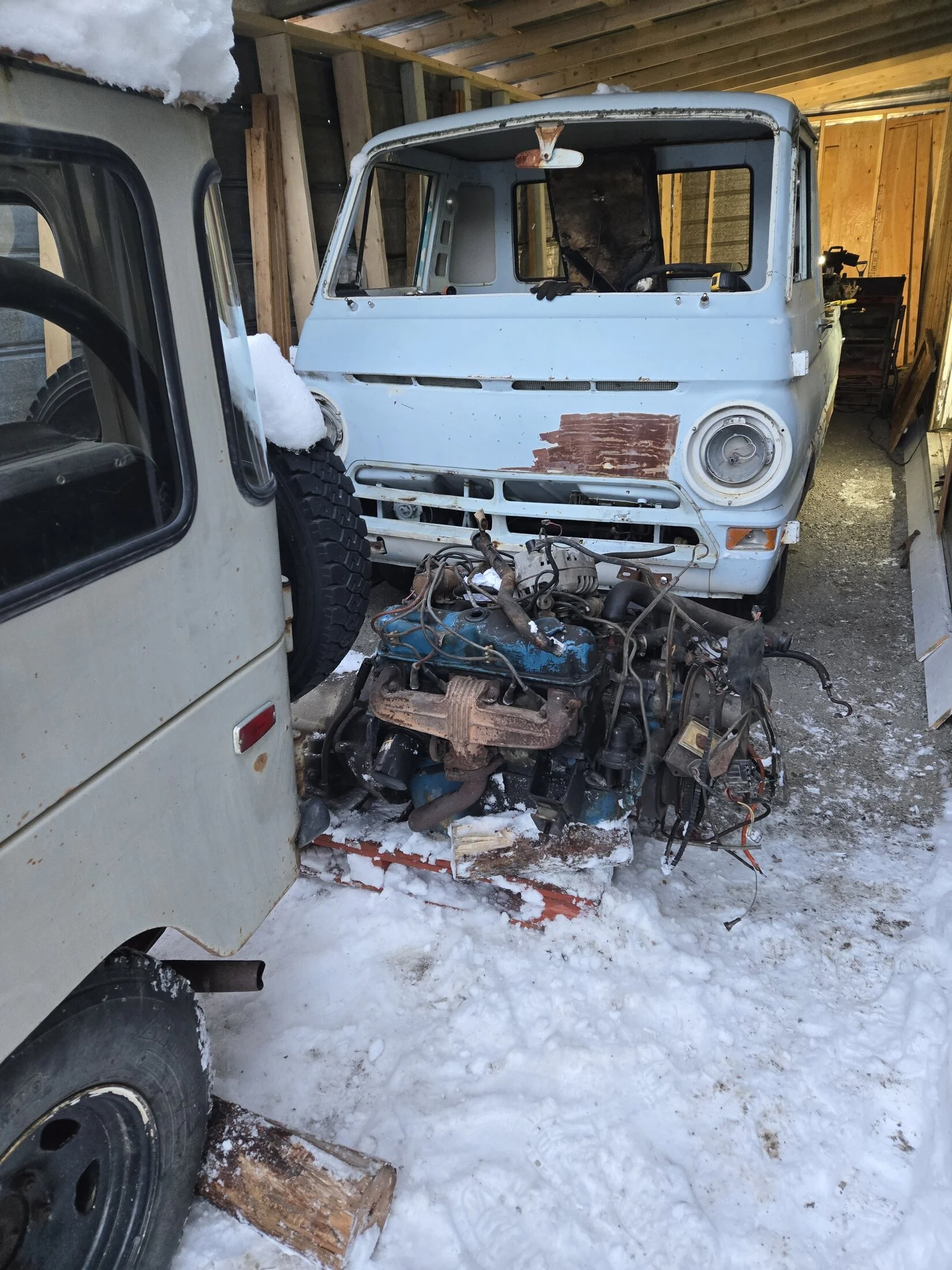

Got distracted by more projects, picked up a 1967 A100, used to be my favorite hot wheels and couldnt resist - it will need an engine swap.
