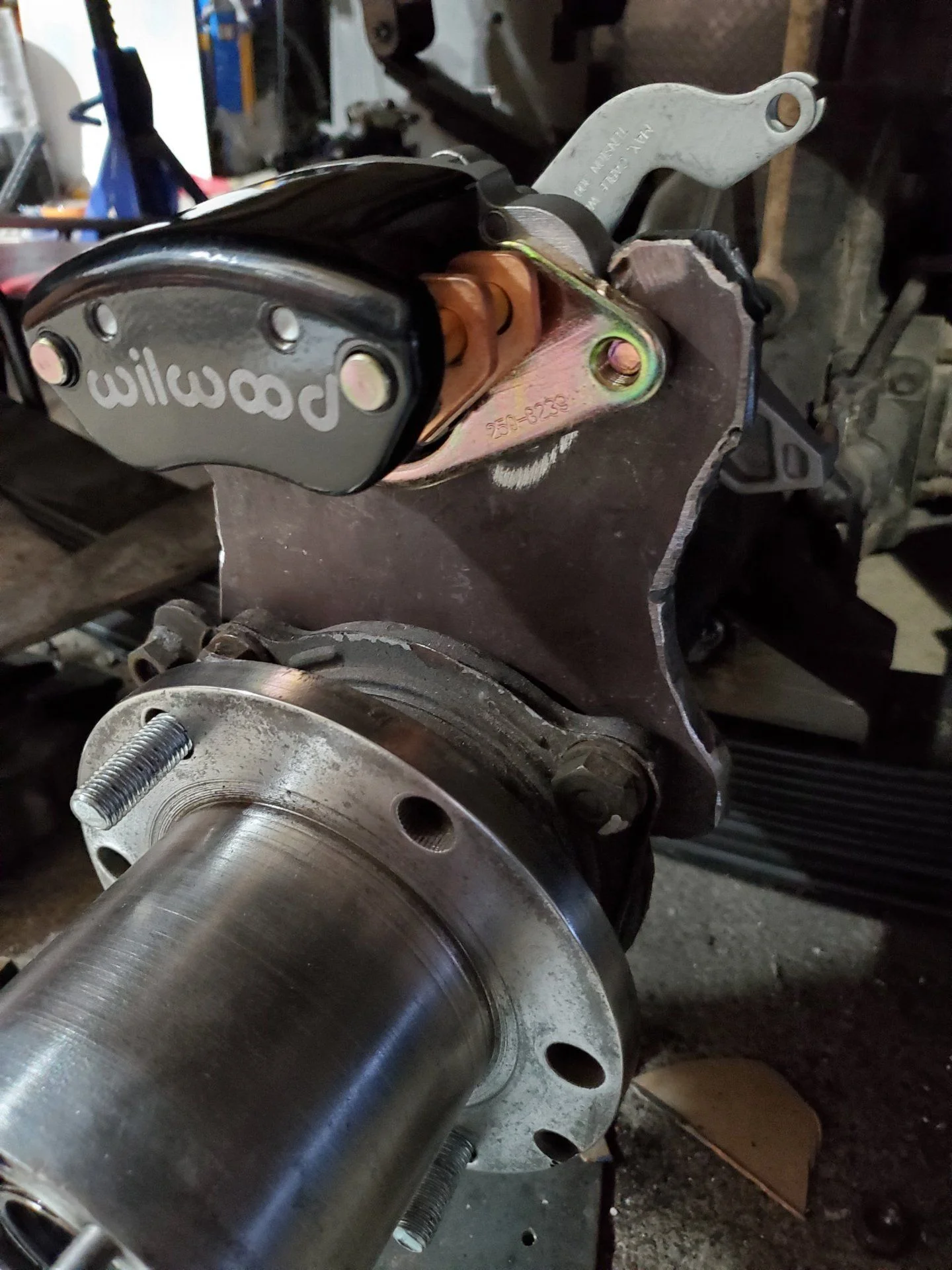

In other news, I am not going to win any style points for my plasma cutting (it was my second time) but I have a plate that will work for the emergency brake. Cut from 3/8 because there isn't a lot of material inboard of the top bolt holes, probably overkill.

The MC4 mounted perfectly, used 5 washers as a spacer to align, I guess the other option would be to weld on some plate and trim to thickness
