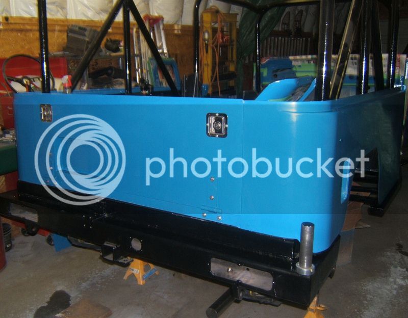

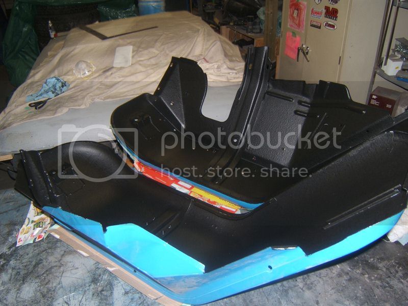

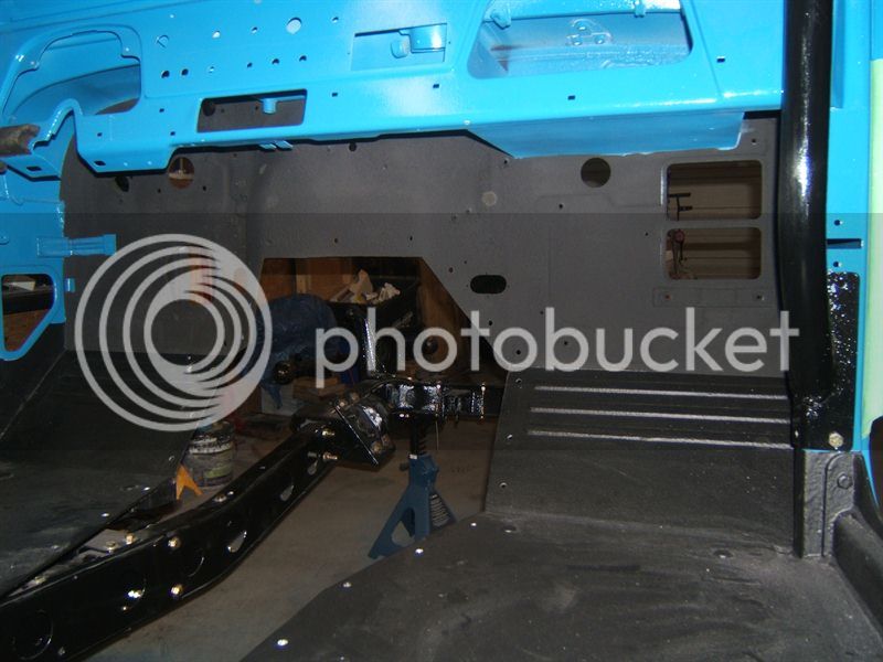

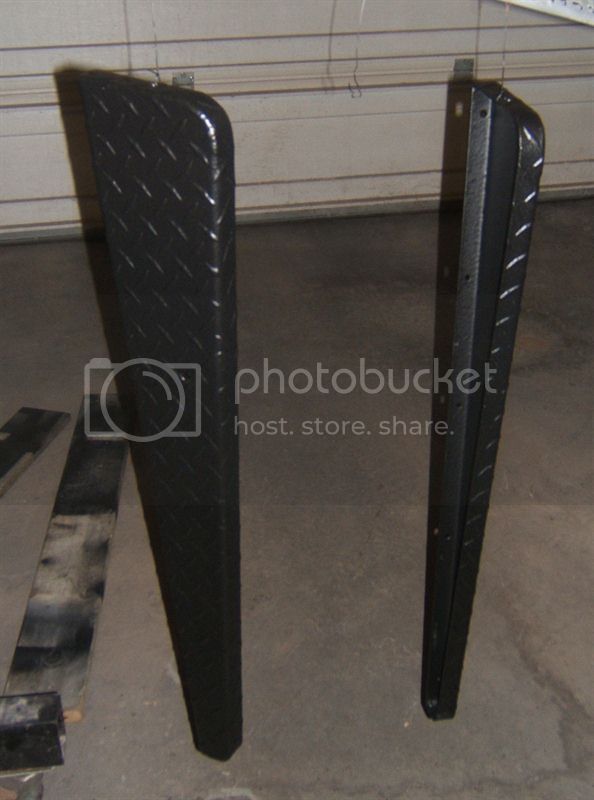

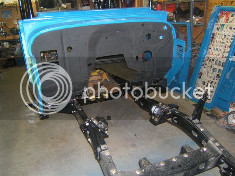

Just some pics of the last of the bedliner. The inside floor is done, The rear bench seat / battery box and all the parts, transmission cover, fenders & the side steps.
Lizard skin on the firewall inside and out and the transmission cover, next weekend and I'll be able to put the engine back in. Can't wait to start plug in things together and get this looking like a complete truck.

Didn't get much done this weekend. Lots of family stuff so didn't get as much time in the shop as usual. Did get everything masked for the Lizard Skin and try to spray it with an undercoating gun but it didn't work. Guess I'll have to get the real spray gun that goes with the Lizard Skin.
Changed gears and finished wet sanding the tailgate and the body from the doors back. Got the tailgate installed.
That's it for this weekend...
Lookin' good. I got a schutz gun that I used for the raptor liner if you want to try that.
I used a shutz gun as well for doing my truck. Came out really nice.
Thank you for offering me the shutz gun but I ended up just ordering the gun from Lizard skin. I compare the openings of a shutz gun at a local part source to the Lizard skin gun and there was quite the difference. This is is what it looks like done.

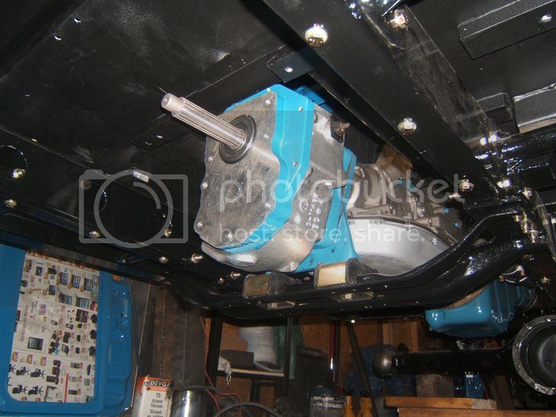

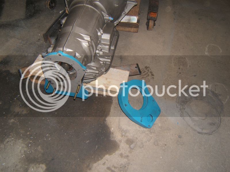

Once I got the coating done I was time to get the engine back in. I decided to finish building the NP203 range box and installing it to the engine before dropping the engine back in (the NP203 fully assembled is a heavy bugger).

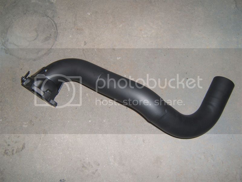

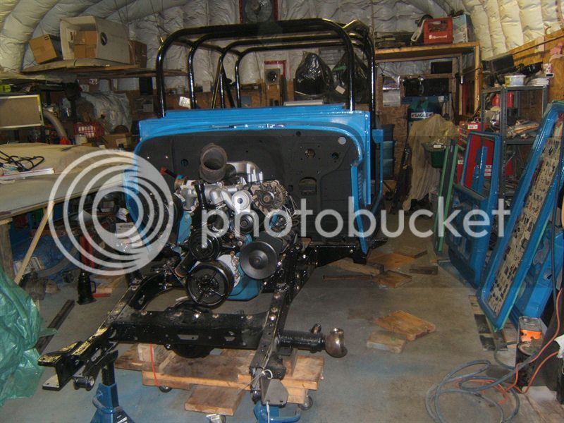

A buddy came over yesterday and help me get the engine back in. Here are couple of shots of it back in. Going to have to do something with the air intake hose that came with the engine.

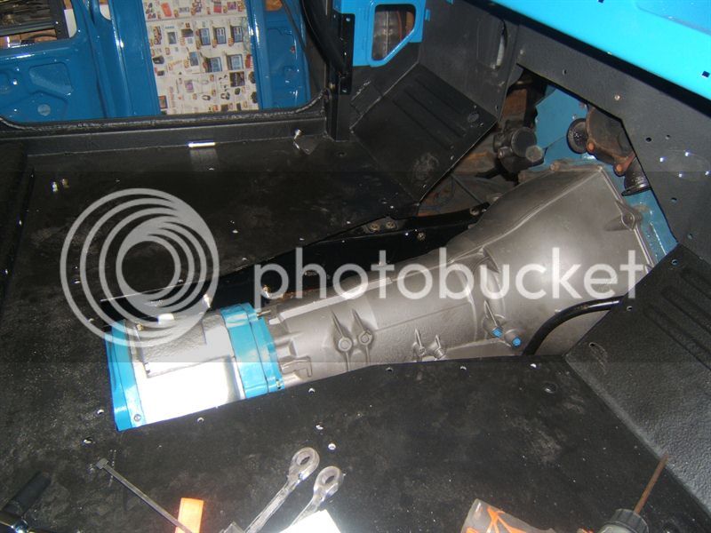

Also put the transmission cover back just to see what it would like. With Monstaliner on the inside and Lizard Skin on the underside the weight of the cover has really increased.

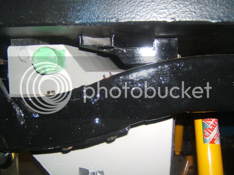

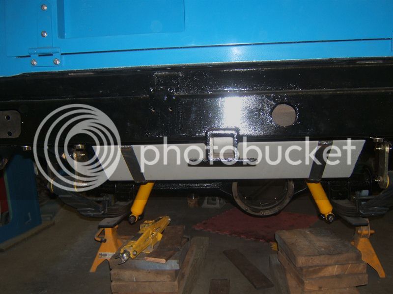

I've also started building the skid plate for the fuel cell. Some 1/4" plate and a couple of hours of work and this is what I got. Going to close off the side to protect the fuel lines (more pics to follow once it's done).

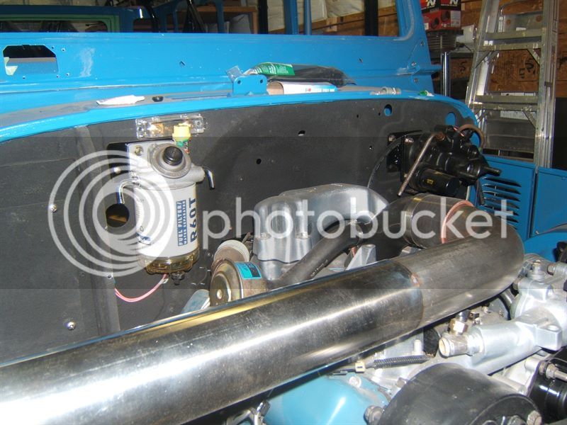

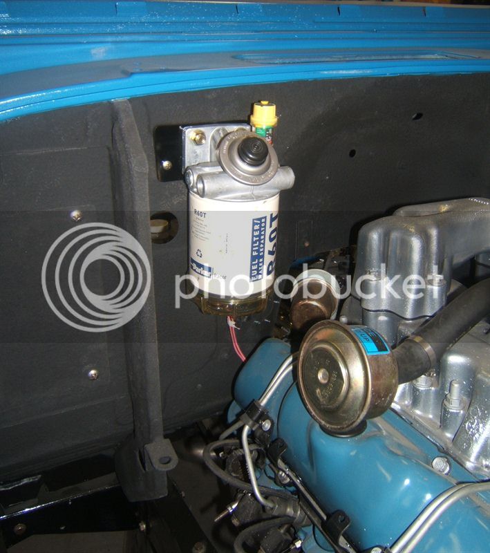

I did get the fuel tank skid plate done and got the fuel filter (Racor R460) installed.

Good call on relaxing and taking more time. It sucks to have the pressure on even though it will be sweet to get it done. Where did you order the fuel water filter from? Thanks, and keep up the good work!
Shad0Tr0n, Got the fuel filter from a local marine supply store (The Chandlery) here in Ottawa. I had also found it online for cheaper but by the time I added shipping, duties & brokerage fees I almost broke even.

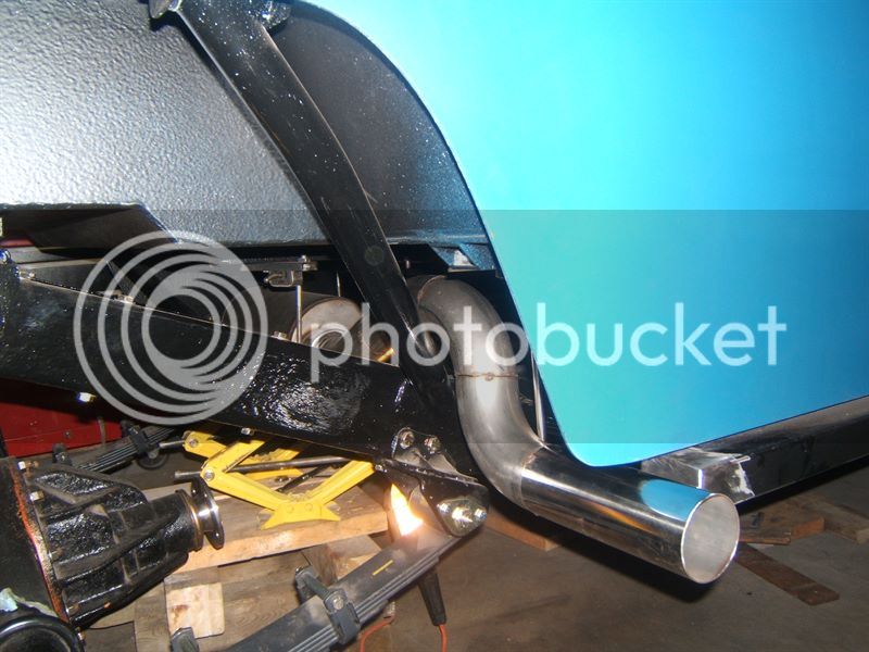

So work is still progressing. Not as quick as I was hoping but still moving ahead. I still plan to get the motor to run within the next few weeks and one of the major part that still needed to be done was the exhaust. So with a little 3" mandrel bent SS tubing, a Shuttleworth muffler and lots of time spent under the 40 this is what I have...
It's only tacked together for now (need to bring to a shop to have it welded), I also have to cut the tip just a little behind the slider. I also have to make a heat shield to protect the transmission. I had some pipe left over so I also started to work on the air intake.

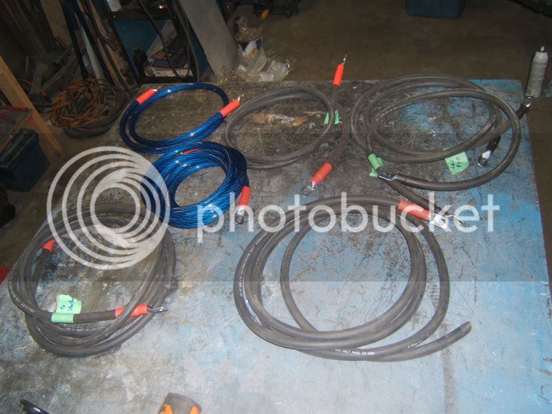

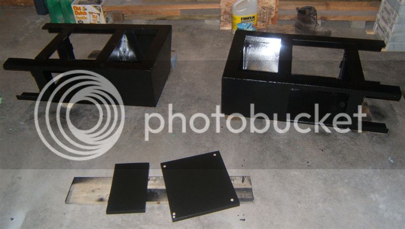

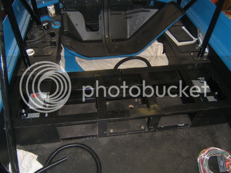

Also in pic the above pic you can see the main 150 amp fuse from the alternator to the batteries (just above the fuel filter). I've also made all the cabling from the batteries to the starter and from the batteries to the alternator (all 1/0 cable). To get all of these done I got the rear seat frames / battery boxes done and installed.

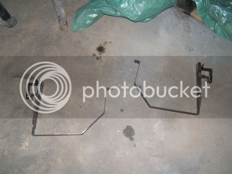

Now while walking in the scrap yard the other day I might have found the perfect rear seats for a 40. They are from from the middle row of a Chevy Venture van. The middle row actually has 3 seats but I only took the 2 exterior ones. Side by side they only measure 36" , they fold and tumble, are removable and have adjustable headrests.. I'll get them recovered to math the Corbeau seats.
