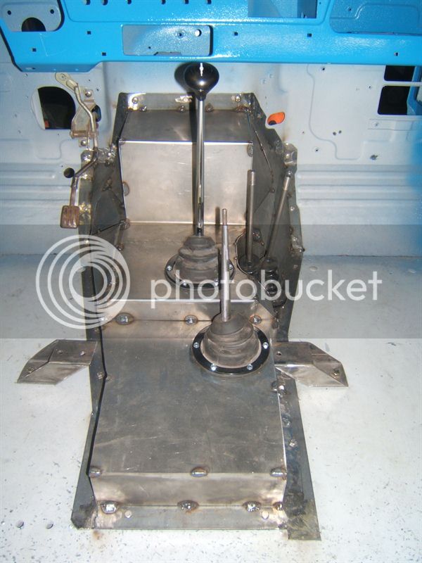

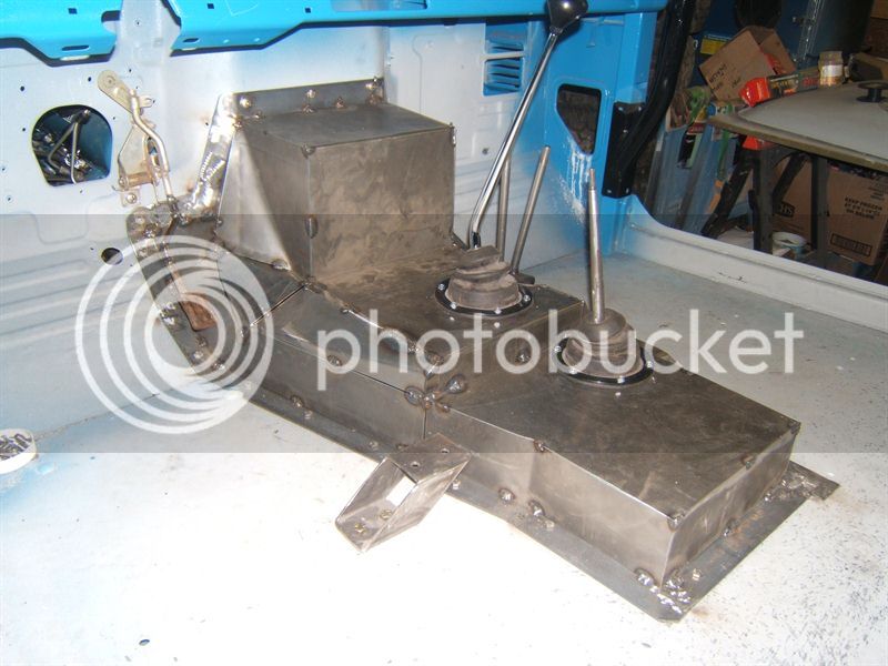

Just a few pics of the transmission cover all tacked up. Hopefully get the finish welding done this weekend.

Looks great!
Have you considered adding a couple of cup holders to the tunnel?
Where did you get your shift boots? I need to get some new ones and fix up my trans tunnel.

Steve, cup holders are always good to have and now that I've figured out what I'll be doing for the heat / A/C (Yes A/C, the only request the :princess: had for the truck) I think I'll be able to add a couple of cup holders to the front of the trans cover.
As for the shifter boots, the ones for the single sticks I got with the Aqualu trans cover I didn't use and the dual boot I got from Georg (Orange45 here on MUD) when I got his twin stick kit for the split case.
