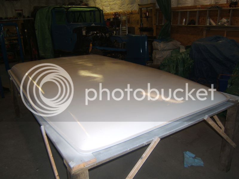

The painting is done...:D The roof is done top and bottom. On the bottom the rim was painted white and the fiberglass was coated with Lizard skin ceramic (hoping to keep a little heat and sound out) Forgot to take a pic :frown: The top is done also. Not 100% perfect but close enough (still a few low spot where I joined the two halves)

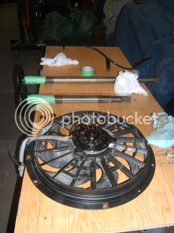

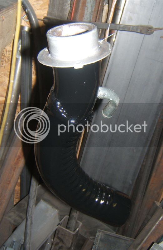

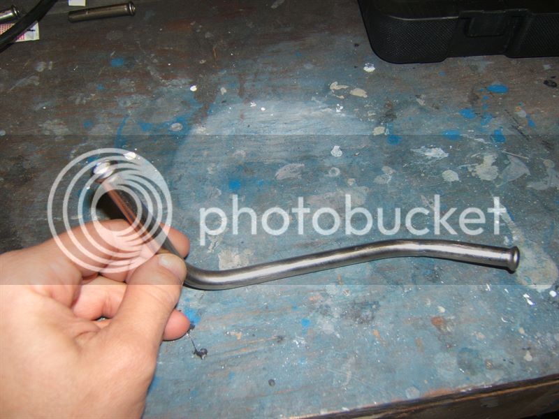

Rear axle shafts, dipstick tube and cleaned up a Volvo fan...

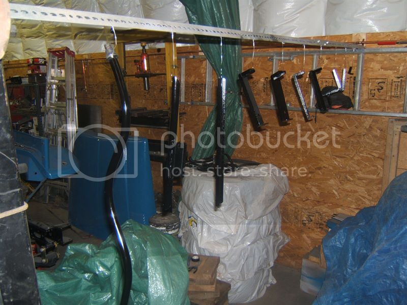

All the brackets for the exhaust system, wastegate and trans dipstick tube are ready for assembly...

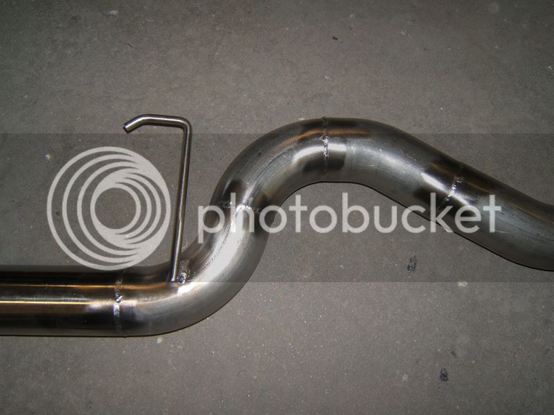

And all the exhaust pipes are back from the welders...

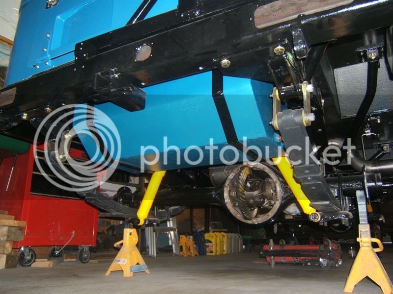

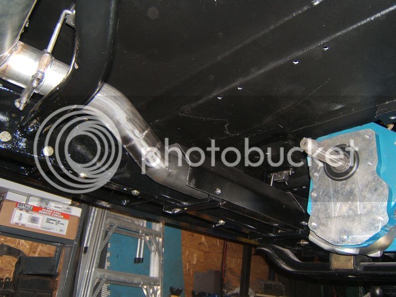

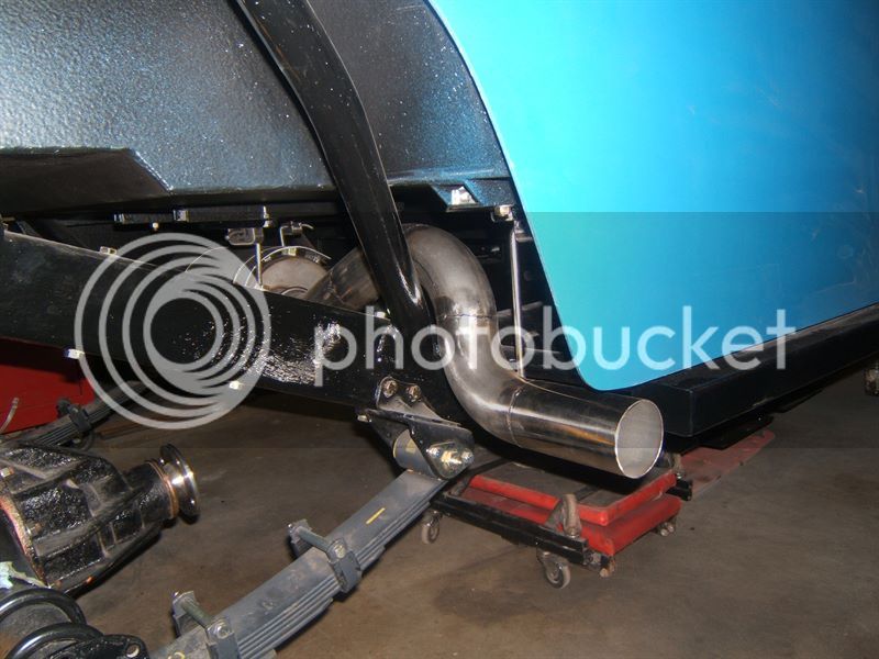

The exhaust is installed for good with all the heat shields. Heat shield where sprayed with Lizard Skin with the hope of keeping some of the heat away from the transmission, t-case and the floors.
The fuel tank, minus the skid plate, is installed for good.

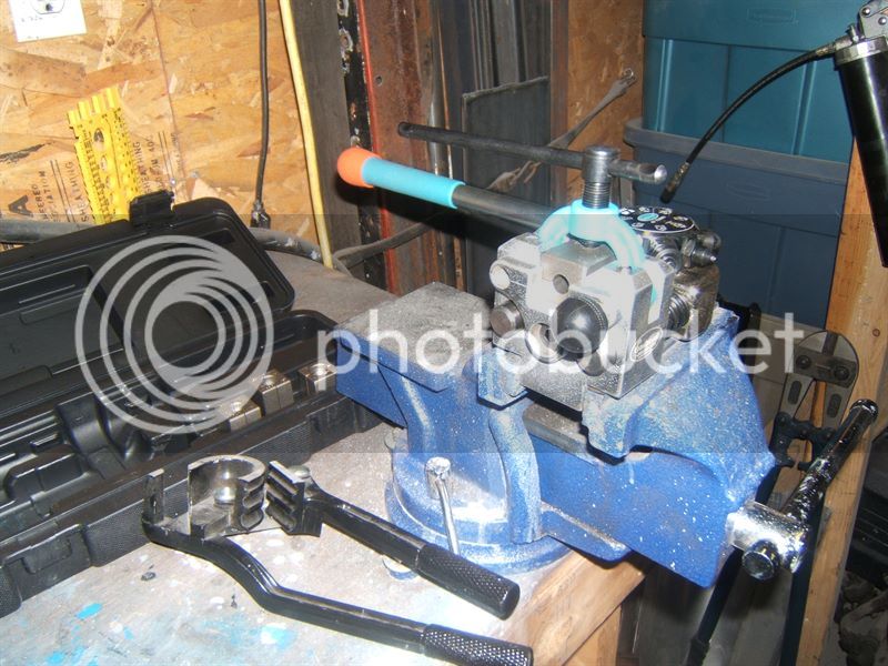

Got a new toy. Knowing that I would need to do a lot of flaring I got myself the Eastwood flaring tool. Here's a shot of the tool and a sample of what it can do.

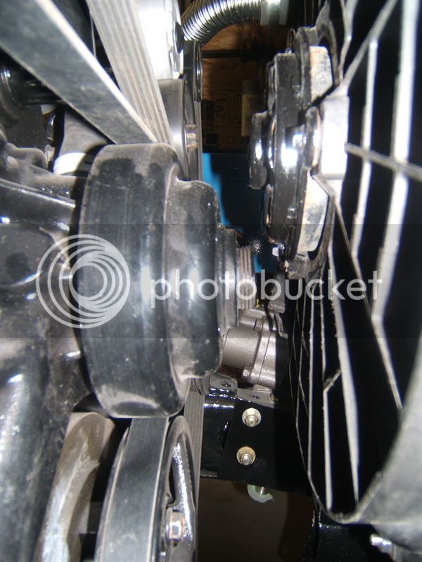

The fan was a tight fit but I think I made work. Not a lot of clearance between the fan and the water pump pulley but this is as much as I could get.

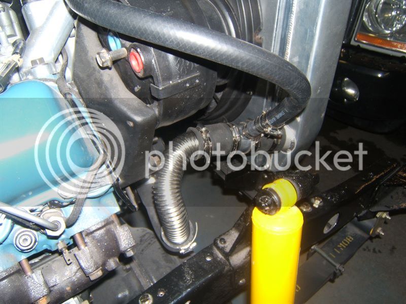

The plumbing to the radiator is done. Installed a heater bypass to get the engine running.

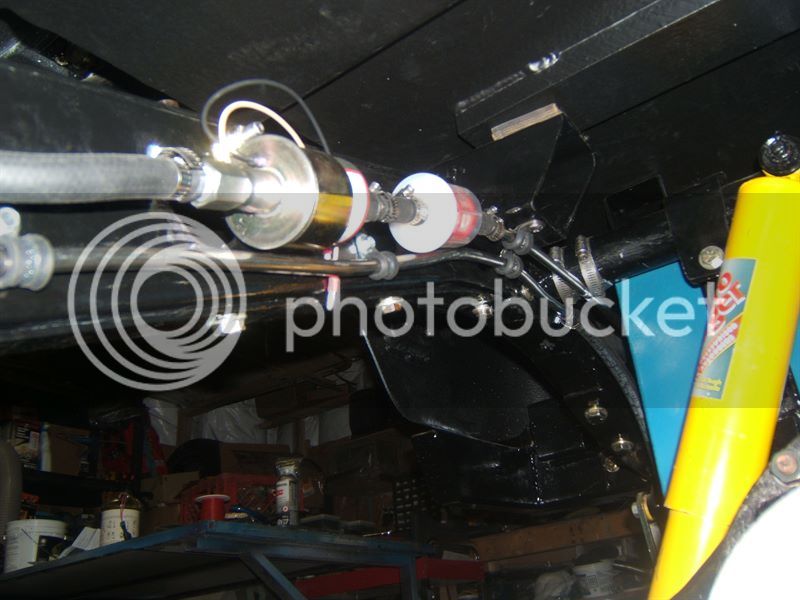

The fuel system almost done. It was actually done but there's a little section I don't quite like, so I'll go back and fix it before getting some fuel into. Here's a shot of the pre-filter and frame rail pump. The 3/8" ss fuel lines and the modified filler neck.

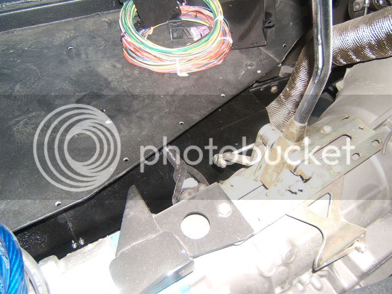

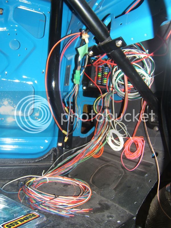

And finally here are some the work in progress wiring. The Painless harness is less the painless but should be able to make it work.

Just to finish off the perfect day :frown: the lower radiator hose clamp let go and the entire content of the radiator ended up on the garage floor :mad:
