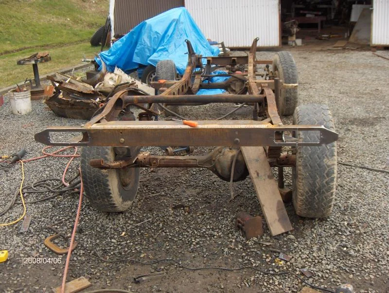

I finally got to work on the cruiser this weekend. Started by gutting the interior and removing some of mess the PO had done to this poor cruiser (welded in driver seat, fuel tank from God knows where). No real surprise with the shape of the body but the frame is a little rougher then I originally taught but nothing that can’t be fixed
Here she is in her new home
As you can see from the pics, I'm going to have to replace the rear crossmember and both rear frame gussets and probably the rear spring mounts

The frame is in ok condition, but the rear crossmember and the two frame gussets have to be reaplaced for sure.

don't be too scared of that rear section of the frame. I replaced mine with c-channel, about a foot of it. then replaced the rear cross member with a real bumper. thats usually the worst part of the rust there in the back. just check that the rest is worthwhile, any more than what your showing might not be worth the trouble. but I'll take a small frame repair over body repair anyday! less b.s. I replaced my whole rotted tub with an aqualu. front and rear cowl and windshield frame. so worth it.

zcruz, only about the last foot of the frame is rough so like you, I think I can repair it (haven't seen the frame under the cowl yet but if the rear is the worst then its not to bad).
