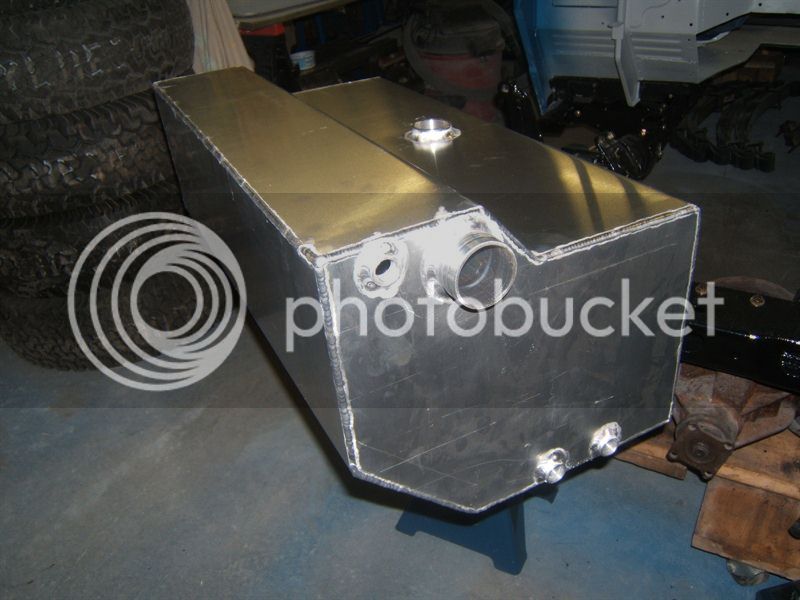

I'v got the guys at wicked garage out in Greely doing my tank. Not the cheapest but my only other options is to get one from the states. With shipping and getting it across the border I should break about even. This way I get what I want (it's a bit bigger then most aux fuel tank currently available) and also get to support a local shop.

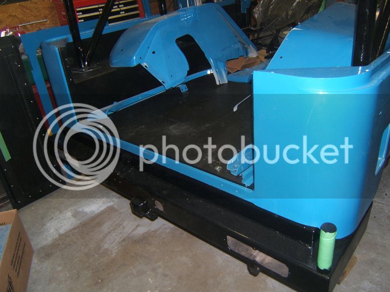

paint...
I am so tired but so happy that I finally got some paint on some of the parts. Still lots to do to get all done but... it's a start. Won't bore you with to much details I'll just show you some pics.

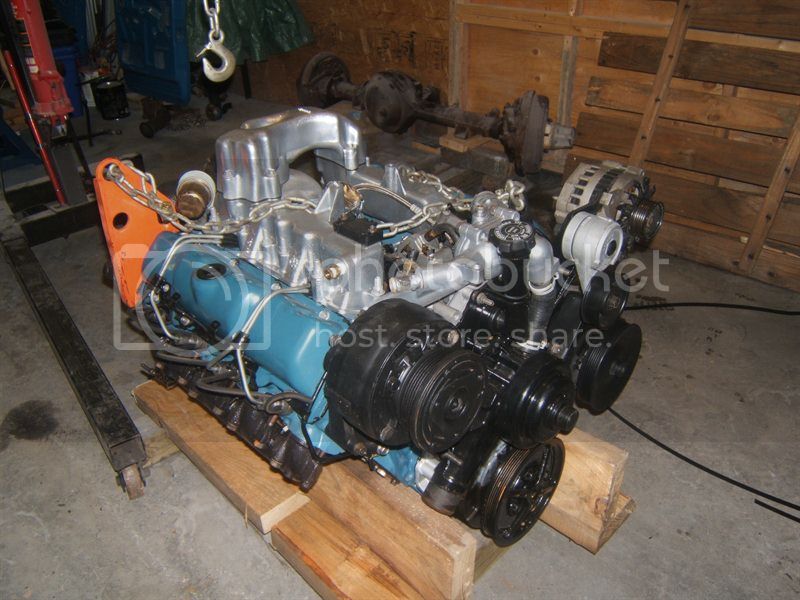

You guys have seen the post of the engine, now getting it to me has been another story. The owner has had some family issues and it has delayed the shipping. I'm hoping to go get it in Ogdensburg soon.

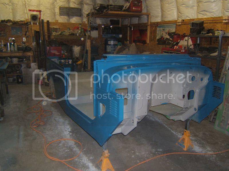

Got a few small things done this week. Got the frame, body and cage all bolted together.
Got my new fuel tank.

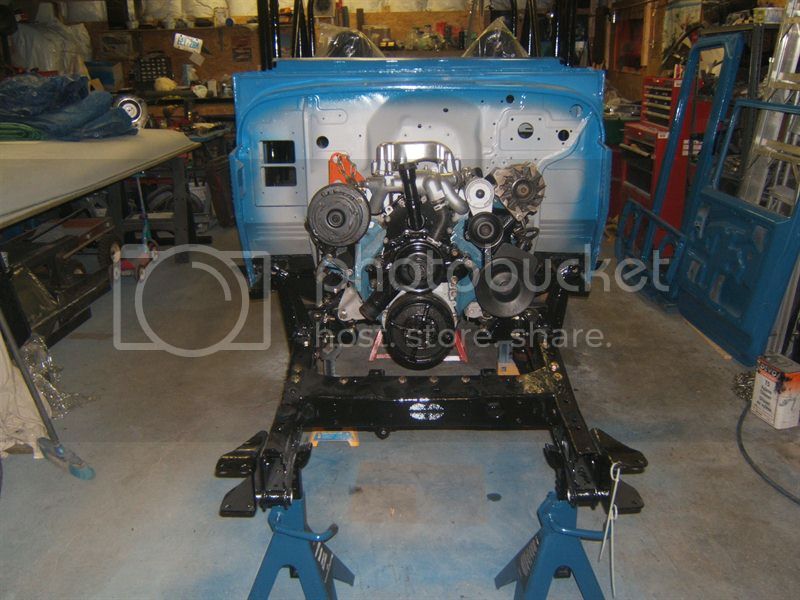

And finally got the engine and being really excited about getting it home, I had to drop into the frame. I still need to mock up a new cross member for the transmission but still need to wait to get the adapter back from the machine shop.
Here's the engine bolted up to the 4L80e
Here's the engine in its new home.
I will have to pull it back out again to finish the firewall. I will need to cut up the firewall a bit to make room for the custom driver side turbo exhaust. Also going to need a new heater...

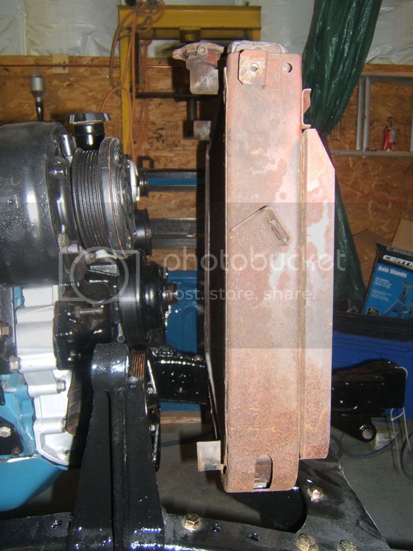

Also took the time to put in the old radiator and mount. Only about 2 1/2" separates the engine from the radiator. Looks like I'll have to come up with a way of moving the radiator forward to make room for a fan...
If you're not installing air con you can get about 1.5" more with the 79-84 grille, but I'm not sure whether the radiator will clear the headlight buckets on pre-79 grilles when moved up.
My friend in Australia moved his up to fit a 1hd-t into an 82 hj47.

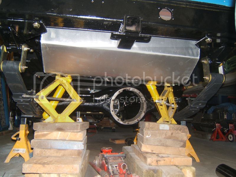

The axles have been taken apart and the housing painted. The rear housing is installed and the fuel tank is in position, now I need to make the strapping to hold it in place and a skidplate.

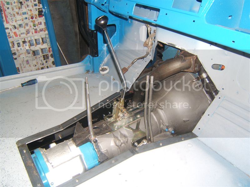

A little 304 SS pipe later, my downpipe is tacked into place. Also got the shifters in place and I've started building the tranny hump. The sooner I can get the tranny hump done, the sooner I can get the last of the coating on the floor and the firewall. Not sure if the pics will show it well but I had to move the fuel pedal over 1" to clear the tranny hump. Hopefully I don't have to move the brake pedal to much.
Sarge, both of those things are on the to do list. I'll be putting a skid plate under the fuel cell and plan on bringing it to the rear bumper. I'll make sure to take the hitch receiver into consideration.
The down pipe and exhaust or my biggest problem right now. A heat shield will have to be made to protect the transmission, but I'm also going to spend a little money and get the down pipe ceramic coated to keep more heat in the pipe.
