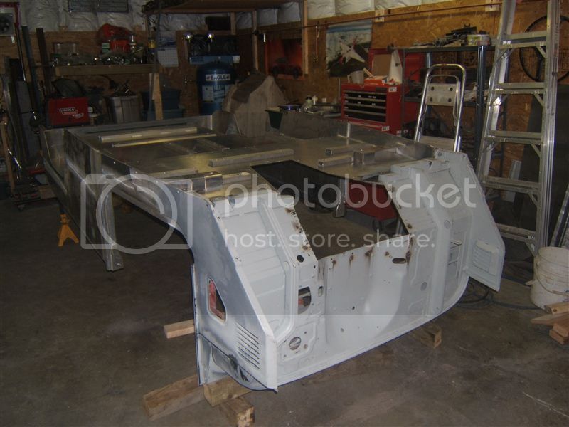

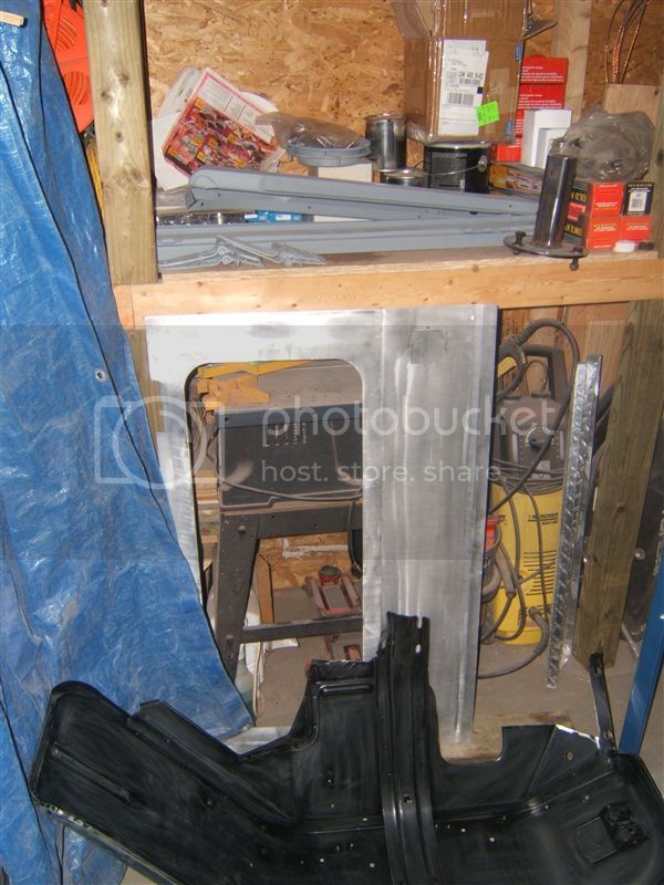

I know how much everybody likes pics so here are few of where things are today (not very exciting)
Note: stock light in custom bumper and stock fuel filler (stock door will be used also).
Note: my new to me sandblasting cabinet has been real busy
Note: A pile of parts that ready for paint. Also in the pile, everything I need to rebuild both axles, my rust bullet paint and my OME shocks.

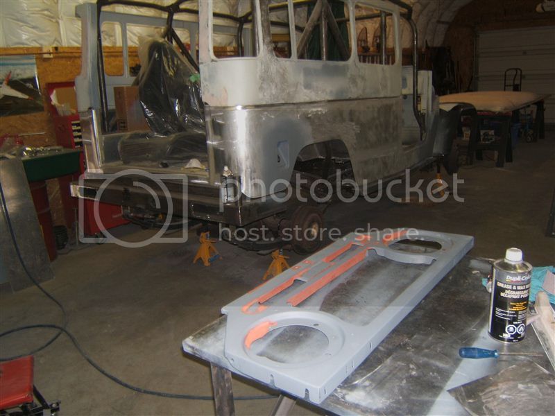

Quick update - lots of pics
Still progressing. I have a deadline now of early May next year. We ordered ourselves a new travel trailer and the 40 has to be ready to tow.
Right now it looks like the 40 exploded in my garage ;)

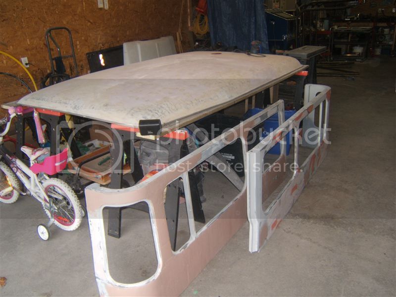

Hard top and sides are about 70% ready for paint

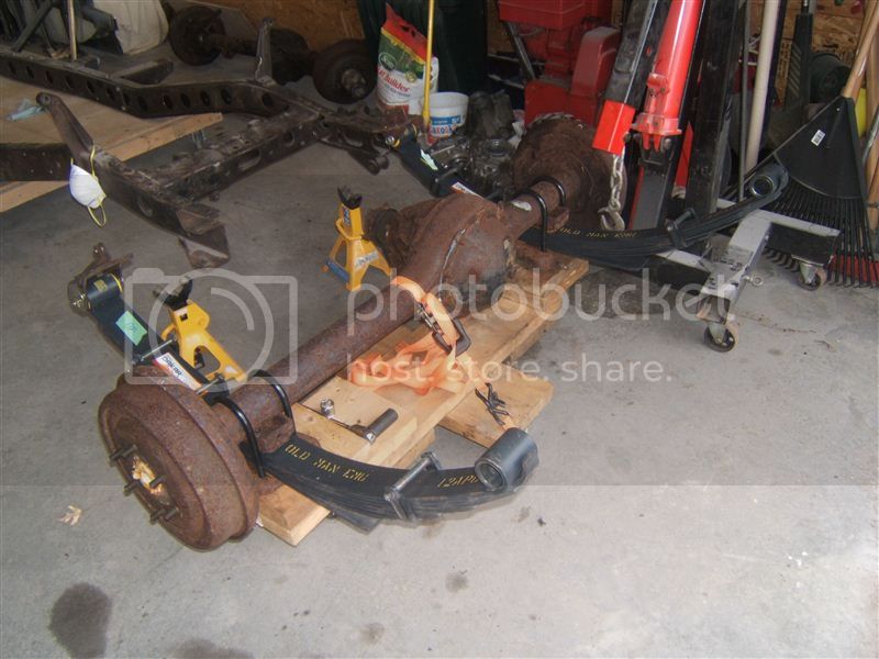

Rear axle out and ready to get torn apart for paint, re-gear, disk brakes and maybe some poly performance axles and a locker

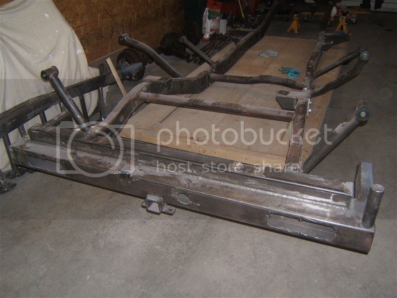

The frame showing off the 95% complete bumper and the 6 cage to frame tie-ins.
Rear Aqualu tailgate with storage I added and a recess license plate holder.
