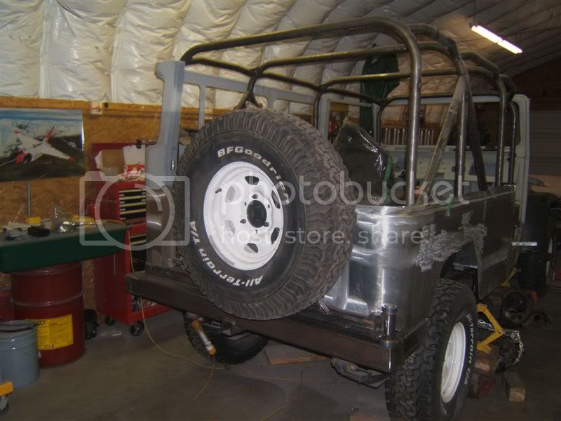

I've gotten the rear hatch completely done. Using the Aqualu hatch was interesting. Didn't install it quite like they recommend. I cut open the sheet metal and welded in some 1/4" plate and then drilled and tap for the hardware. Did this both for the shock and latch and the hinges.

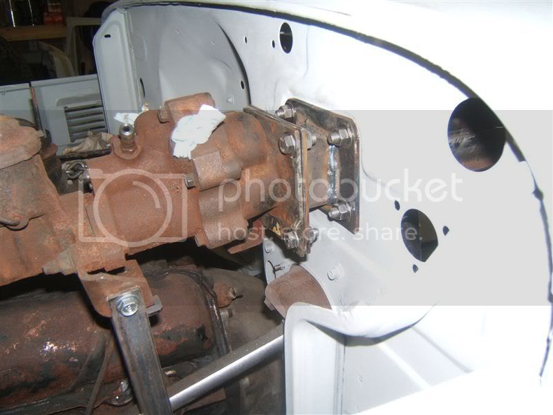

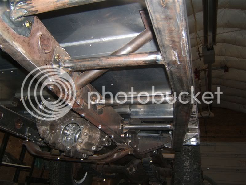

I also got the 60 gear box installed. Trusting IPOR on this one and decided to notch the stock shock tower. Added some iron angle on the back side to re-enforce it all.

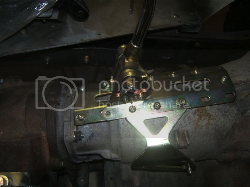

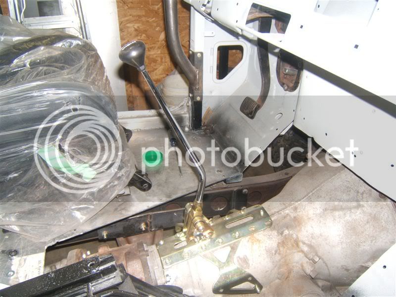

Got the Lokar shifter installed for the 700R4. Was a bit of a PITA because the bracket wheres not made to go with the 203 stock adapter so had to take off both the splitcase and 203 to get thru bolts installed so I could use a nut instead. With the shifter installed I'll be able to start working on the sifters for the t-cases.

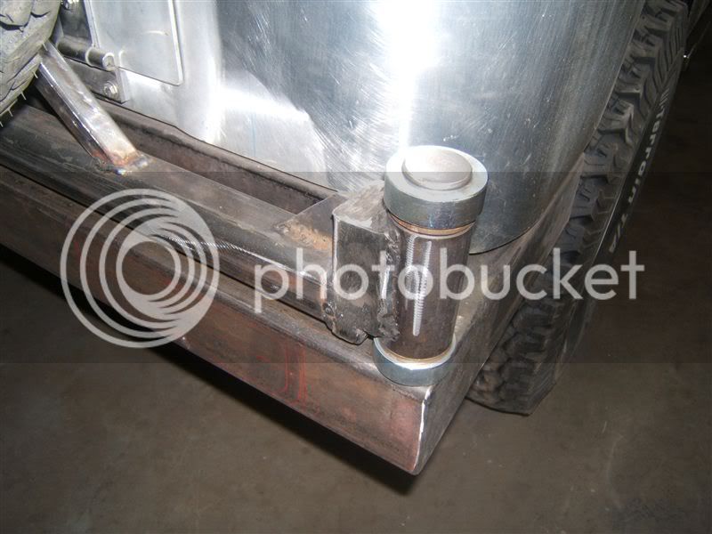

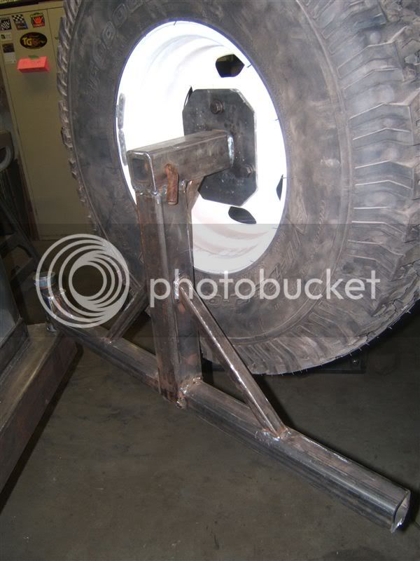

Also got the tire carrier built. Still need to add a latch. With this done, the rear bumper is almost done, just got to get the lights installed and some brackets for the trailer safety hooks.

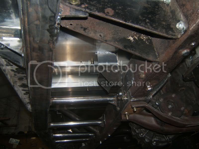

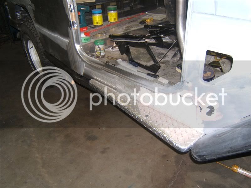

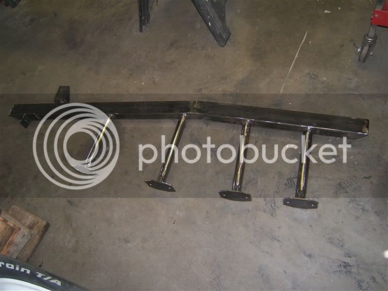

I've also started working on the rock sliders. The passenger side is done and the driver side is almost done also. Decided to go bolt on. With my frame being bolted together, I'll be able to add another plate on the inside of the frame. Also wanted to incorporate an original looking step.
While working on all of the above, I've also been working on the body work. So if I can keep up this pace up, I should be able to get this thing to paint by the end of summer... Here's hoping plans don't change.
