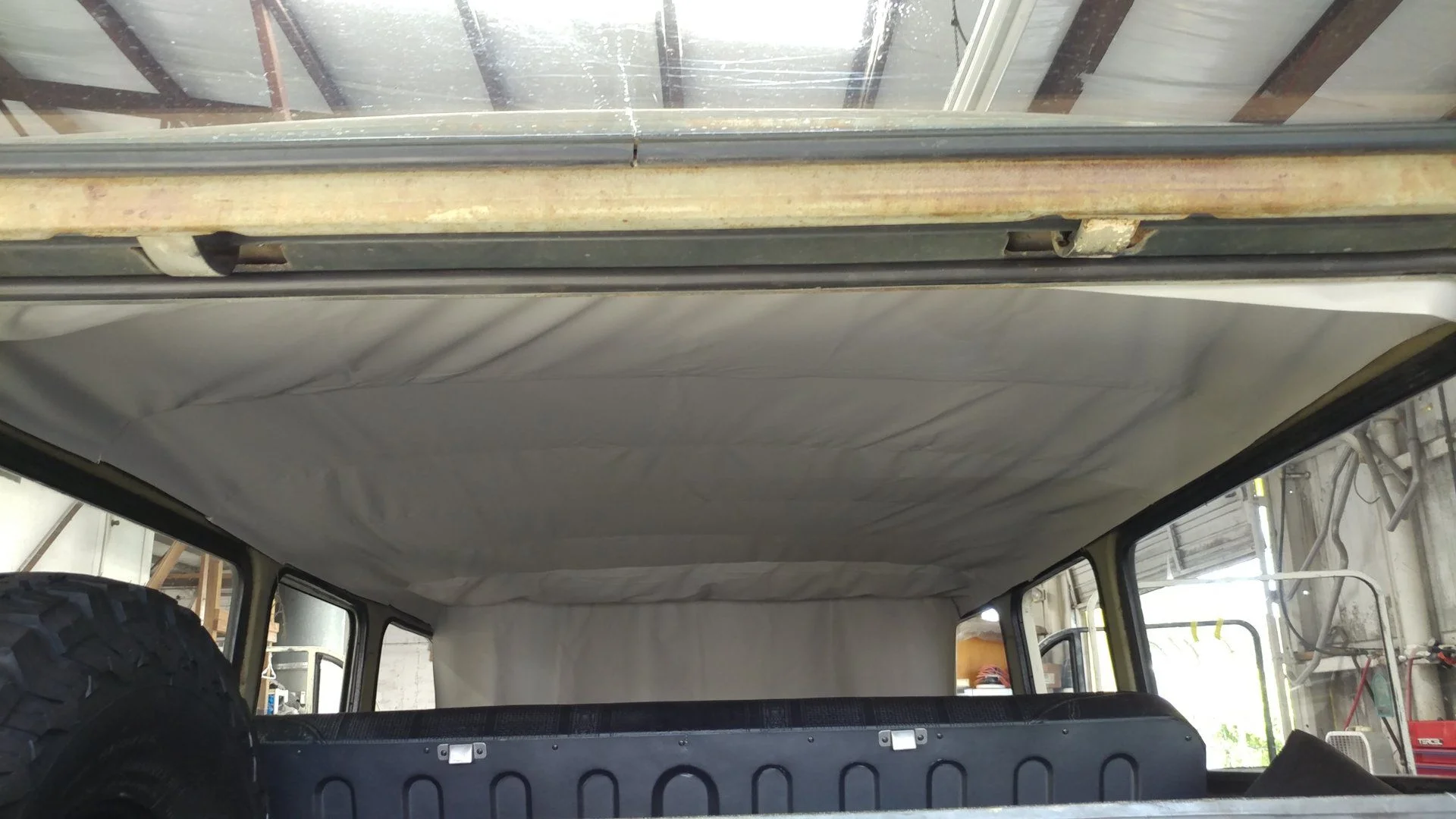

This week is headliner and door panel week.....I had an old SOR headliner that came with a different truck I bought and sold. Had to order the new SOR headliner trim/install kit. Glad I did because without it, it would have been difficult to make it all work since I have no wood left to mount the headliner to.

One door panel done.....

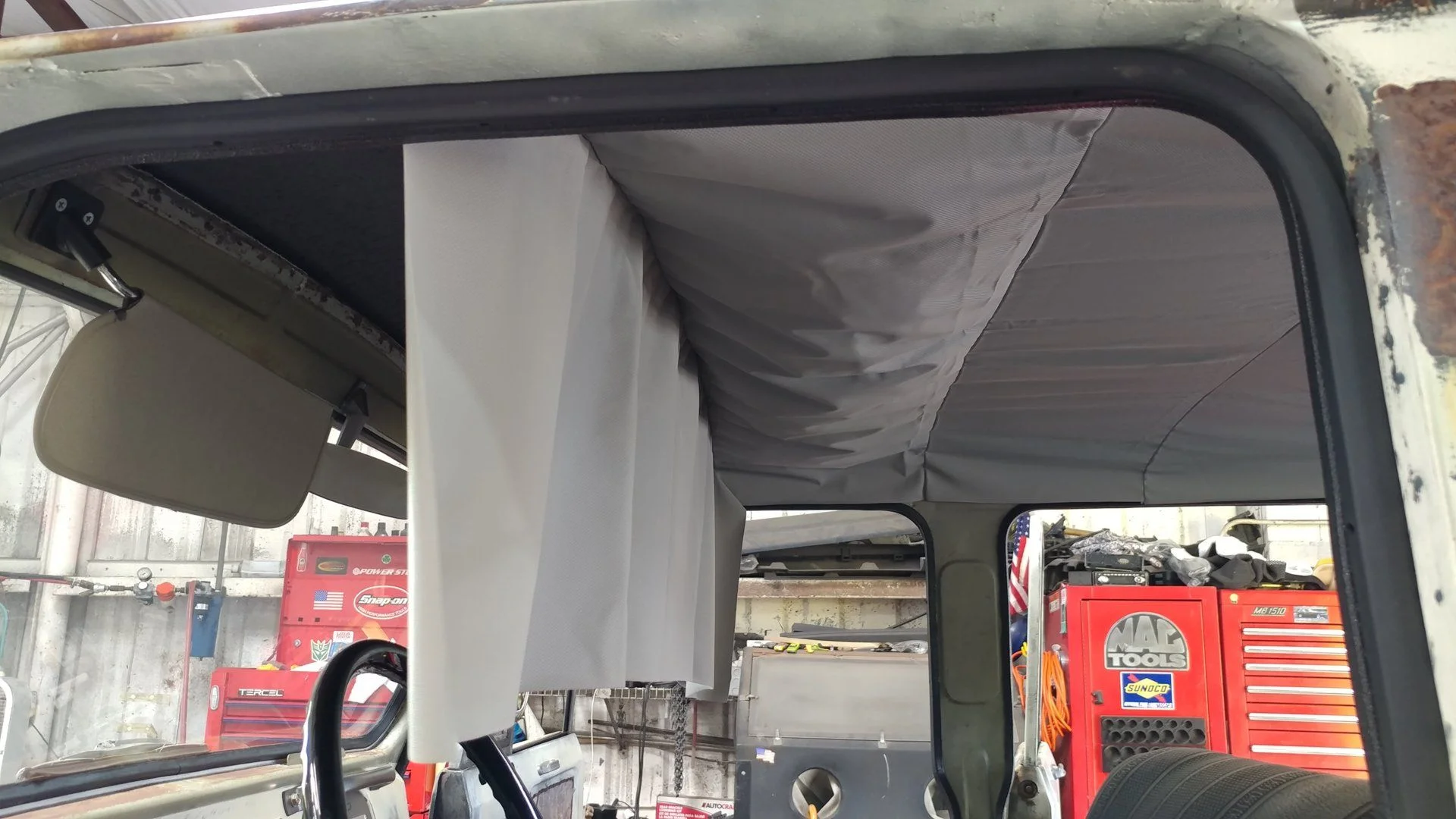

Interior guys finished up late in the day yesterday....they did a good job. Could be better in a few areas but for the most part, it's really nice. I'm kind of dreading to see the cost of the install.....when the owner of the shop gets involved, it gets pricey. Looked like a ton of work stretching, gluing, trimming, drilling, stapling, etc.
They kept insisting that they wanted to use wood strips to make it all work(to lock down the headliner material against the metal)......I kept telling them I didn't want exposed wood up there. They never though this setup would work...glad it did.
I will say that the quality of the SOR headliner(this was an old one) was kind of crap. The stitching for the pass thru areas for the rods(unsure of the technical names) were not stitched very straight. The guys struggled getting them in there.
It REALLY helped to quiet down the inside too....not sure what that is all about but it's very different to drive. We sprayed the underside of the roof with very heavy coats of thermal and acoustic Lizard Skin so I know that helps but just that thin layer of material did something. Kind of weird.
Close up of the welting/finishing trim. There are 2 components here.....the top one(with the stitching) covers the one under it which is drilled onto the truck. It has a piece of nylon sewn into it(1/8" thick by maybe 1/2" wide) as well as a piece of cording to make the welting....the finishing piece is then stapled to the nylon. The staple is hidden in the tiny gap in between the stitches. Pretty cool setup.

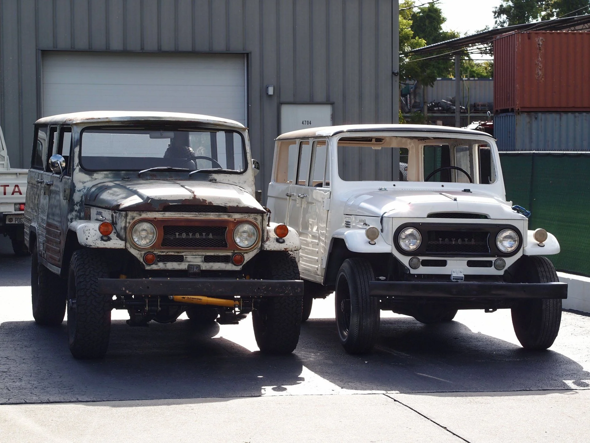

Said goodbye to my project LV over the weekend so I can make way for another LC79 build......would have liked to have kept it but one is plenty and it's going to be hard to top the patina LV I think. Patina is a keeper.
This truck is headed for a VERY cool build by a really capable group. Hopefully the new owner keeps me updated on it....it would be a fun one to watch.
