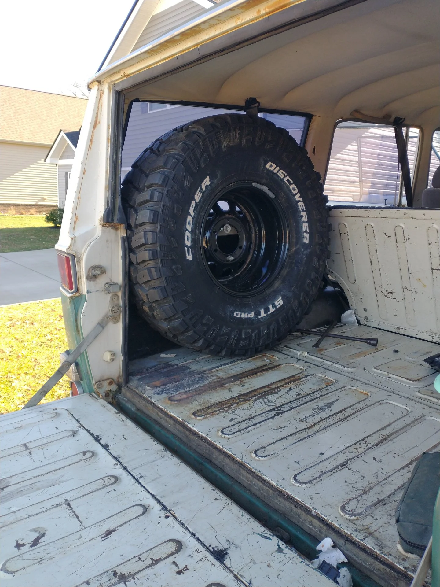

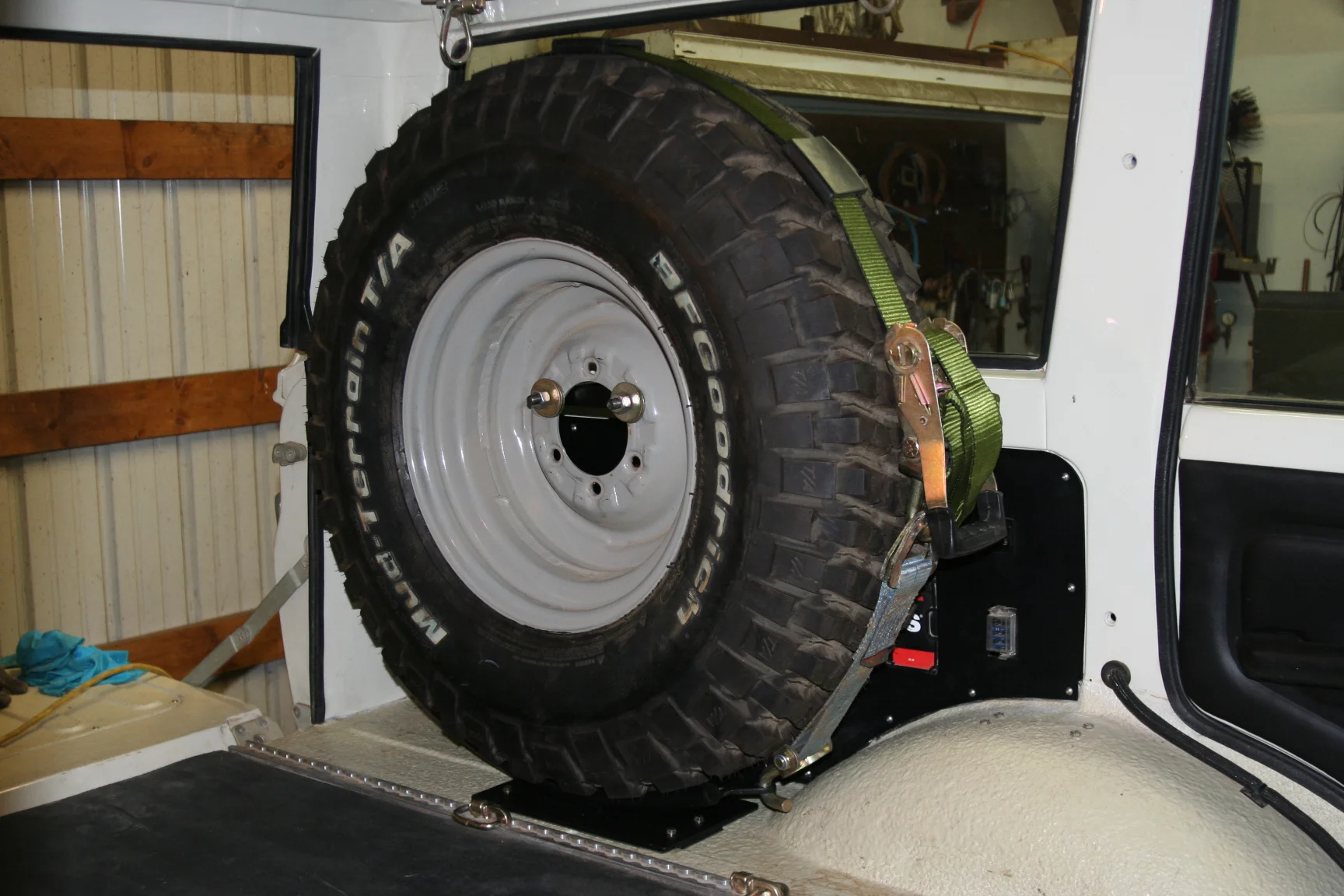

I found it to be out of the way enough to use the rest of the floor space. Spare tires are a pain no matter where you hang one, but for me, I wouldn't leave home without it.

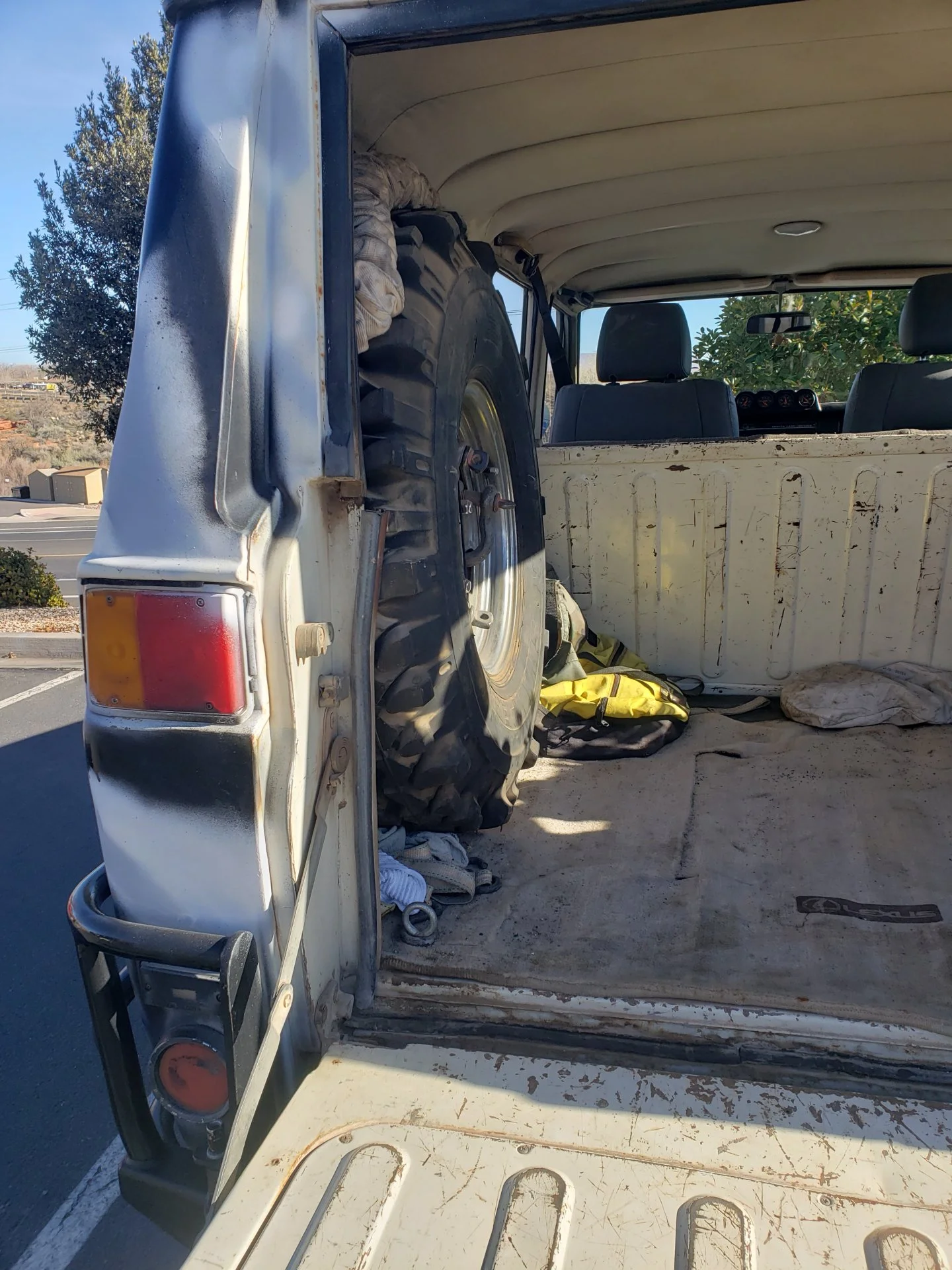

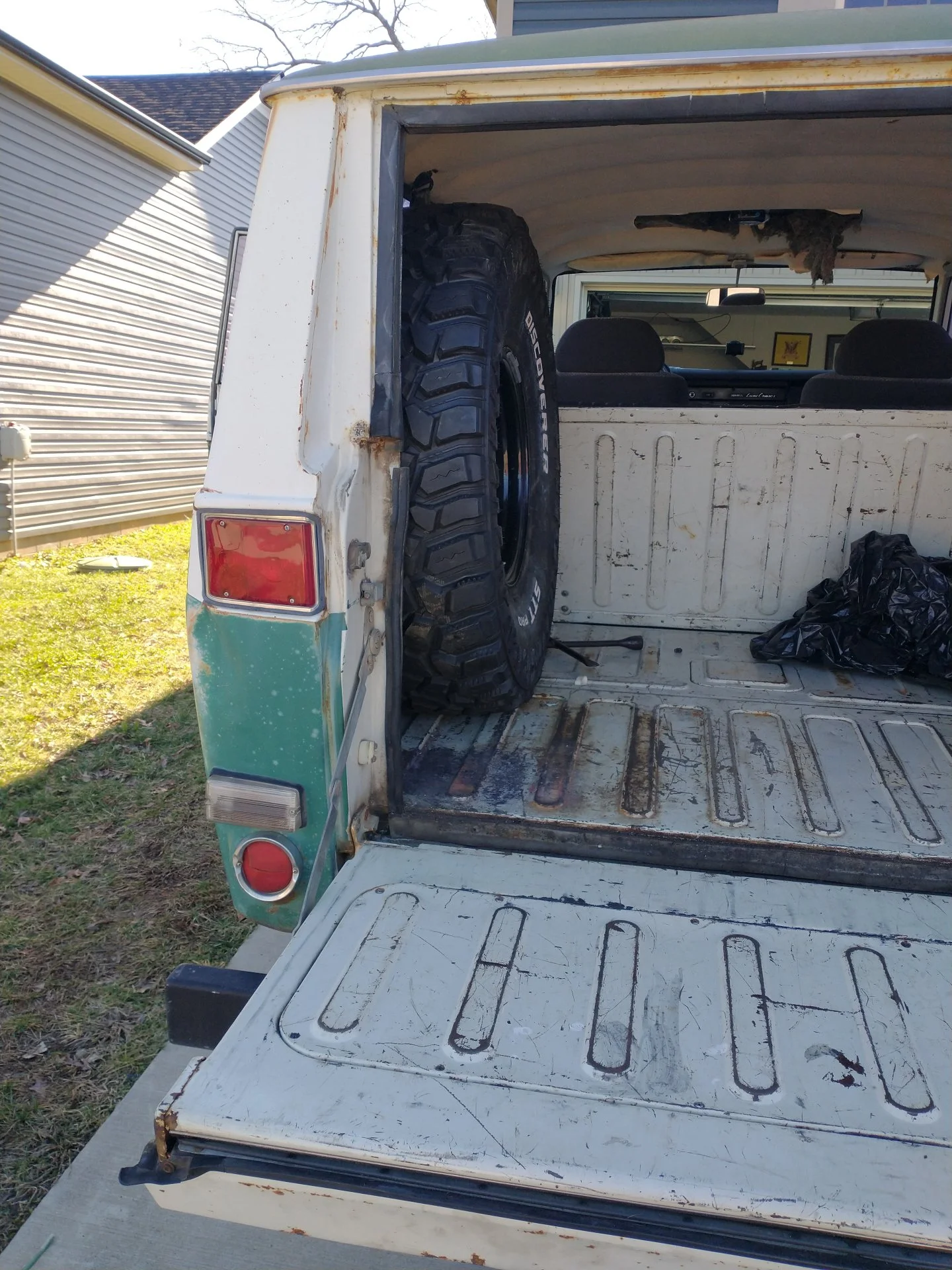

A little bit of head scratching and flipping the tire around allowed me to modify the lag bolts enough to mount a full size spare inside.

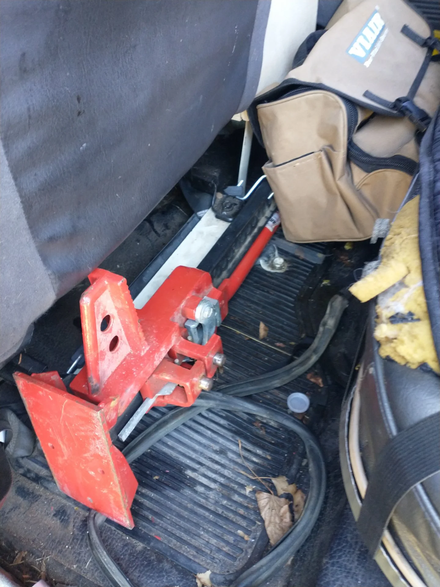

Farmer jack fits "perfect" bungeed to the back of the front seats, and even allows for people to sit back there. Gotta clean everything up once the weather warms a bit.
