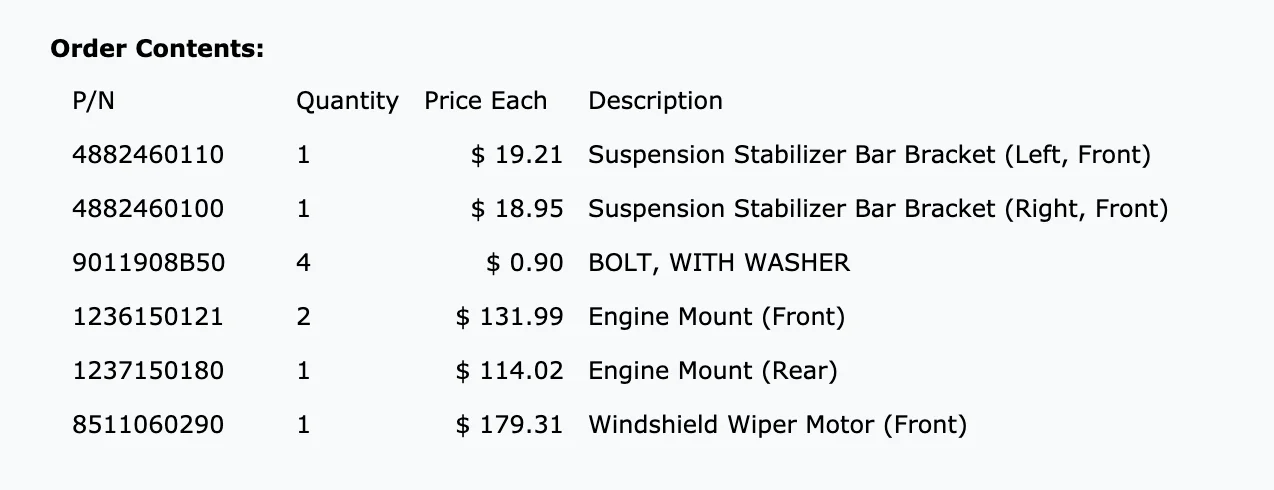

Motor mounts
Thanks, man, the OEMs currently 130+ each, a little pain, so I need your inputs like that as a "pain release..."

Order done:eek::bang::flush:
By the way, they just call me said that for 2004 LC100 the wiper motor part number is 85110-60300, 5 dollars more...

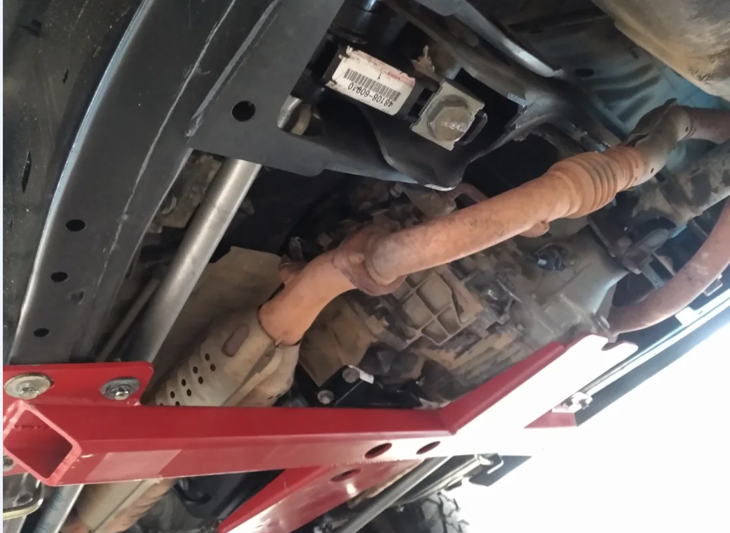

Thank you. On the transmission mount, does the transmission need support when the cross member is removed, I would think so. Just making sure I have everything available when ready to get this done.
I’m wondering the same thing.I think the FSM says to put a 2*4 on a jack under the trans pan to support it when you take off the cross member. Is that right? Is the pan strong enough to support part of the trans weight?

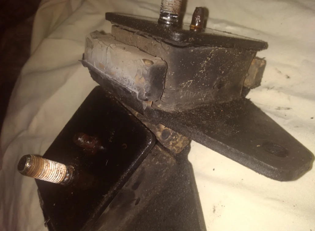

My mounts looked like this at 186k miles.
Hint of advice on swapping them out and back in. Disconnect and replace one side at a time. I made the mistake of disconnecting both sides first, then raising the motor which required lifting the motor higher than necessary to remove the mount. This caused the fan blades to run up into the radiator fan shroud. Thankfully no significant damage but could have been easily avoided if I paid closer attention to directions.
Maybe it will be obvious when I do this, but you said do one side at a time but I am trying to visualize how, if you are lifting the engine from a central point (under the oil pan), it won't raise both sides at the same time? Im having a hard time explaining it though.
Raising from a central point underneath ( bell housing) with one side unbolted, it will lift that one side enough to pull the mount out. It doesn't take too much lift.
