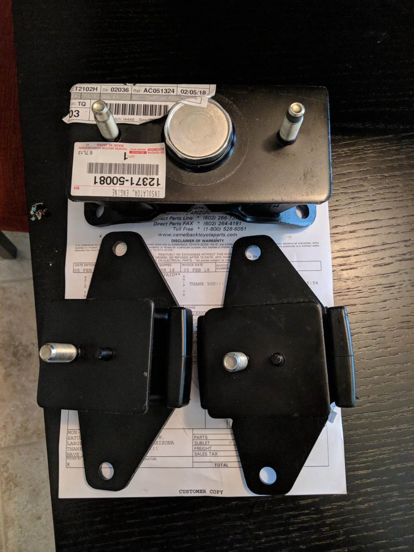

They are expensive. Too much money IMO for what they are . I bought all 3 for close to $300. Going to try to install today.
Not too expensive if you remember a new cruiser runs for $60k back then and not a cheap vehicle. You are driving one of the most reliable vehicle made, so she deserve a little love Try the motor mounts of a Bimmer or Benz then you know cruiser mounts are cheap and last much longer.

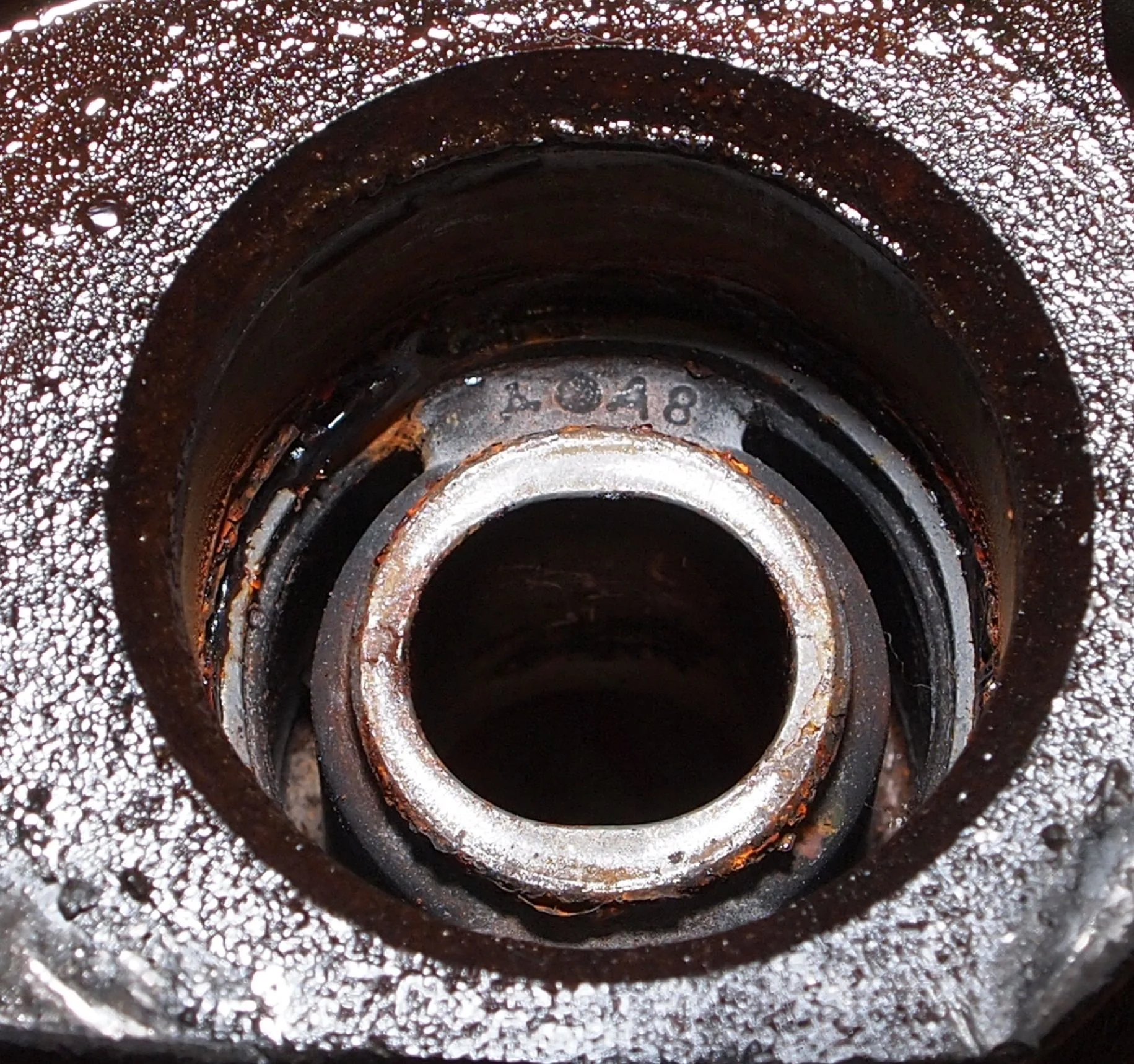

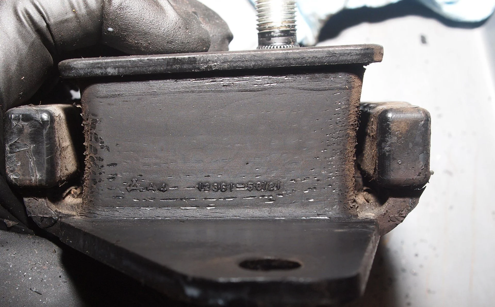

@abuck99 can you decipher these markings before the part number. Looking for clues to rubber and manufacture.
Also these for steering rack mounting bushings
Not sure what those marks are. Maybe some factory identification proof stamping and possibly the shore hardness or durometer of the rubber. From the brief search I did on motor mounts in general, that the average rubber durometer is around 40-50 on the hardness scale. The A may be shore scale A, and the 4 may represent 40 as it relates to hardness- but that is pure speculation.
Thanks, is my speculation as well. Was hopeful the symbol to left gave clue as to manufacture, but probably world standard symbol. With engine mounts we can get OEM.
But as you know we can't get the rack mounting bushing. The rubber rack mount bushing I did find have no markings. I'd really like to find OEM manufacture.
