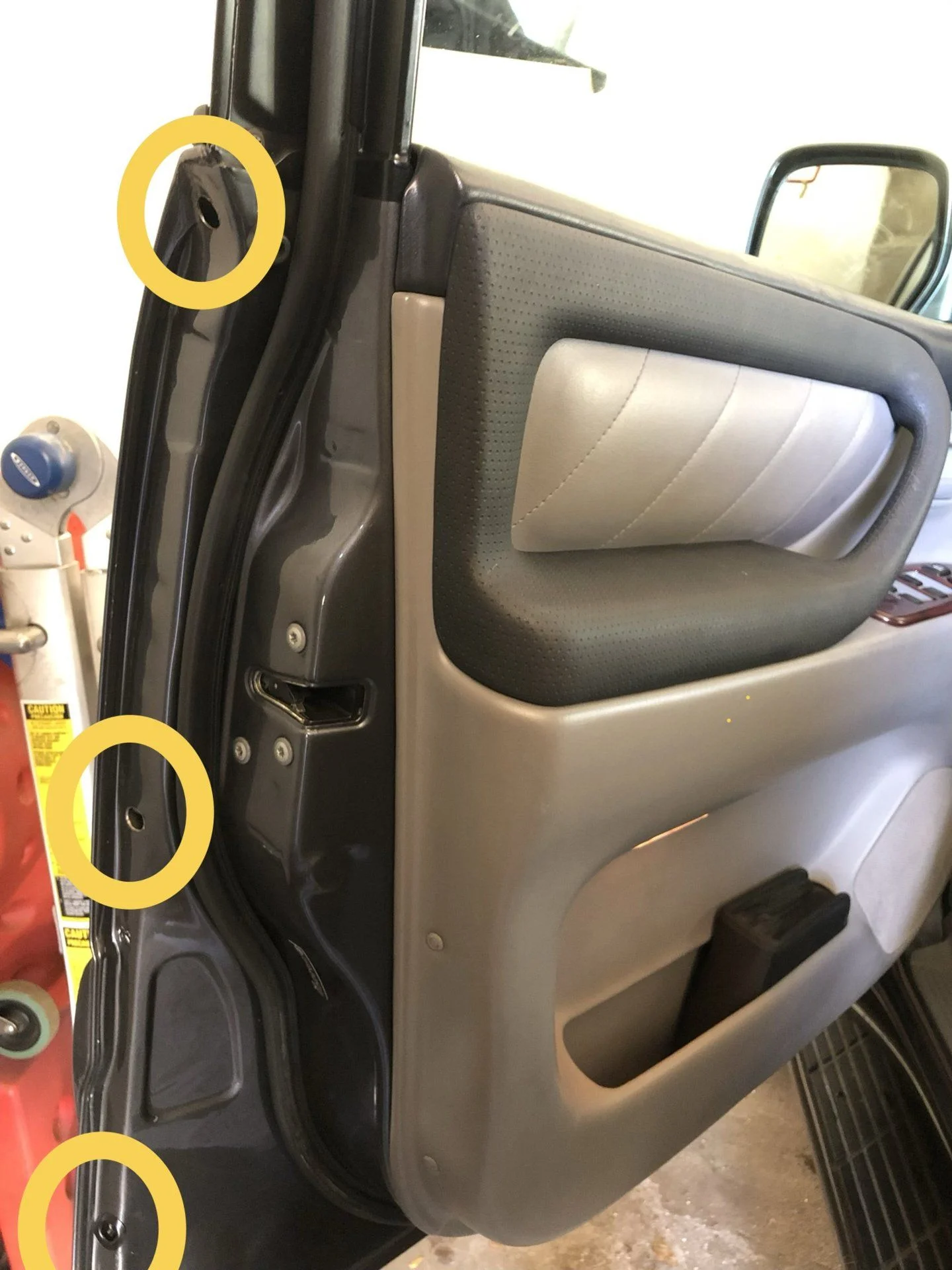

Figured I would add this here, I’ve just ordered most of the seals I need, thanks for the list everyone. In the process of checking out what I needed,
1929819
I noticed this... this is driver front door, passenger front has none of these holes. If you notice, the bottom one is capped off. Can someone tell me what this is for and possibly refer a part number for the plugs if that is what is needed? Thanks!
