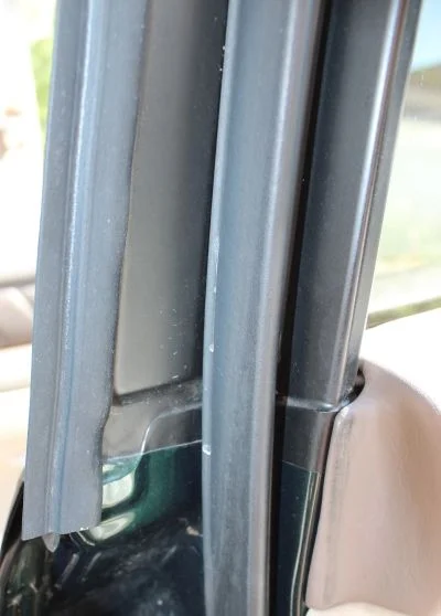

Just want to share that I bought this generic rubber seal (Ebay purchase $3.57 4M Good Quality Rubber Seal Weather Strip Fit For Car Motor Door Z Shape HEL | eBay) to seal the top part of the door leading edge. It works pretty good in combination with the OEM lower leading edge (part 67896-60020 and 67895-60020). Wife even notice that the LC is quieter (a big win here :clap:).
Since I do not have any way to measure the sound, I am going to drive around a bit to get used to this, and then will add a generic bottom door seal - will update here when I do this. Lets see if the wife will notice the changes. Here are some close up pictures of the seal.

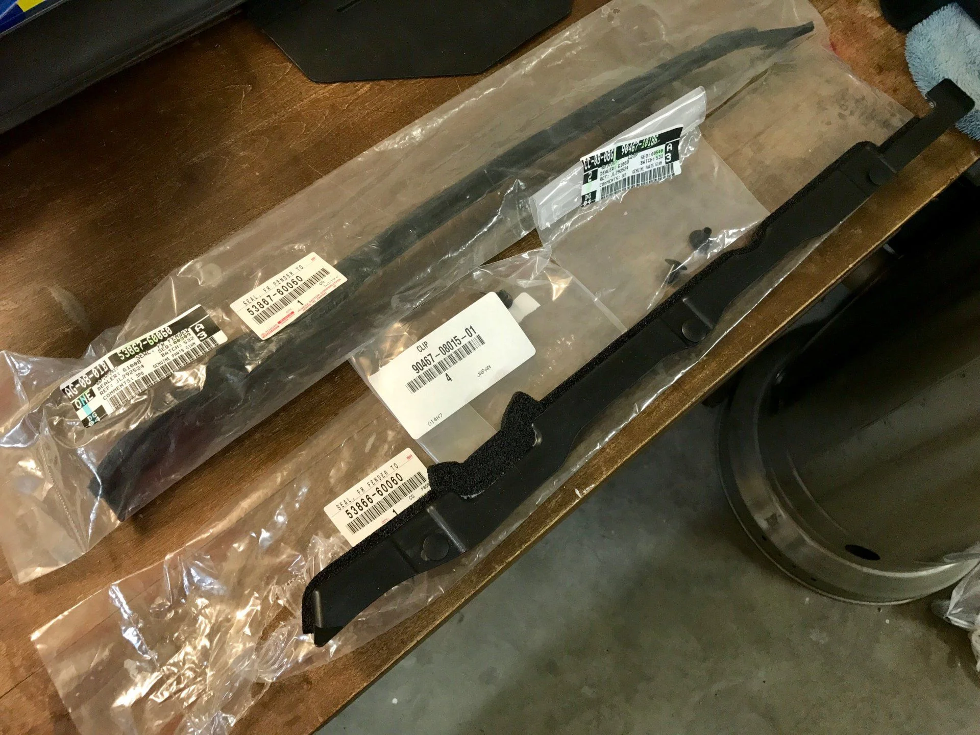

Let me know what you guys think of this, the way it looks to me is it's the front fender seal we've been looking for but I could be wrong
Possible wheel well seal??:
Part No.: 53867-60060
SEAL, FRONT FENDER TO COWL SIDE, LH - $25.01
Part No.: 53866-60060
SEAL, FRONT FENDER TO COWL SIDE, RH - $25.01
Part No.:90467-10186
CLIP - $1.46 (qty.2)
Part No.:90467-08015-01
CLIP - $0.68 (qty.4)
Did you ever install these and are these the right part numbers for the front fender seals @TheForger?
Negative, I have not gotten around to it yet. I meant to install them before I left for Colorado but all of my higher priority mods and preventative maintenance "to-do's" took up too much time. I will be home the 16th and I plan on starting it then.
I went ahead and placed an order for the parts and quantities I listed in that post. They should be on my porch when I get home so I will update this thread once I get them installed.

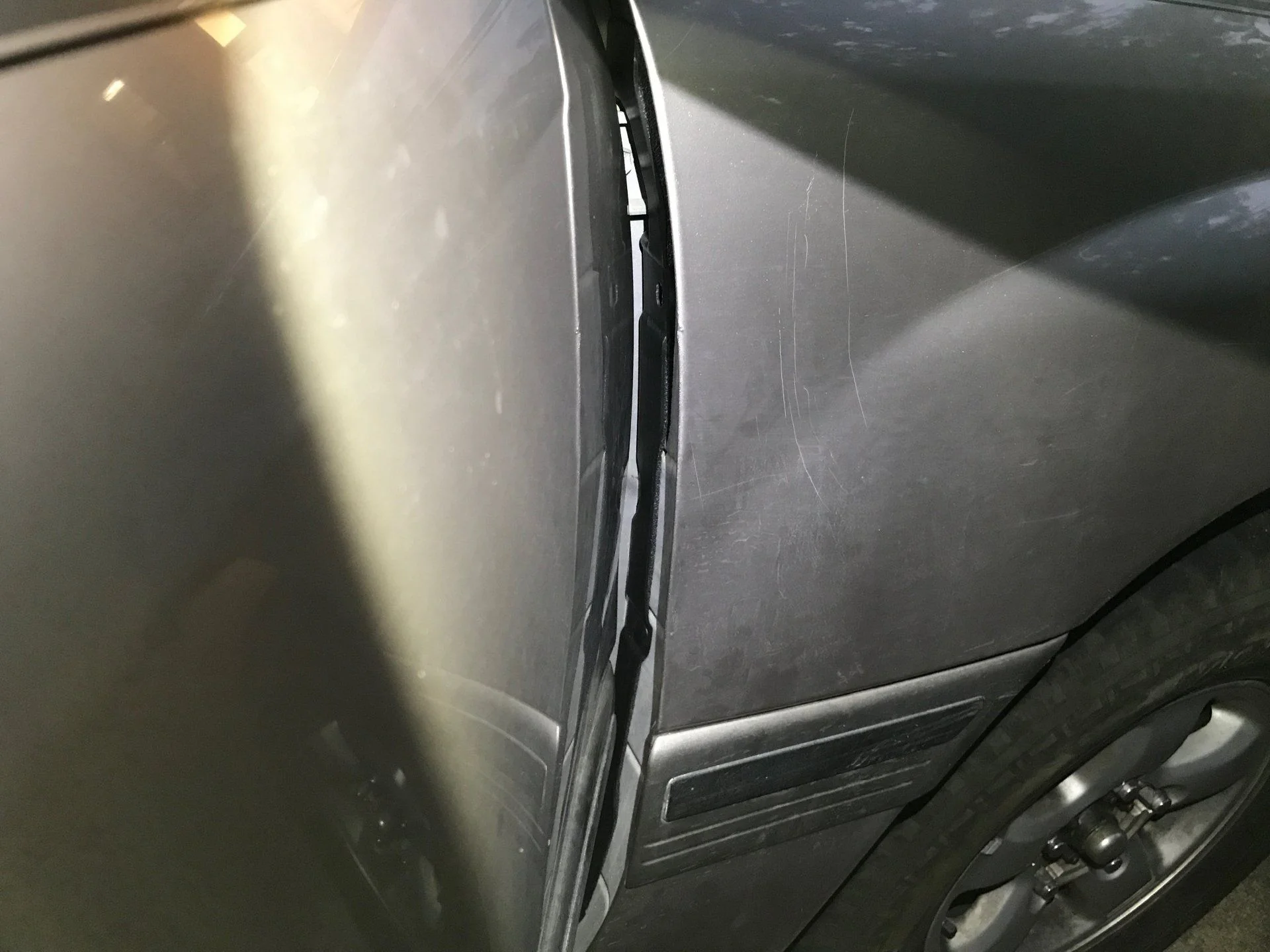

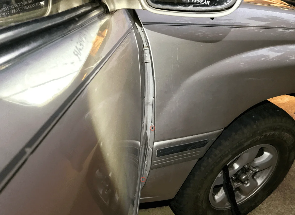

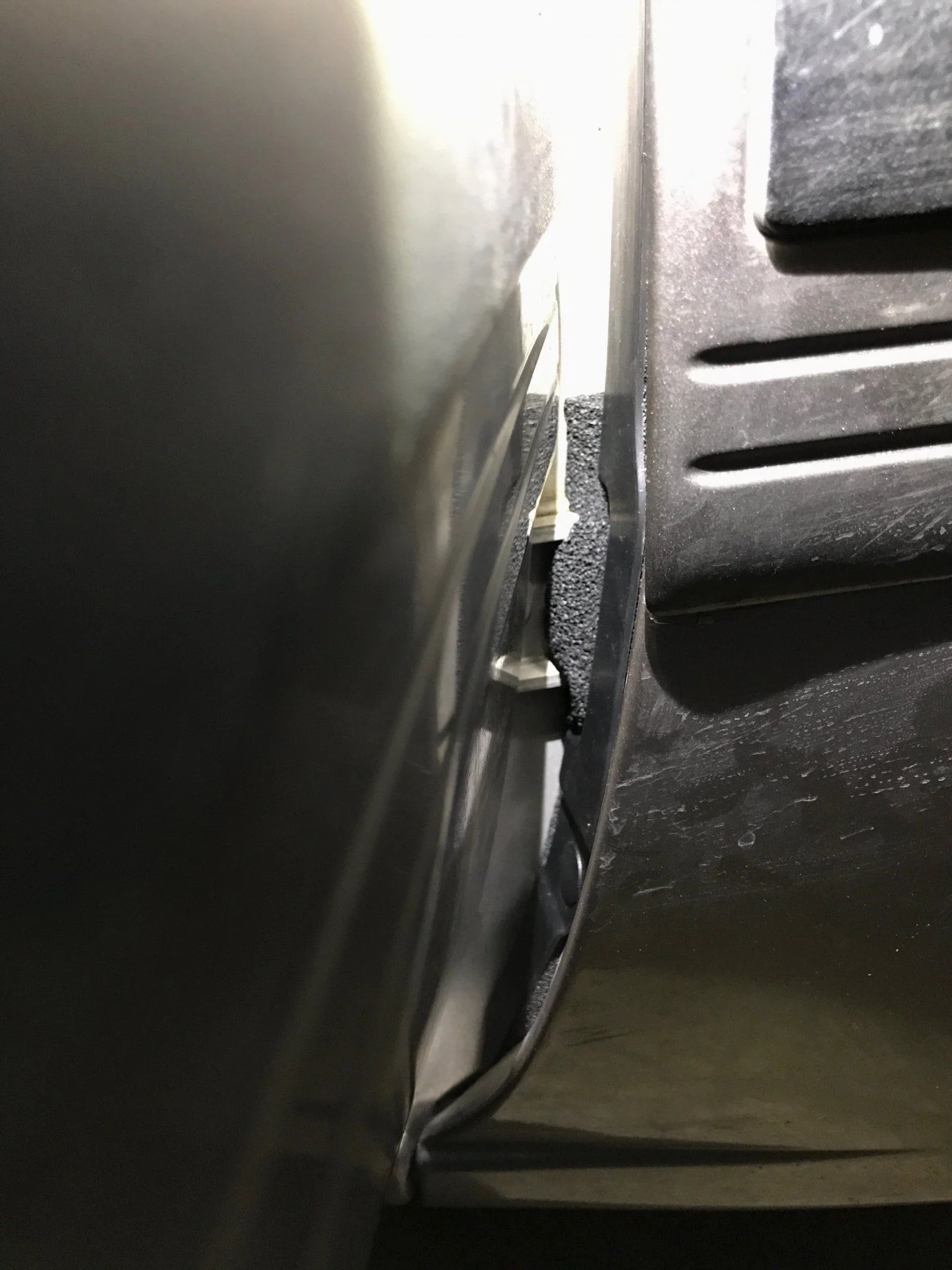

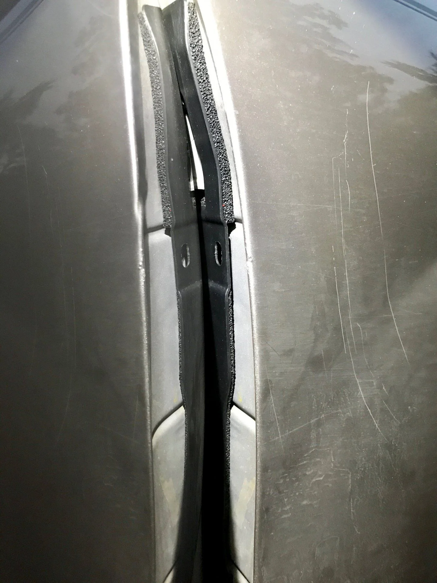

I got the fender-to-cowl seals in today and installed them both. A few notes about these: (1) the additional clips are unnecessary because the seals come with them already; (2) on my 2000 LC there is no hole for the top clip to fit into, so I had to run it without for the time being. I may go back and add some double-sided tape where that clip would be to stick it to the fender, but unless you take the door off there is no way you will be able to get a drill back there to make a hole. I assume the later models that come with the seals already have those holes in the fender. Other than that install was fairly easy. You do have to monkey around with them a bit to make them fit between the door and fender while the door is partially open, but once you get it back there snapping it into place is easy. Looking at the design it really seems like these should make a difference. Keyword being should...there is an open-cell foam that lines the backside of the weatherstrip and it makes a nice seal where the body transitions into the fender (there is usually a gap here). Hard to explain and hard to get quality pictures, but you will understand if you see them in person. I will give me opinion on road/wind noise tomorrow when I drive it.

Before the seal, the two holes are circled but as you can see there is no top hole

I may put some double-sided tape where the hole is to keep the top part in place

The foam makes a nice seal around the door hinge as well
