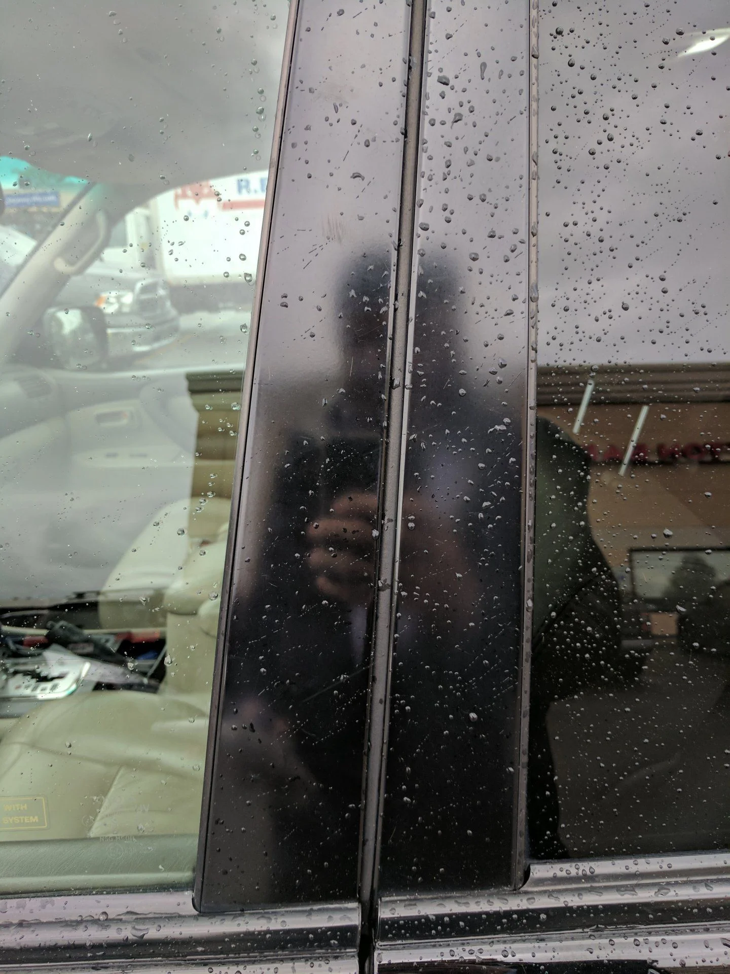

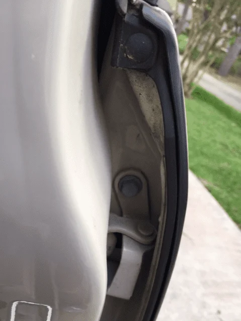

One observation though. While I was looking at the pictures and comparing to my 04 LC I noticed I have an additional weatherstrip that goes between the crack on the B pillar on the top half. I was curious about where to drill the hole and it seems I already have it and the pin is already in place holding the bottom edge of the top half of the stripping in place.
67896-60020 and 67895-60020 combined with what's already in place will essentially seal this door gap from top to bottom.

Great catch! I haven't seen that seal before, and it came stock on your LC?? That's interesting I wonder if any LX's have that one. Could you do us a favor and snap a pic of where the strip ends at the top of the door at your next convenience?
Yep, 06 LX has it, and it was overlooked (or assumed part of the lower piece) last time I was taking pictures.
Anybody got the Toyota part# for that?
06 LC has this as well. I have been following this thread and planned to take a picture at lunch, but @n55luvr took care of that. i had noticed that I already had a hole where the lower seal retaining clip would go.
It would be nice to see a picture of the newer LX with both seals in place to see how they align from the factory. Maybe it is obvious, but which goes on top for those who want to add the lower seal.
Thanks to all for the input.
Wow I guess it was overlooked I did just assume it was part of the lower seal. Guess we have another to add to the list!

Judging from the pic in @jLB post on pg.3 (quoted below), it appears the bottom seal goes beneath the top one at that clip

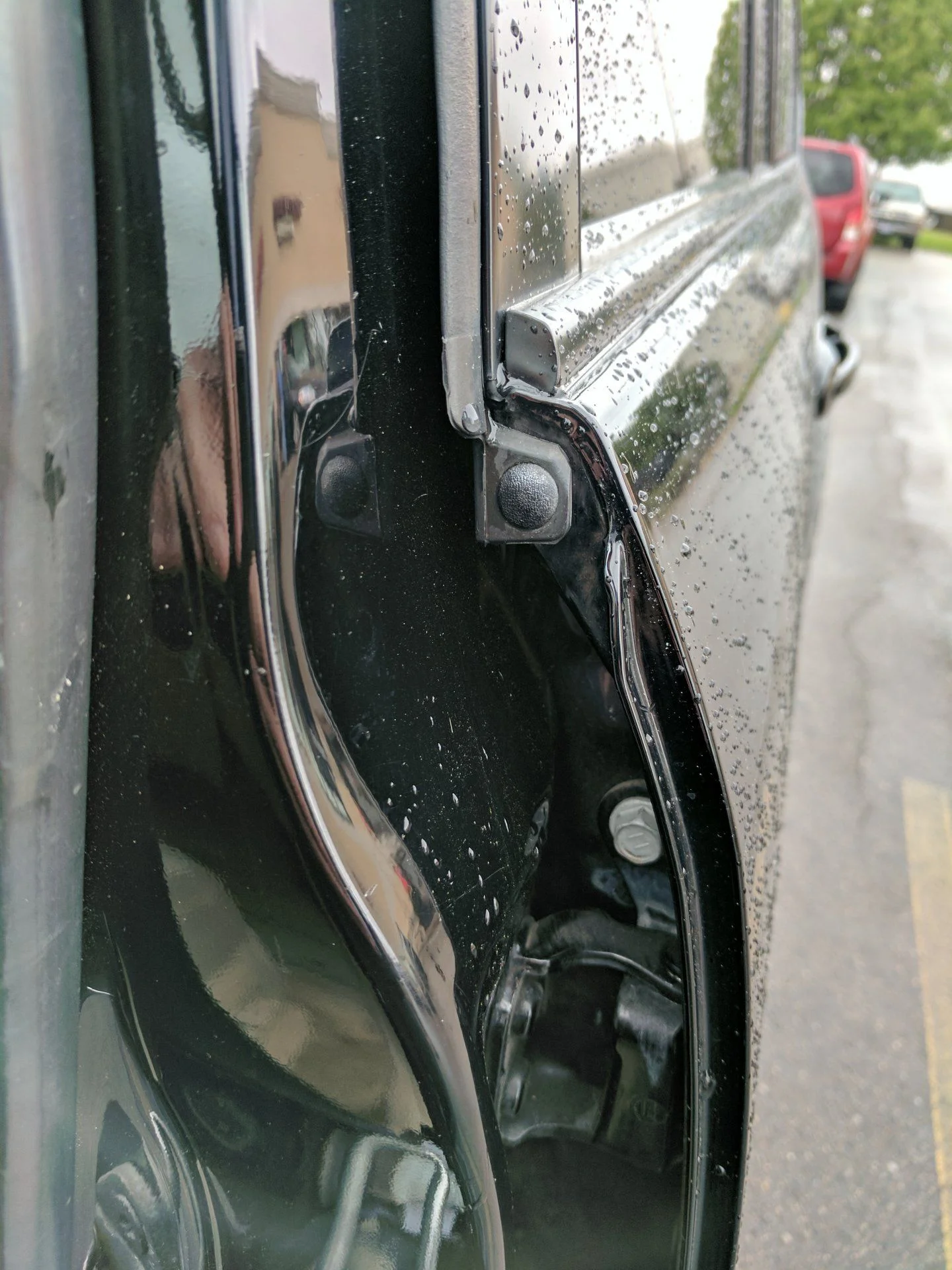

The plastic piece in the rear of the front fender is near impossible to get a picture of, I get a glimpse of it with the door just right, and I can stick my hand in and feel it, but the leading edge of the door obscures it with the door open, and there is nothing to see with the door closed. Let me see if I can figure a way out to get some kind of picture.
Showing the leading edge of the driver's rear door:

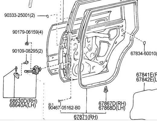

I'll confirm tonight but I think it's part of the stripping that goes around the entire door.
6787160080 (RH) and 6787260080 (LH)
Even uses the same clip pn - 90467-05162-B0
Interesting, according to the diagram you appear to be correct. But according to my head it's hard to believe that Lexus would charge $10 for the weatherstripping that goes around the entire door:confused:
EDIT: I just checked order records and the comprehensive parts list I posted on pg.5, the pn's 67896-60020 and 67895-60020 are what's already in place - the lower leading edge strips of the rear doors. From what I can find the pn's 67872-60080 (LH) & 67871-60080 (RH) are strips that go around the entire door.
Right. All 100s probably had the weatherstrip that goes around the entire perimeter but at some point they decided to fuse in that second strip that would fill the top gap between doors. Not sure what year that changed. These look to be about $45 each.
Edit: I pulled up the parts diagram for a 98 and it called for the exact same pn which would include the fused part that fills the upper door gap. Odd indeed.
My 98 do not have that top or bottom part that fills the upper door gap. So to get the top part, I have to change the weatherstrip around the perimeter, right?
Yes that appears to be correct from everything we've seen so far. I don't think it would be too hard to switch them out I might give it a shot, I looked at my stock weatherstripping and its just held in by clips every 8" or so.
