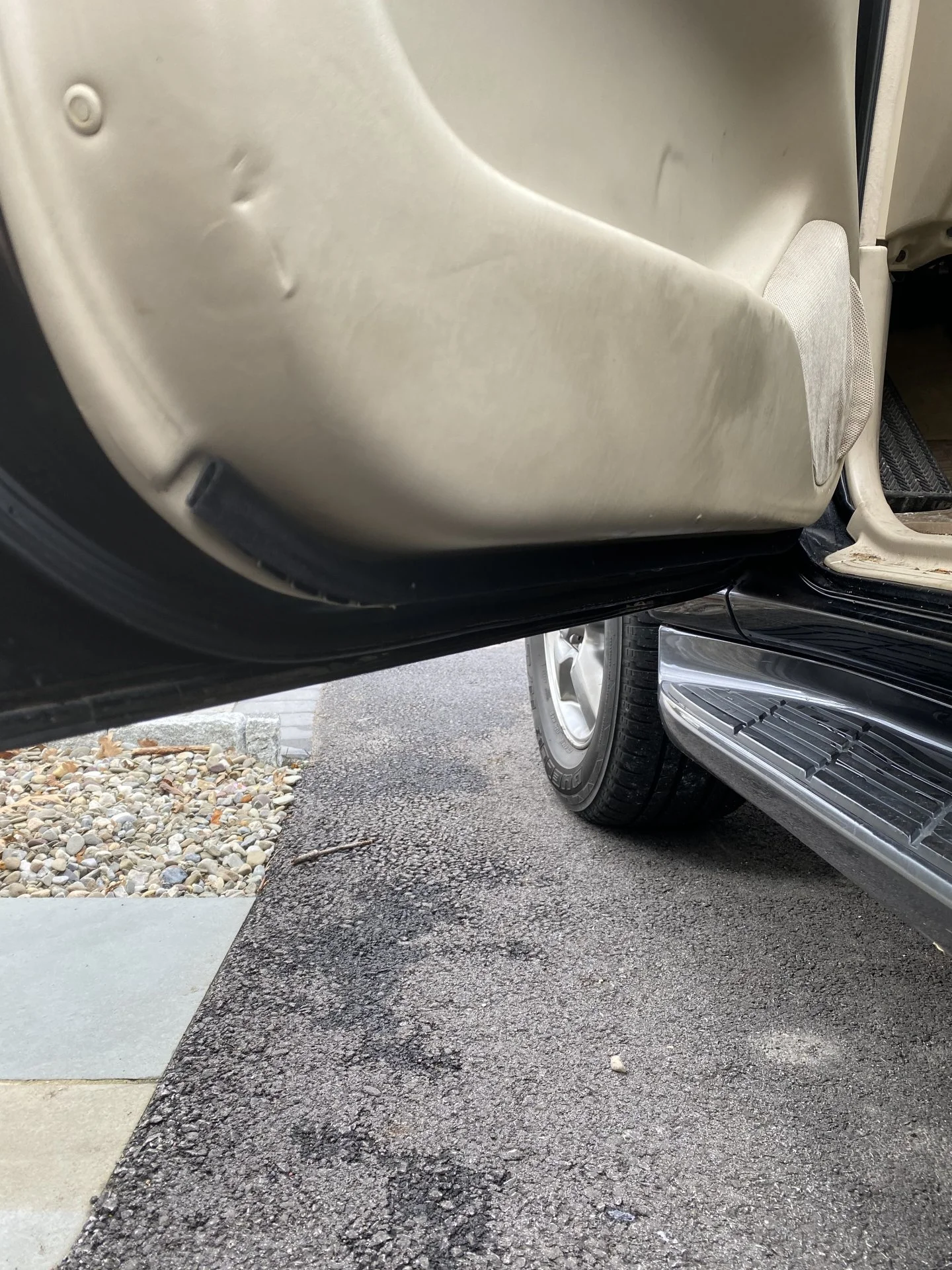

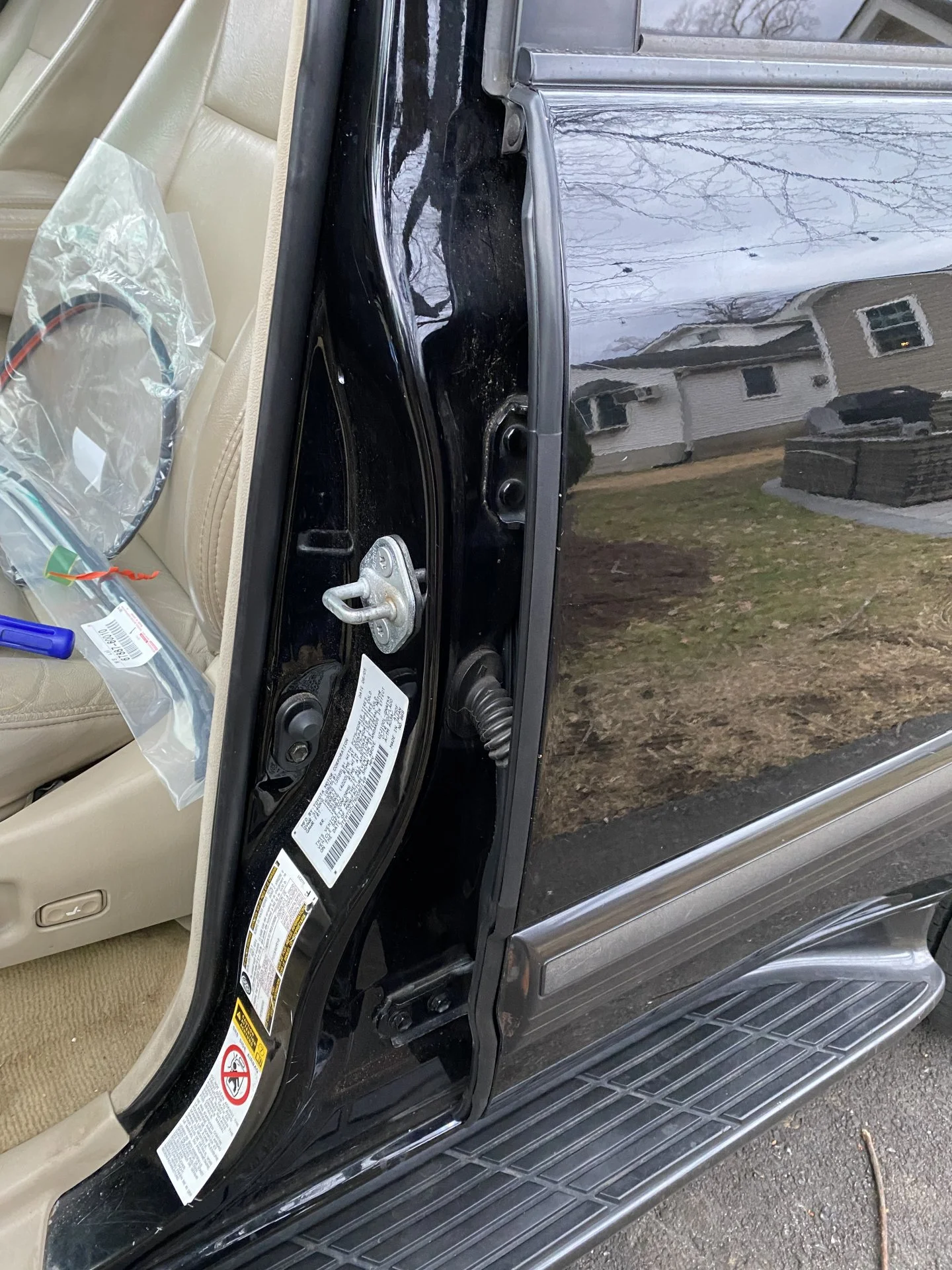

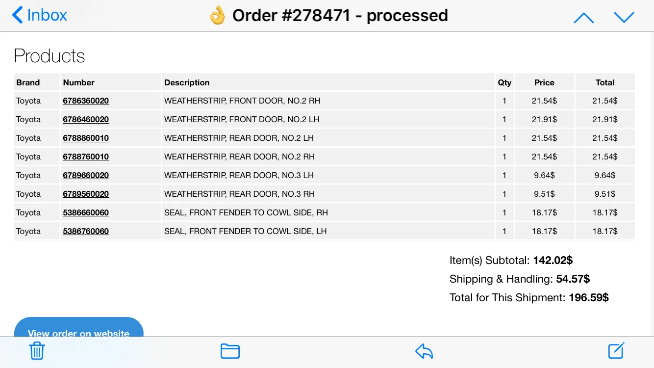

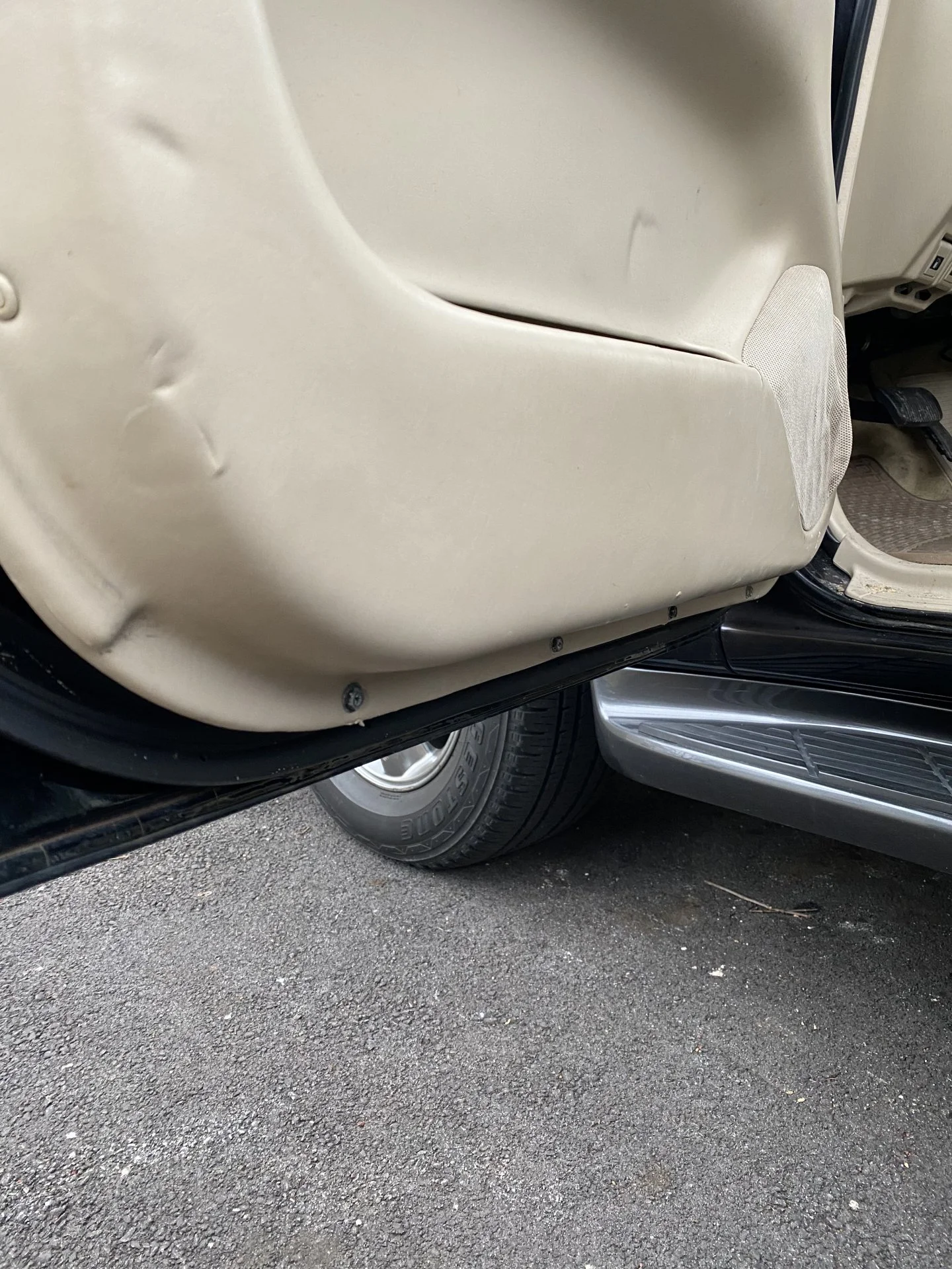

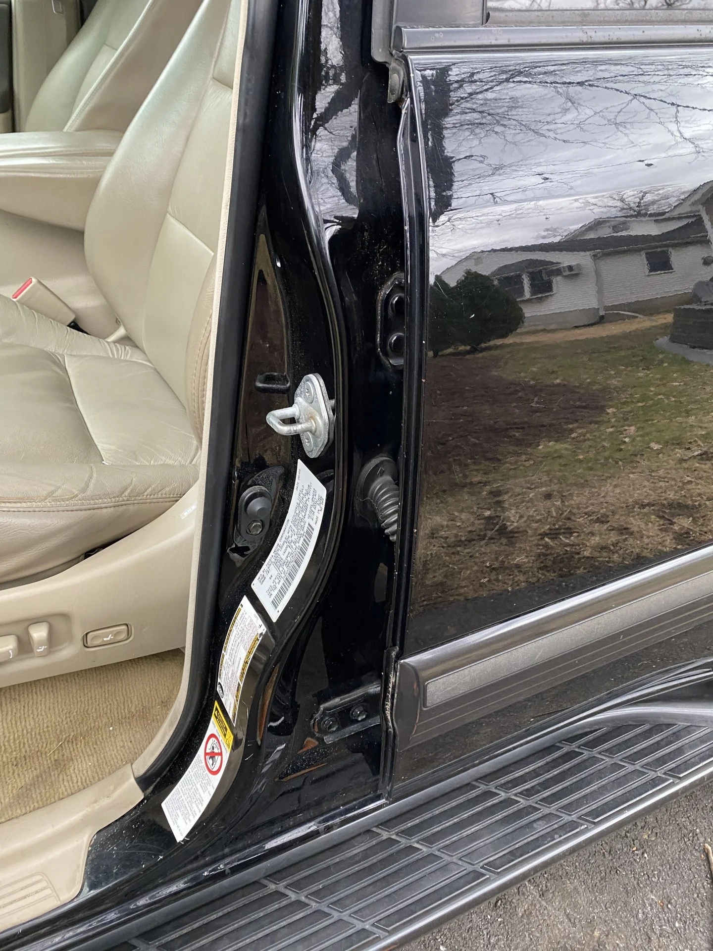

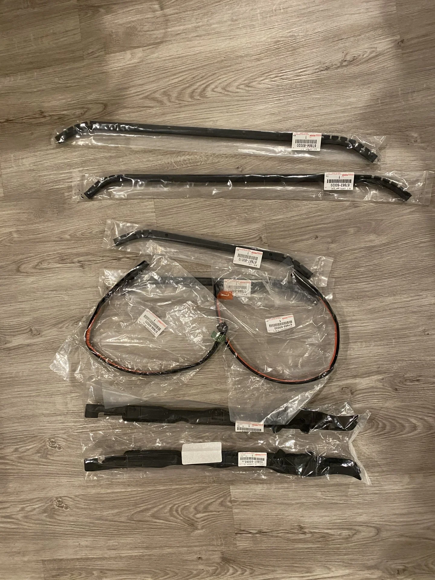

I finally ordered the parts from Amayama earlier in the month and got them yesterday and installed them. The door ones were super easy.
The front cowl ones were tricky but I was able to get them secure following the advice from a poster above. I found you can sneak the middle clip in from outside with the door all the way open. I was trying to insert it from between the door and car and there was no space for my hands or pliers.
Excited to see if it makes a difference on the highway. Just driving around town it seems quieter.
Parts from Amayama
Bottom of door (before)
Bottom of door (after)
Door jamb (before)
Door jamb (after)

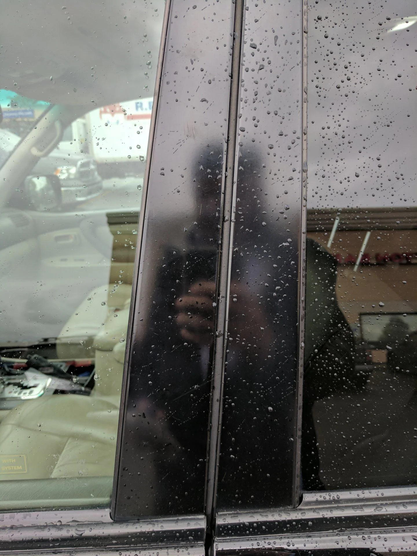

One observation though. While I was looking at the pictures and comparing to my 04 LC I noticed I have an additional weatherstrip that goes between the crack on the B pillar on the top half. I was curious about where to drill the hole and it seems I already have it and the pin is already in place holding the bottom edge of the top half of the stripping in place.
Does anyone know the part number of this upper weatherstrip for the B pillar? (Gap between front and rear door)
This weatherstrip is not present on the 98-2002 LX I believe.

I followed ordered the parts from Amayama earlier in the month and got them yesterday and installed them. The door ones were super easy.
Parts from Amayama
