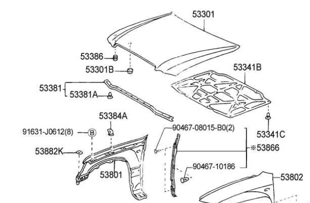

Let me know what you guys think of this, the way it looks to me is it's the front fender seal we've been looking for but I could be wrong
Possible wheel well seal??:
Part No.: 53867-60060
SEAL, FRONT FENDER TO COWL SIDE, LH - $25.01
Part No.: 53866-60060
SEAL, FRONT FENDER TO COWL SIDE, RH - $25.01
Part No.:90467-10186
CLIP - $1.46 (qty.2)
Part No.:90467-08015-01
CLIP - $0.68 (qty.4)
I bought and installed the two fender seals (part #53867-60060 and 53866-60060) and the clips came pre-installed. Obviously it was cheap for the clips, but I thought I would warn potential future buyers that they don't need to buy the clips separately.

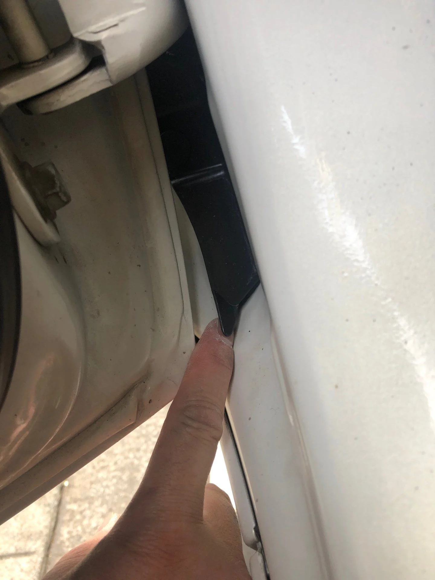

After installing the fender seals (Part No.: 53866-60060 and 53867-60060) here is my tips. The pointy end should be pointing to the ground (see finger photo). When sliding the fender seal from the top, one "leg" of the seal will slip between the fender and the body (see 1st photo for orientation). I took off the plastic screws so I can tell when the holes align. Following these tips will make this a 30 minute job. Hope my tips helps.

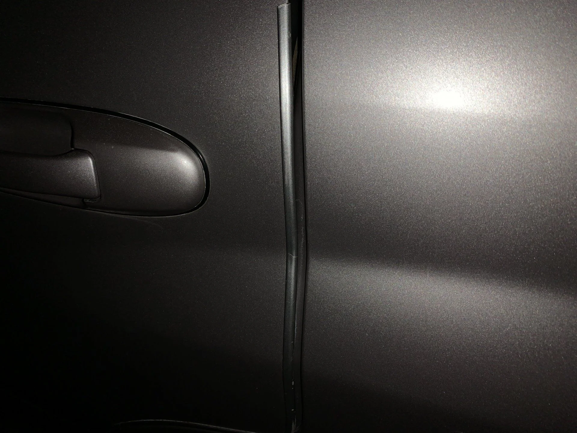

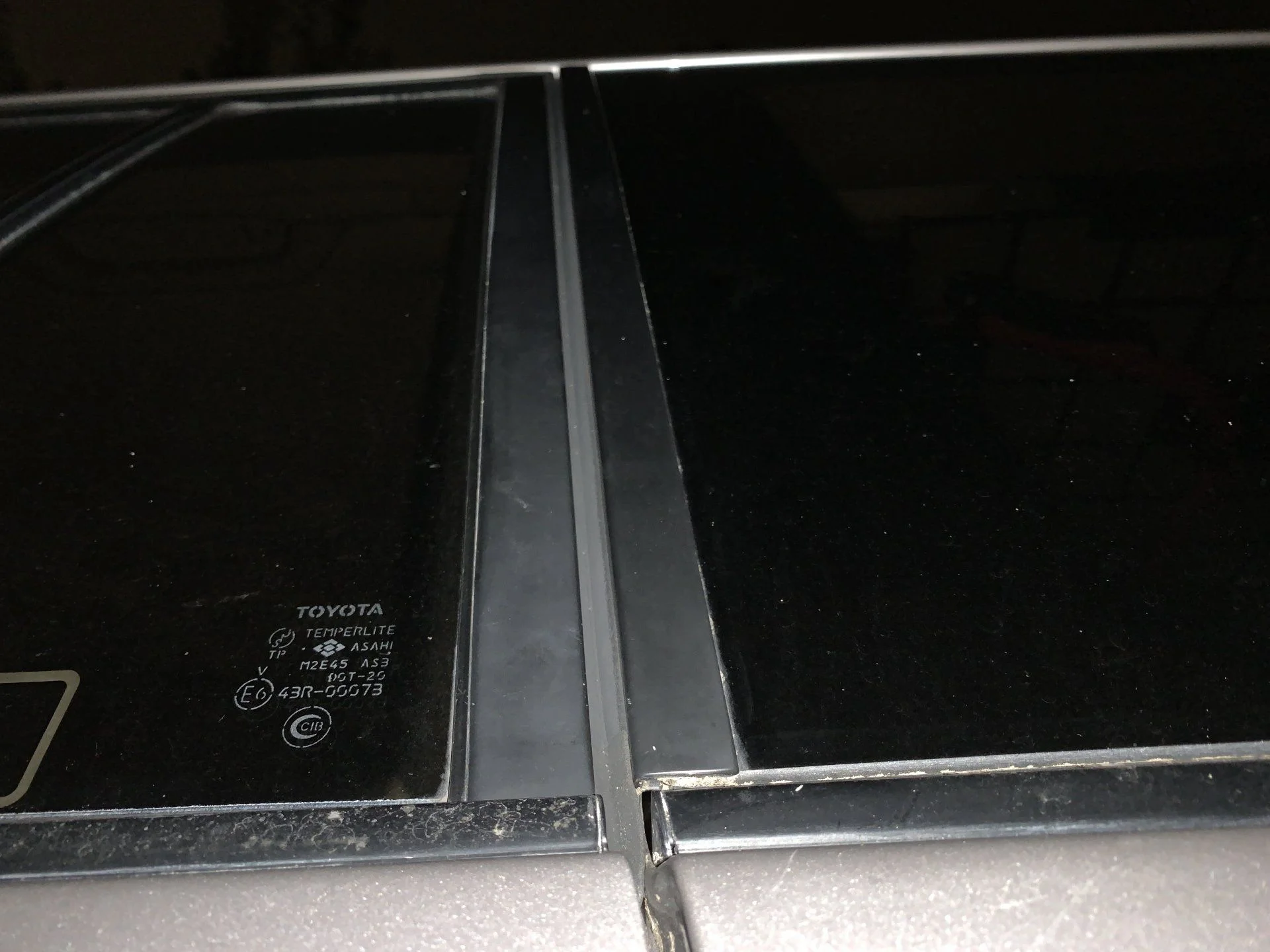

Bringing back an old thread.
Does anyone know if there is a strip for the gap between the rear doors and body at the C pillar?
Or does the rear door weatherstrip on new MYs cover that gap? Or not?
The only two places on my LC that have the gap is the one at the top of the B pillar between the front and rear doors and the rear door and body.
@TheForger?

I don’t have the FSM in front of me right now to check if there is normally something there for the LX, but on my LC the gaps are the same as yours. The door weatherstripping has material between the rear door glass and quarter panel glass here
But nothing between the door and body except for the inside edge
Yup, same here.
Was hoping there was a "fix." lol
