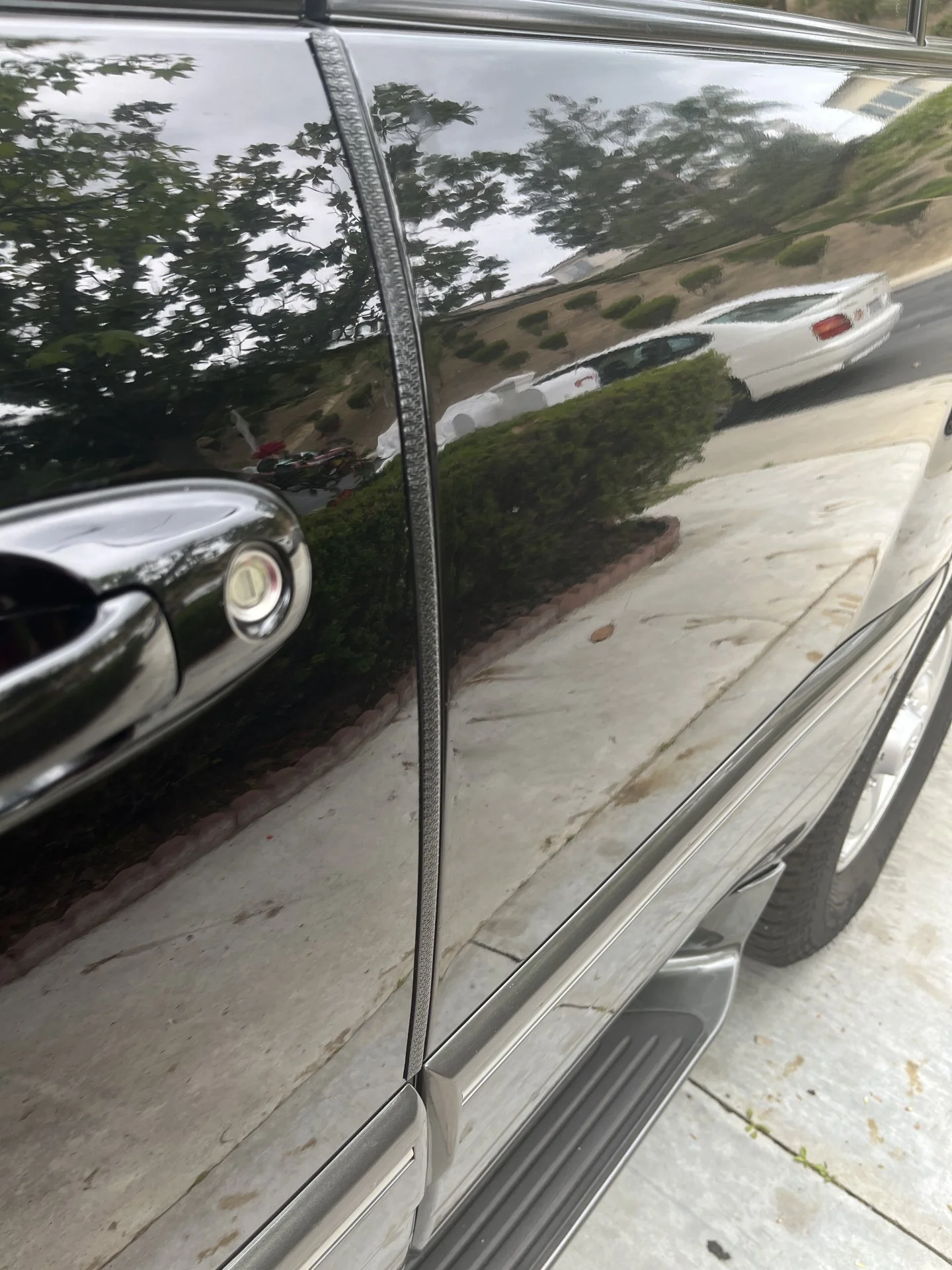

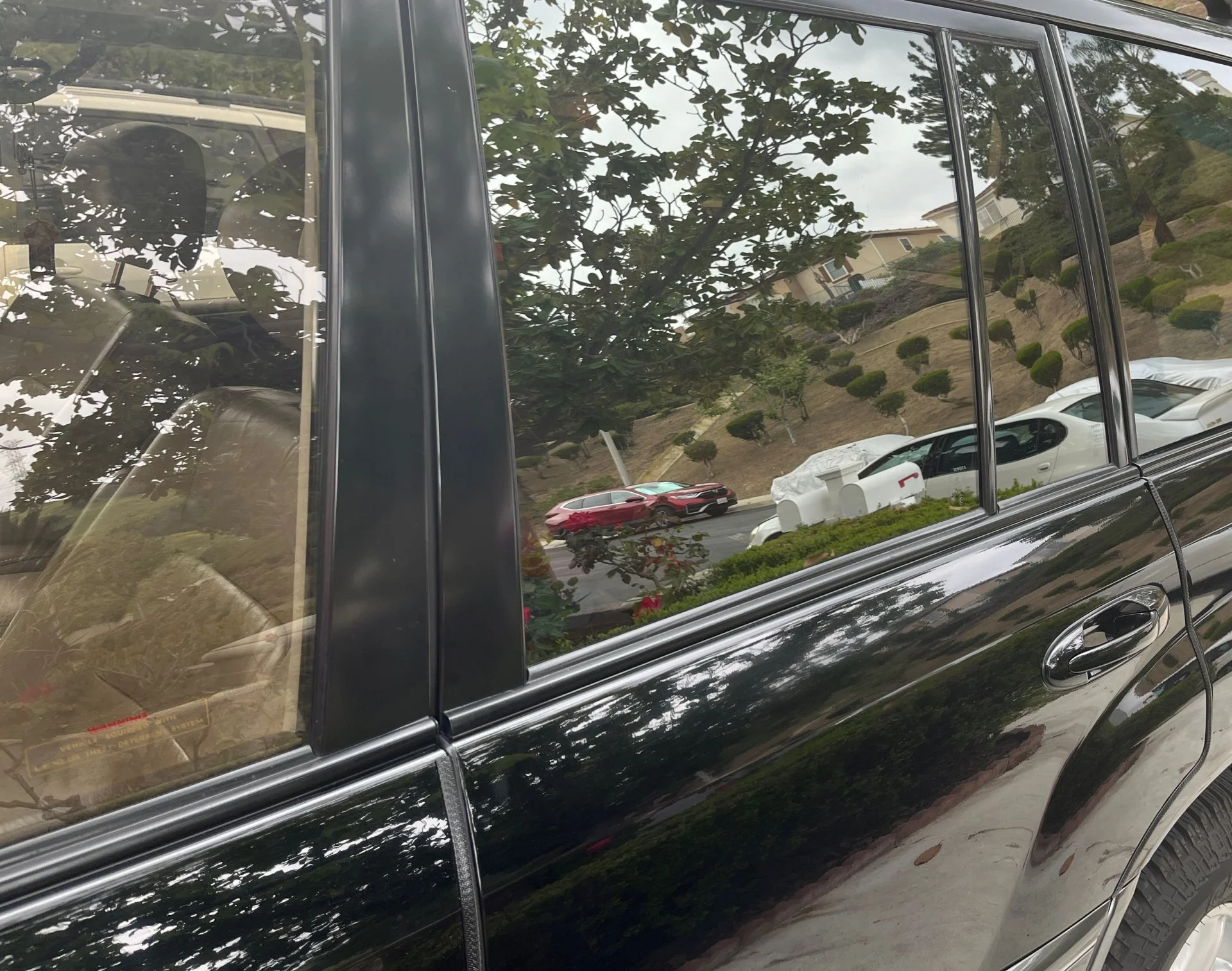

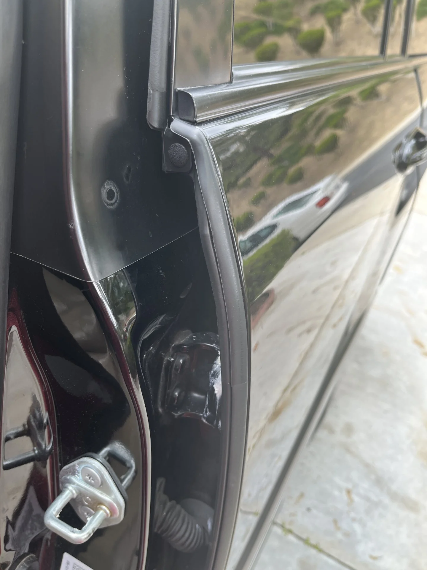

Installed the 06/07 front and rear door weatherstrips on my '00 LX. All plastic gromets are in the same location except for the additional mounting point for. The rubber seals the gap between doors a lot better.
What size drill bit did you use for the push clip that connects the new door seal and the extra seal?
13/64. Rear door closed, front door open.
You’d be able to drill it straight in without clearance issues on the drill.
I took a picture of how it looks like. Hole was protected with primer spray and sharpie paint pen.

Did you use double sided tape for the seal between the doors since the older model 100's don't have the rectangular hooks built into the door?
Yes, I used 3M 03614 leftovers from my audio upgrade.
Adhesion's not great unless you heat that up with a hair dryer before applying. They also lose adhesion with the slightest amounts of grease or oil.
The preapplied tape from Mr T's a good choice for stronger adhesion but I'm not sure what's a good substitute for that.

If you're referring to whistling noises at high speed and have a correctly or factory installed windshield, its mostly from the front doors. The 06-07 door weatherstrips seem to seal tighter. The rear door weatherstrip sitting next to the B pillar also helps tremendously.
