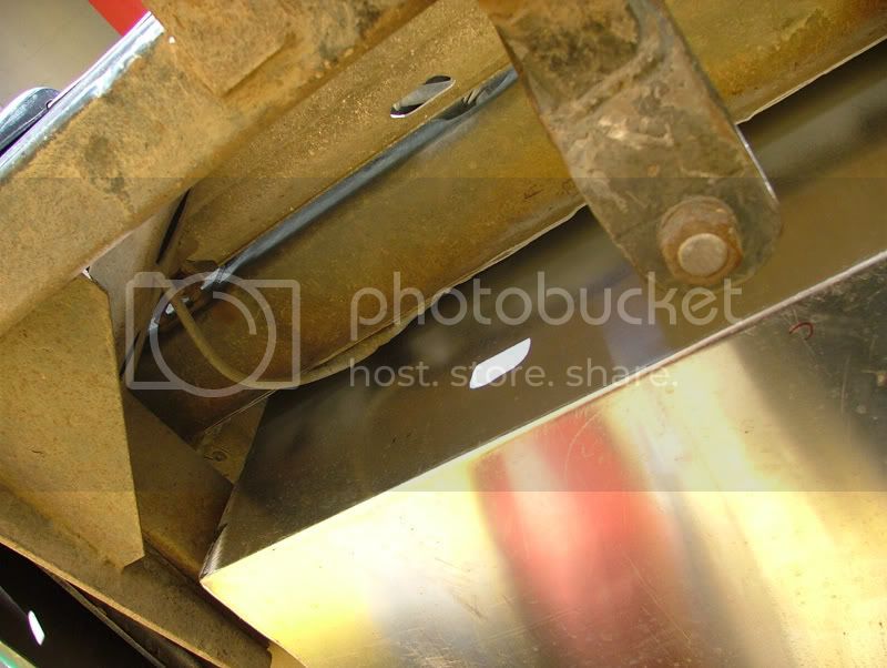

Can you post up some more pics of the underside? Curious how close you got to the floor crossmember, or if you just cut through it? And the LSPV comment from above is a valid one, did you relocate that or is it still in place?

Nakman, the LSPV is still in place, the arm that should end on the axle is now resting on the upper control arm. It was rusted in two inside the rubber under the PV so I used the lower part up there and relocated the lower end. Now I quess the brakes are set on max braking.
I pobably will finish the rust proofing tomorrow evening, I will try to shoot som pics from under there.
There are 30 mm to the next front and rear crossmembers and 30 mm to the frame on both sides.
Here are few pics from the underside. Taken today while having some fluids changed.
Not the best pics in the world but can give you some ideas about the underside.
