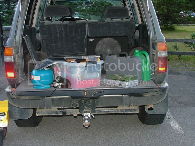

More cargo room

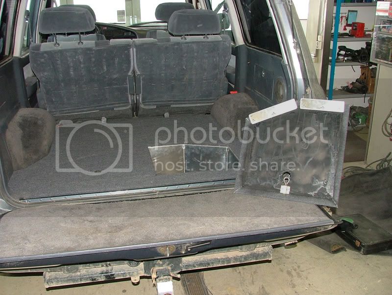

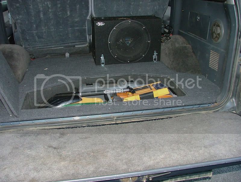

If you look at picture numer 3 in the first post you will see the cut away on the floor under the truck. It is upside down. I would not want to use that dirty thing as a lid.
Hopefully I will have time this weekend to finish the interior as I plan. I plan on replacing the original carpet with plywood, and make a lid from the same stuff. Then glue a new carpet over the wood.
Uh, you could clean it, couldn'tcha? :D Just giving you crap, man. If I follow your lead, I'll assess the dirt on mine.

Did a little work on the carco box tonight. Got some woodwork and carpeting done ;)
Looks good to me... tomorrow I plan on making the lids.

I had the lid in two pieces. The aluminum on the top of the lid slides under the plywood on the floor and the lock locks it in place.
As you can see I can fit alot of stuff down there, all the stuff on the tailgate fits and there is room for a little more.
The lids are rattle free and locked so I can drive bumpy roads without worrying about getting my tools in the back of my neck.
