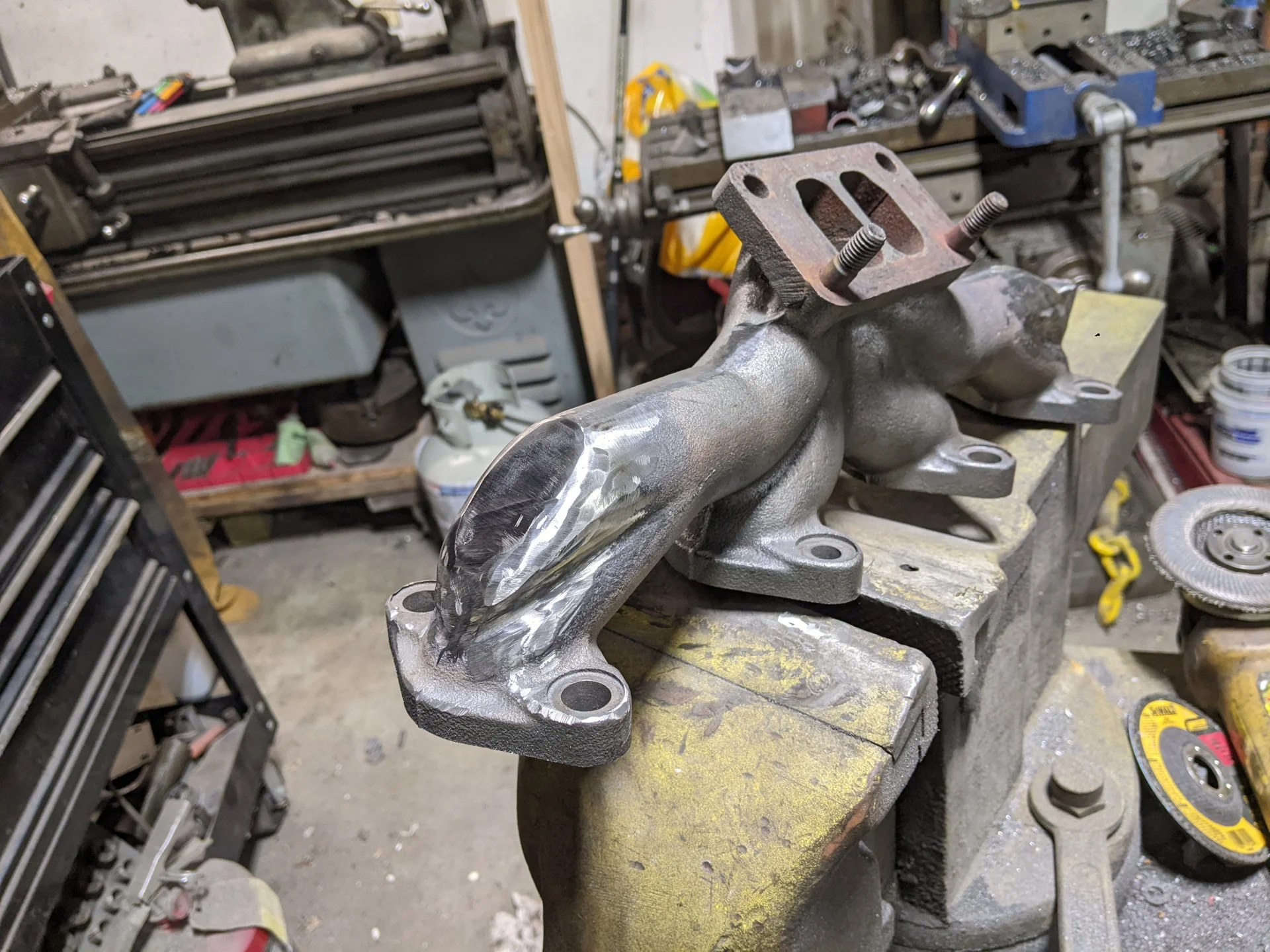

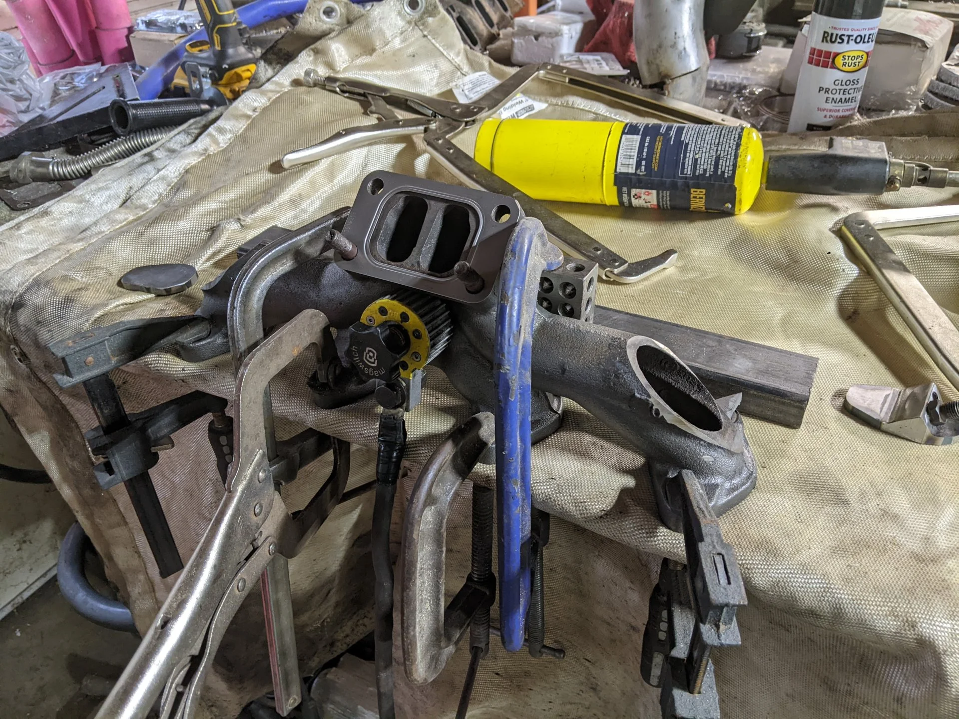

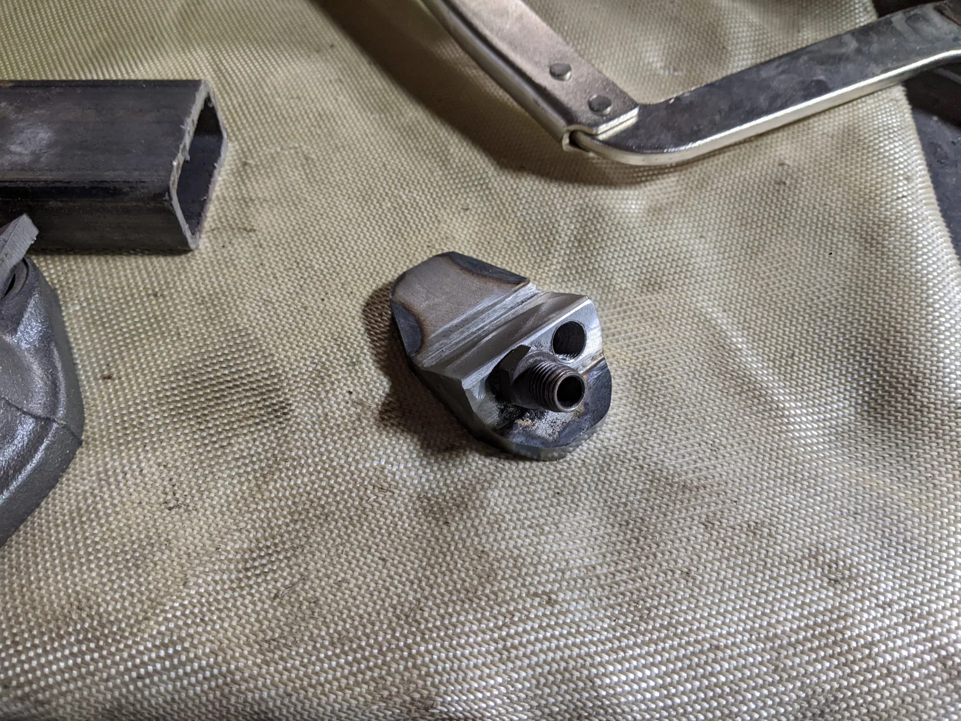

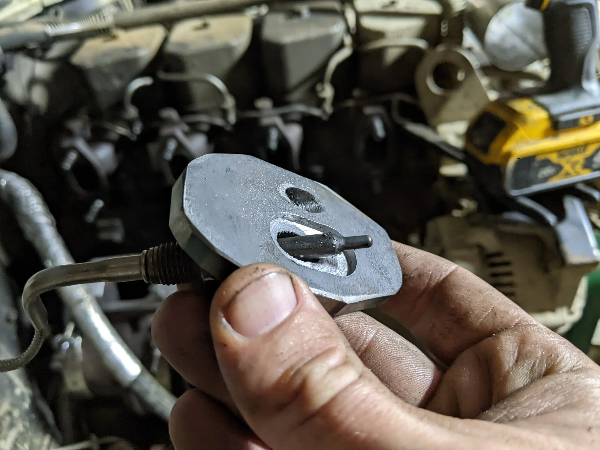

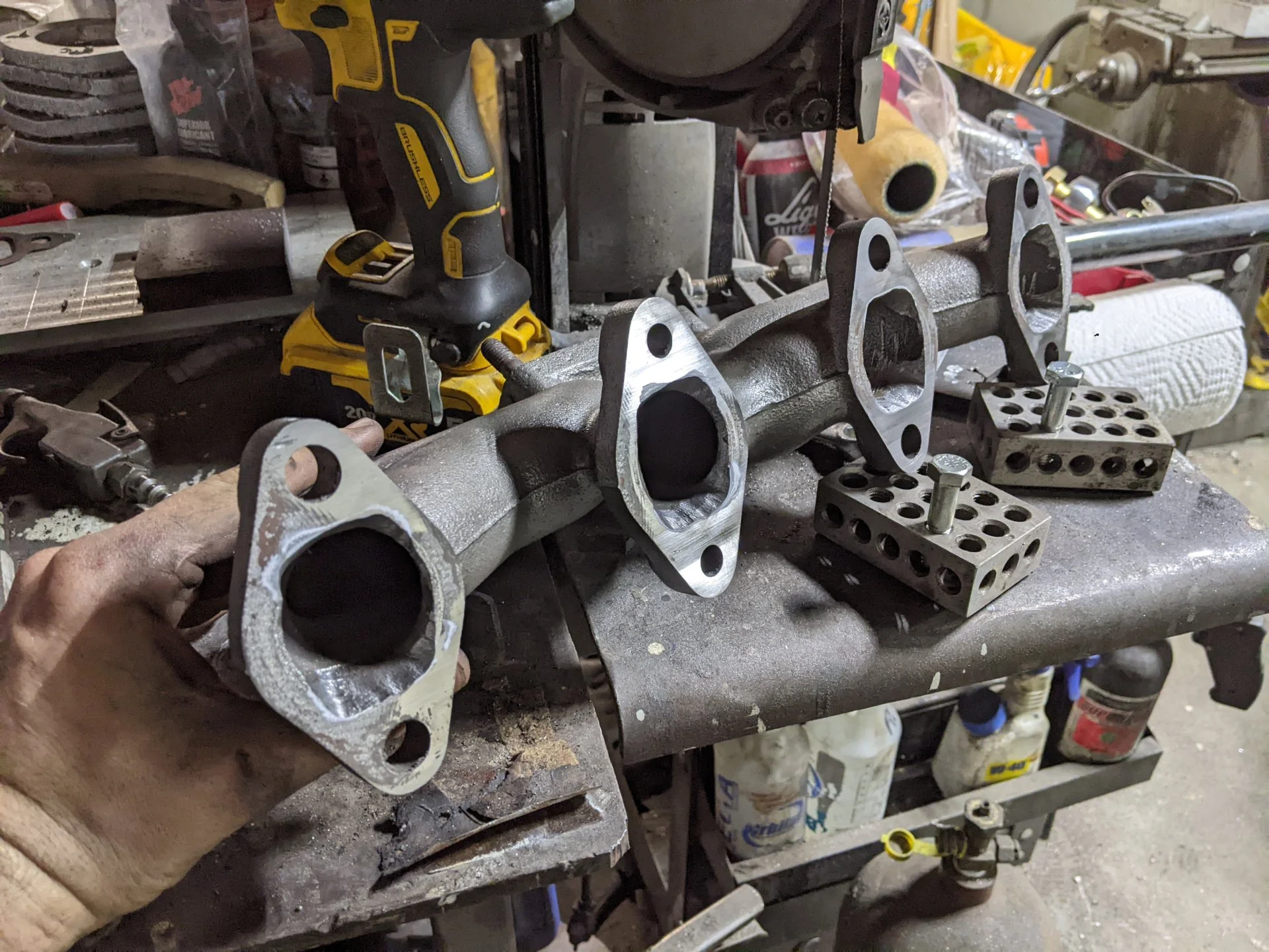

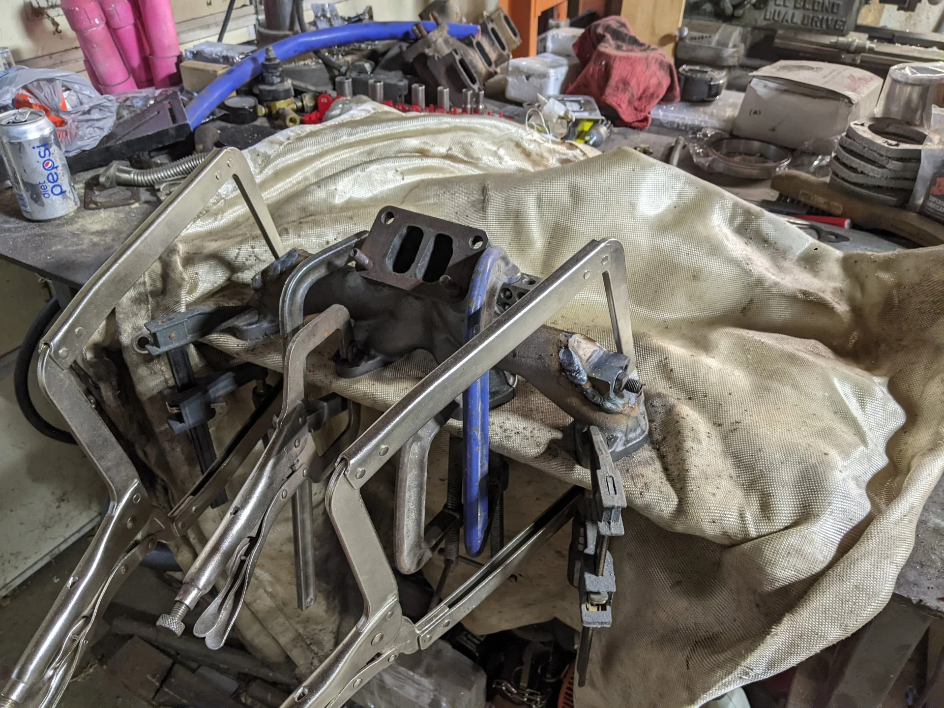

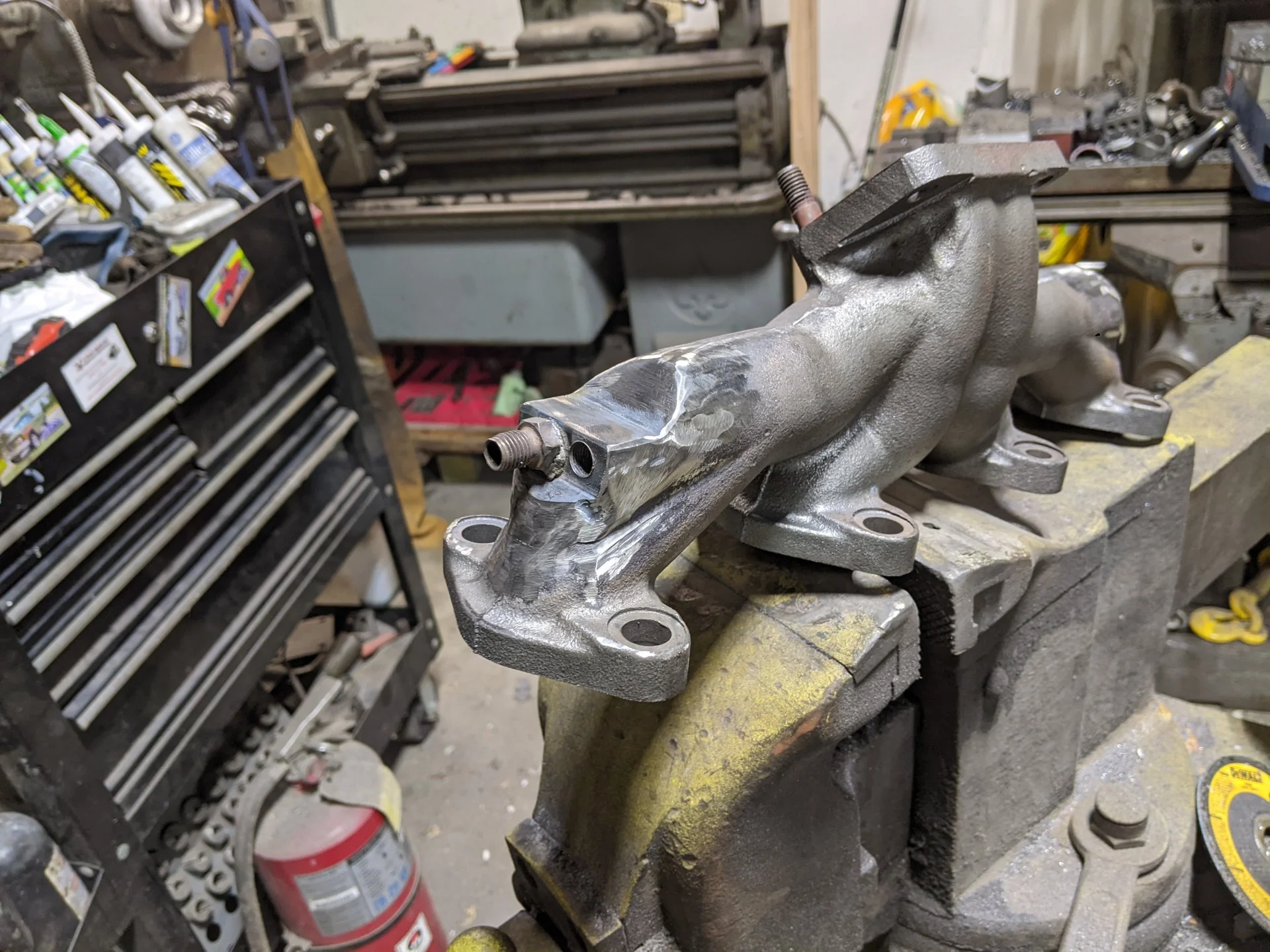

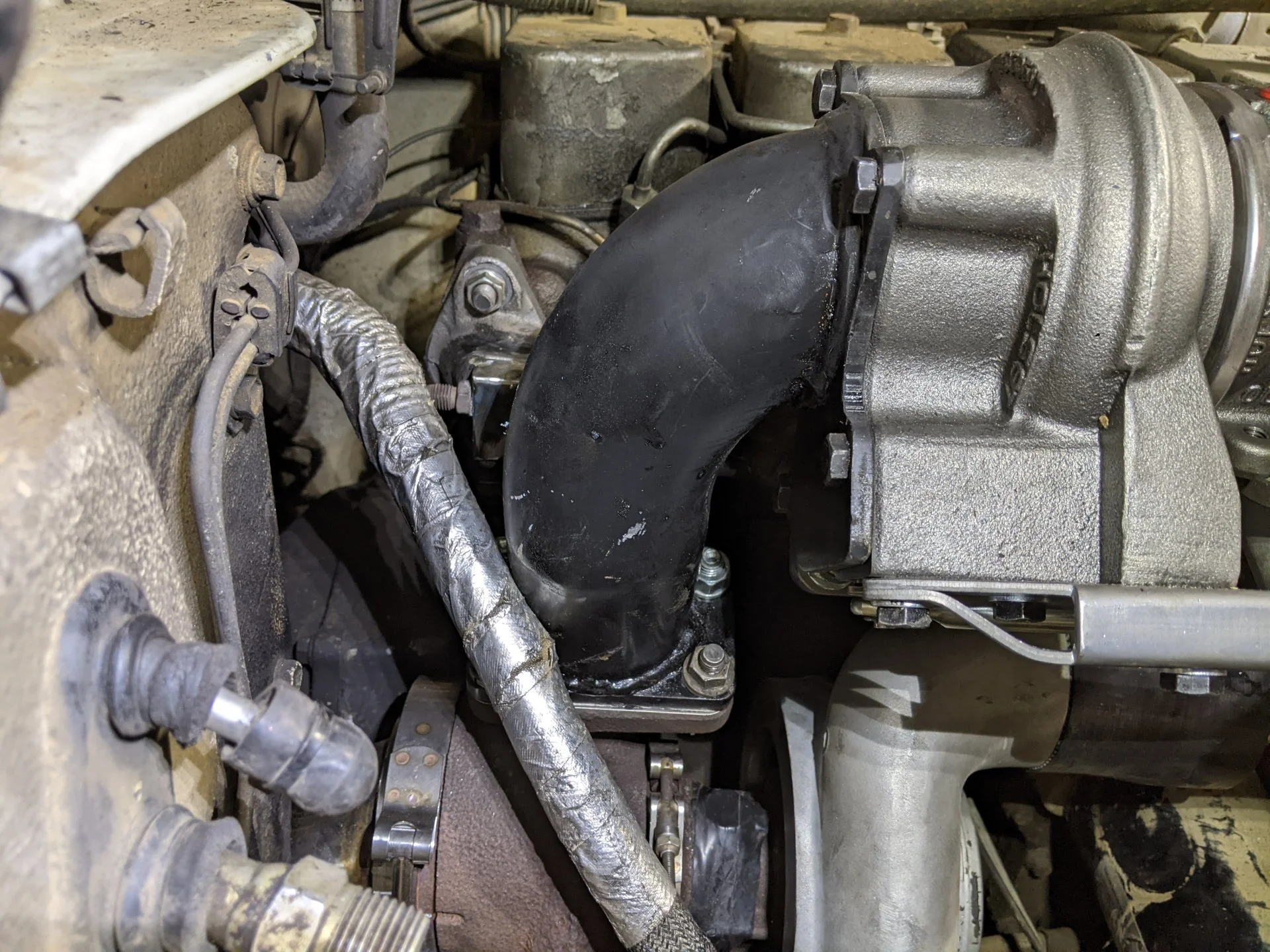

Made one manifold cap on the mill with 1/8"npt ports for egt and drive pressure gauge ports. Second cap made out of 1/4" plate. Prepped the manifold, preheated it, welded the two caps on, the wrapped it and let it cool slowly. Finally I cleaned it up with some grinder action and ported the round ports to fit the rectangular ports of the engine.

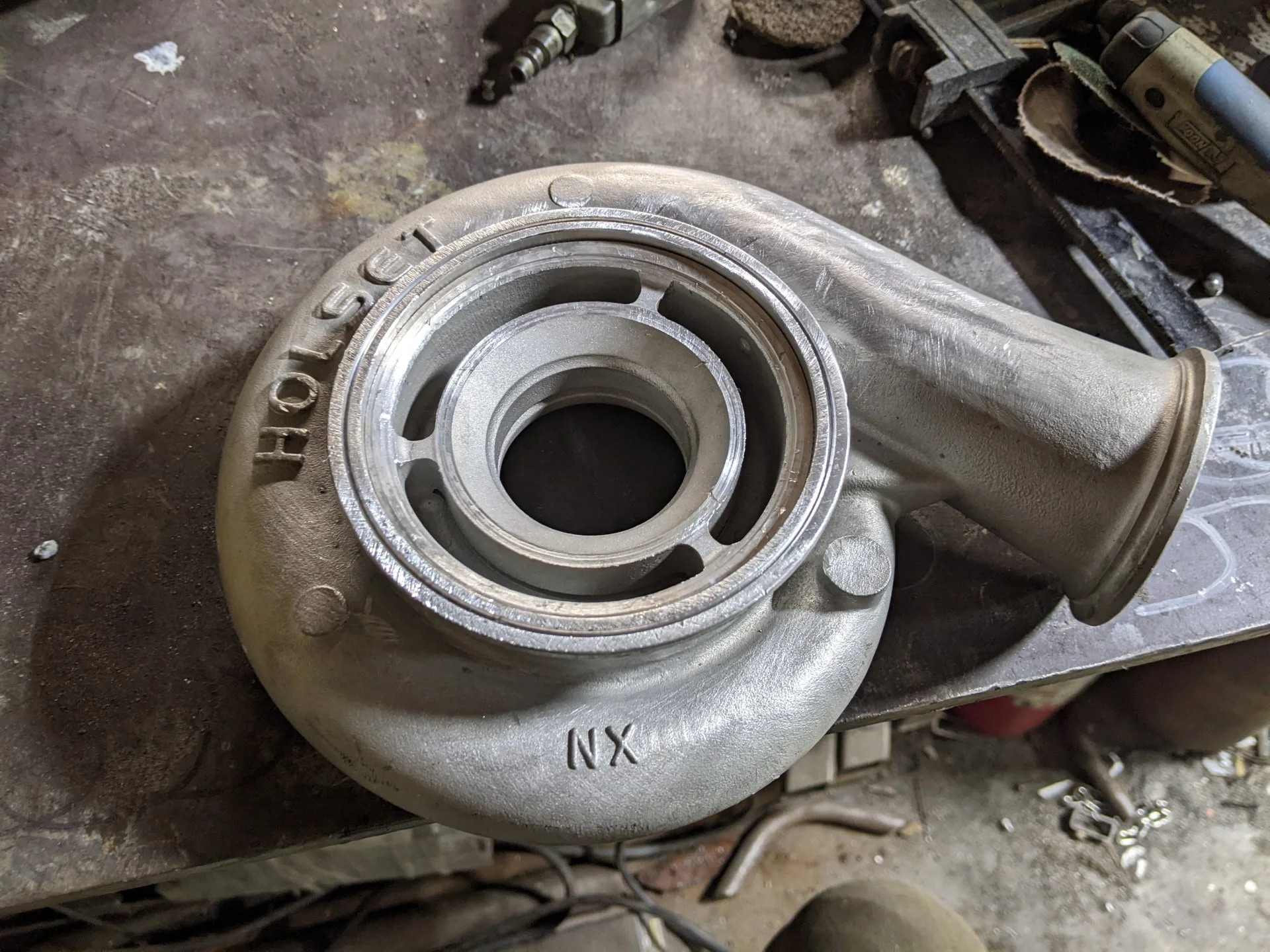

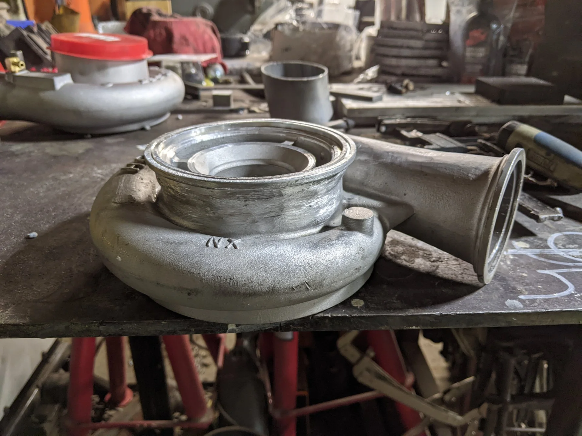

Spent the next while welding the intake vband onto the primary turbo compressor housing. Welding cast aluminum sucks so bad.
Also finish welded the hot pipe and threw some temp paint on it to prevent rust.

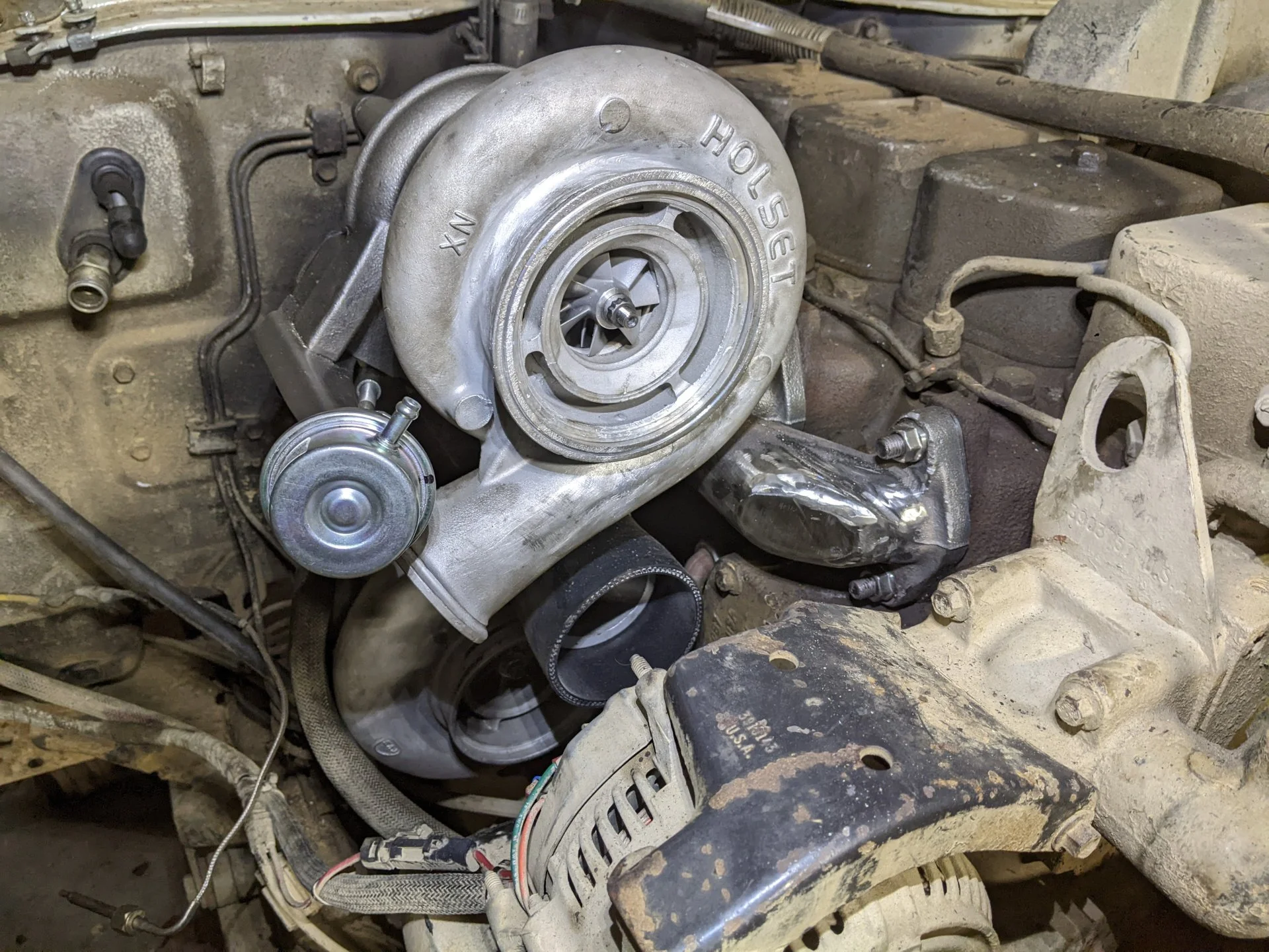

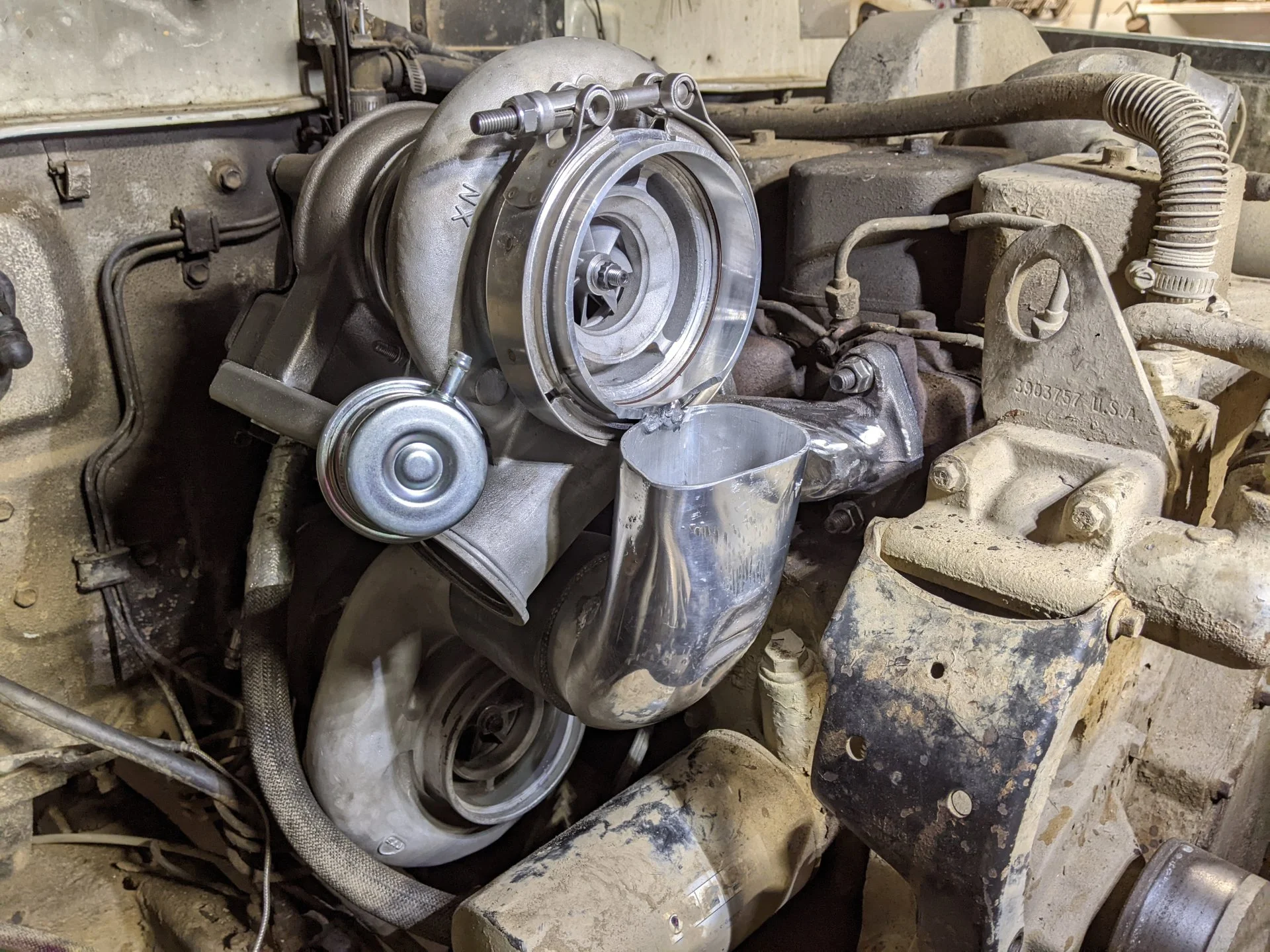

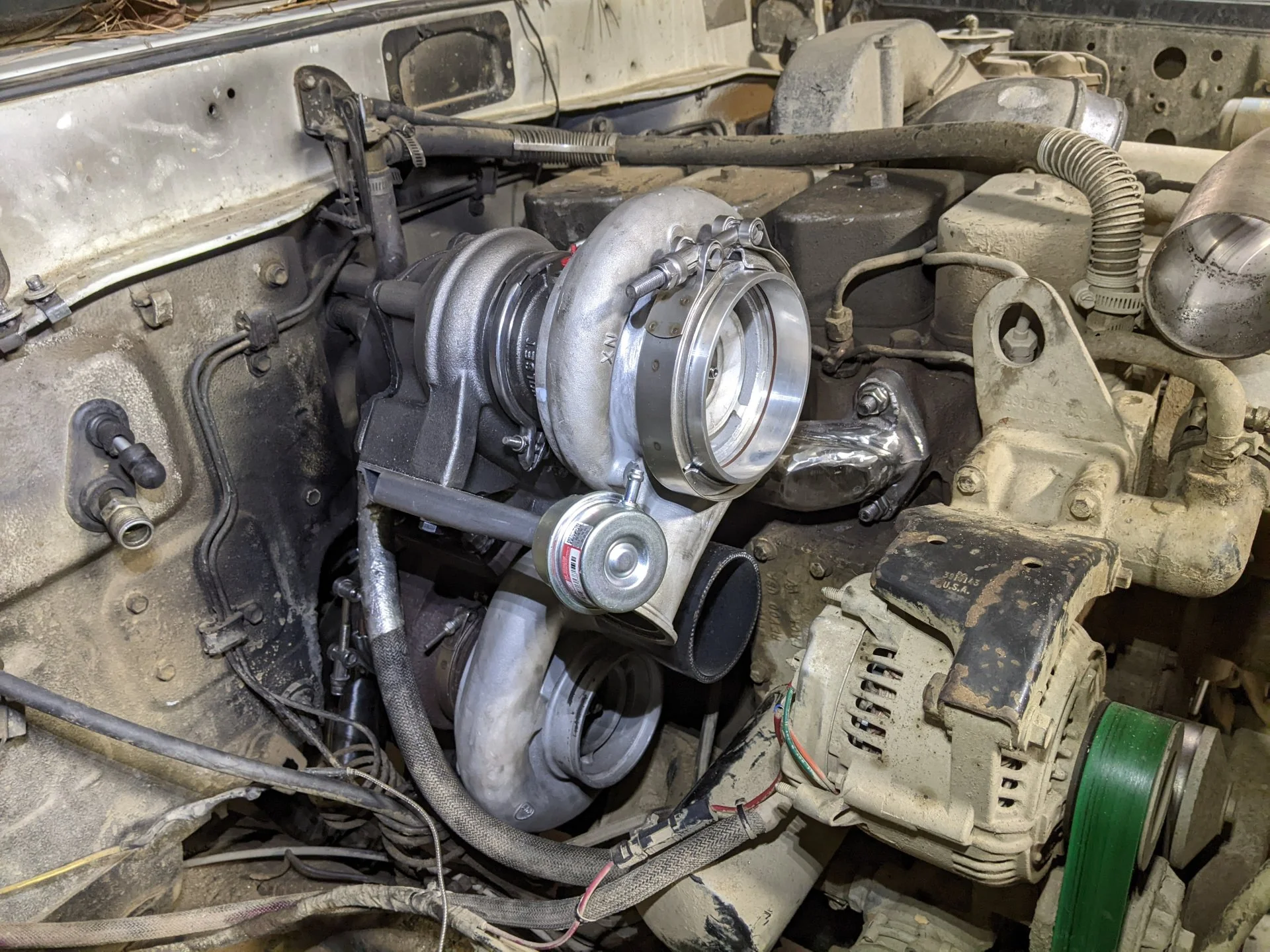

I fought the compressor housing snap rings for a while but won (tool now on order) and put everything back on to start imaging the secondary to primary charge pipe. Gonna be tight, but it will fit.

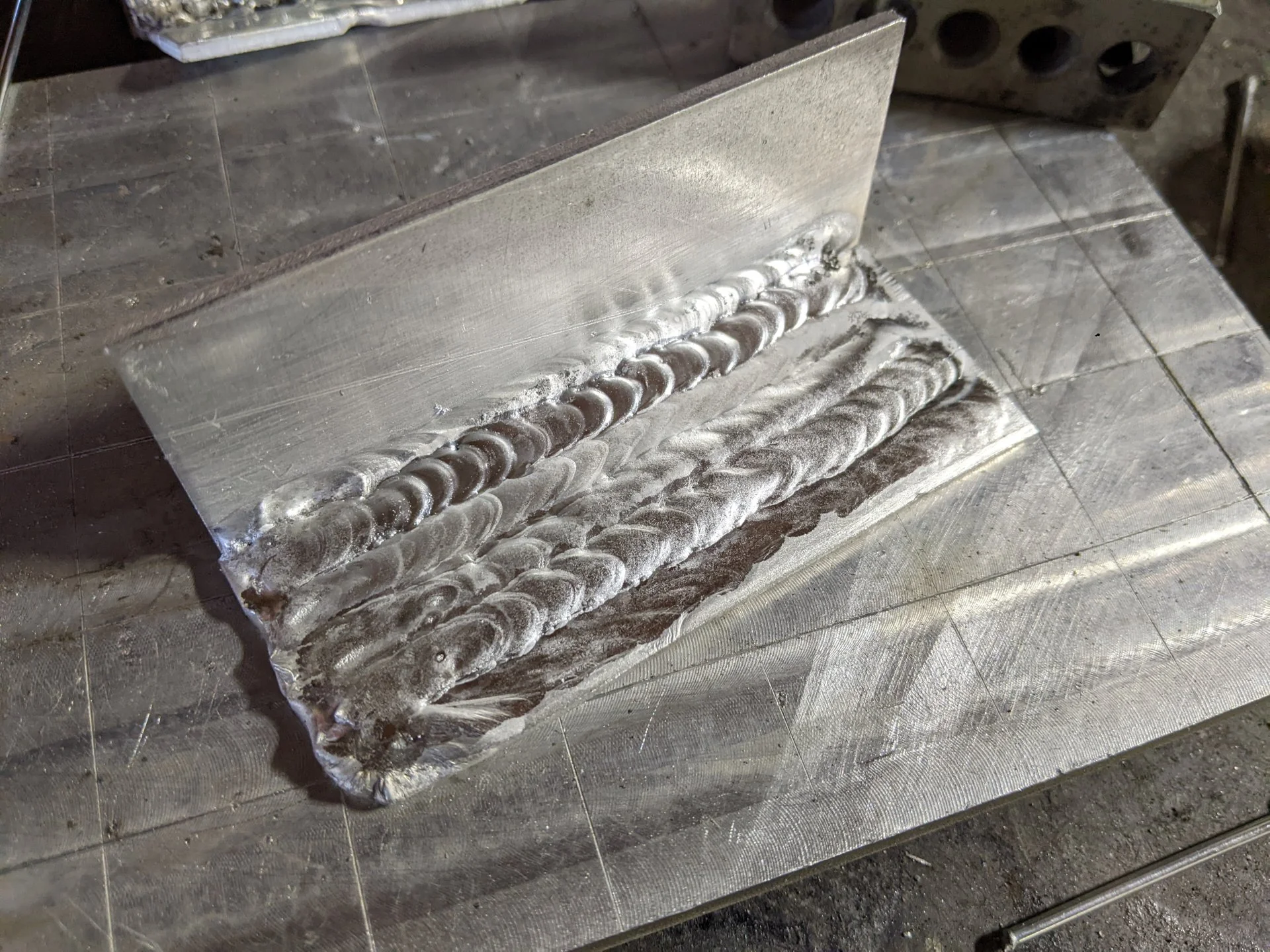

Aluminum tig has been kicking my ass the past few days. Have been trying to build the intermediate pipe from big turbo to small turbo. I'm on the third iteration now and I think I've got a winner, just need to finish execution, and get better at thin wall aluminum tig, lol.

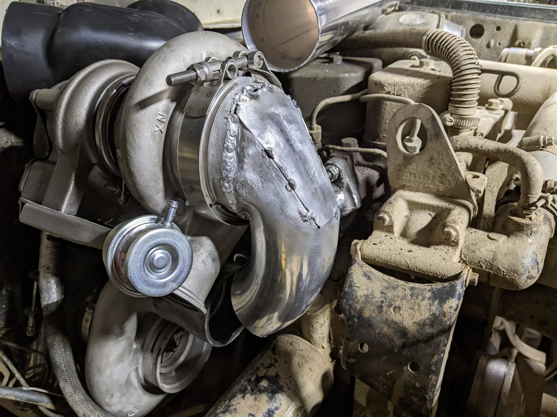

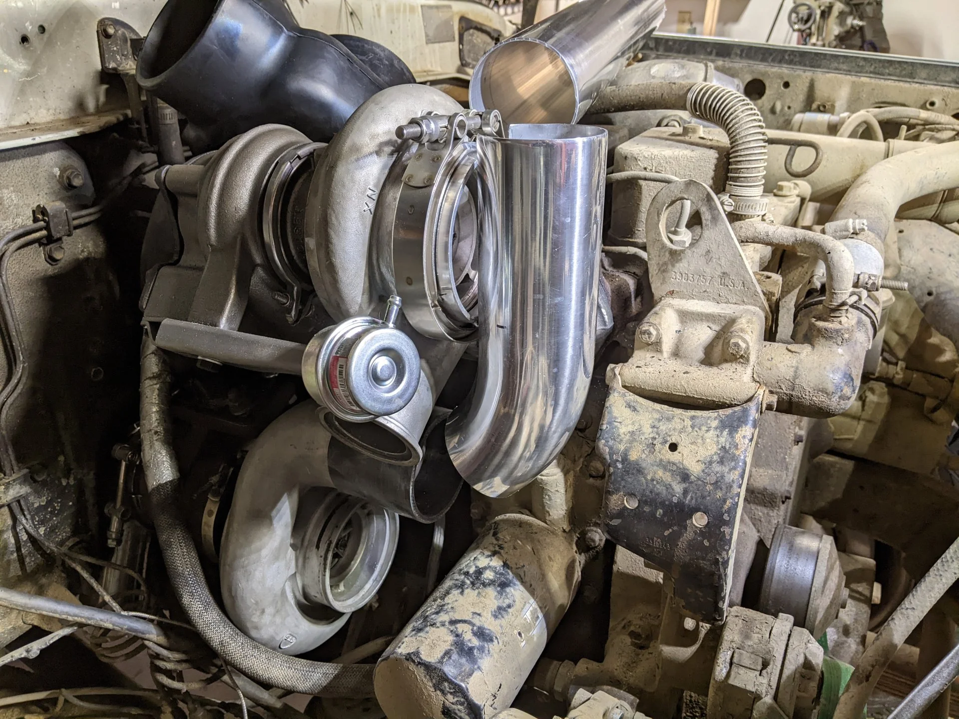

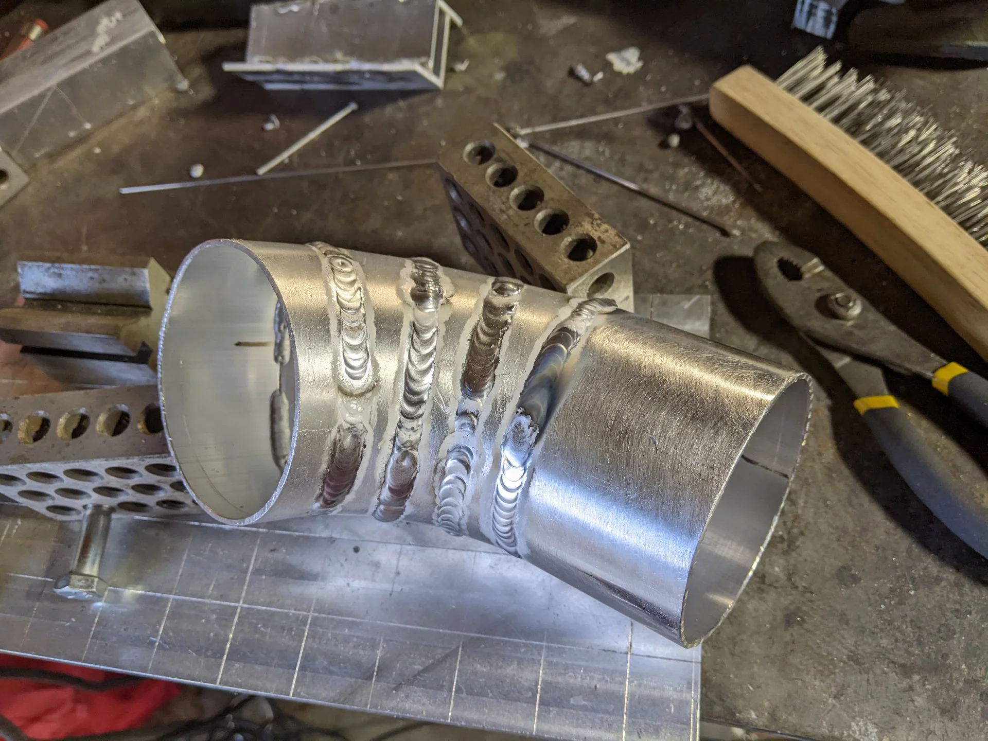

After getting the manifold and hot pipe welded, I wanted to fabricate the intermediate pipe between big turbo outlet and small turbo inlet. It's a tricky spot because the alternator is right in the way, and for some reason I decided I wanted to do it out of aluminum.
Long story short I've never welded thin wall aluminum tubing before, and my tig welder is apparently not suited for thin wall AC. I fought with my welder for a while, then ultimately gave up and borrowed a friend's welder (thank you @S4Cruiser !). With some practice I was able to knock together a few iterations of the intermediate pipe, and I think I've got a winner now.
Attempt #1 ended up being too short.
Attempt #2 wasn't sharp enough of a bend, and deformed too much (due to the welds) when bent to clear the alternator.
Attempt #3 is my current favorite, and is still in progress. I'm liking it, but that patch pictured didn't pan out, so I've got to make a new one.
Currently waiting on a new vband clamp, as the one in the picture galled + seized, then had to be cut off.
Talk about a ****in debacle. I am getting much better at AL tig though, :lol:

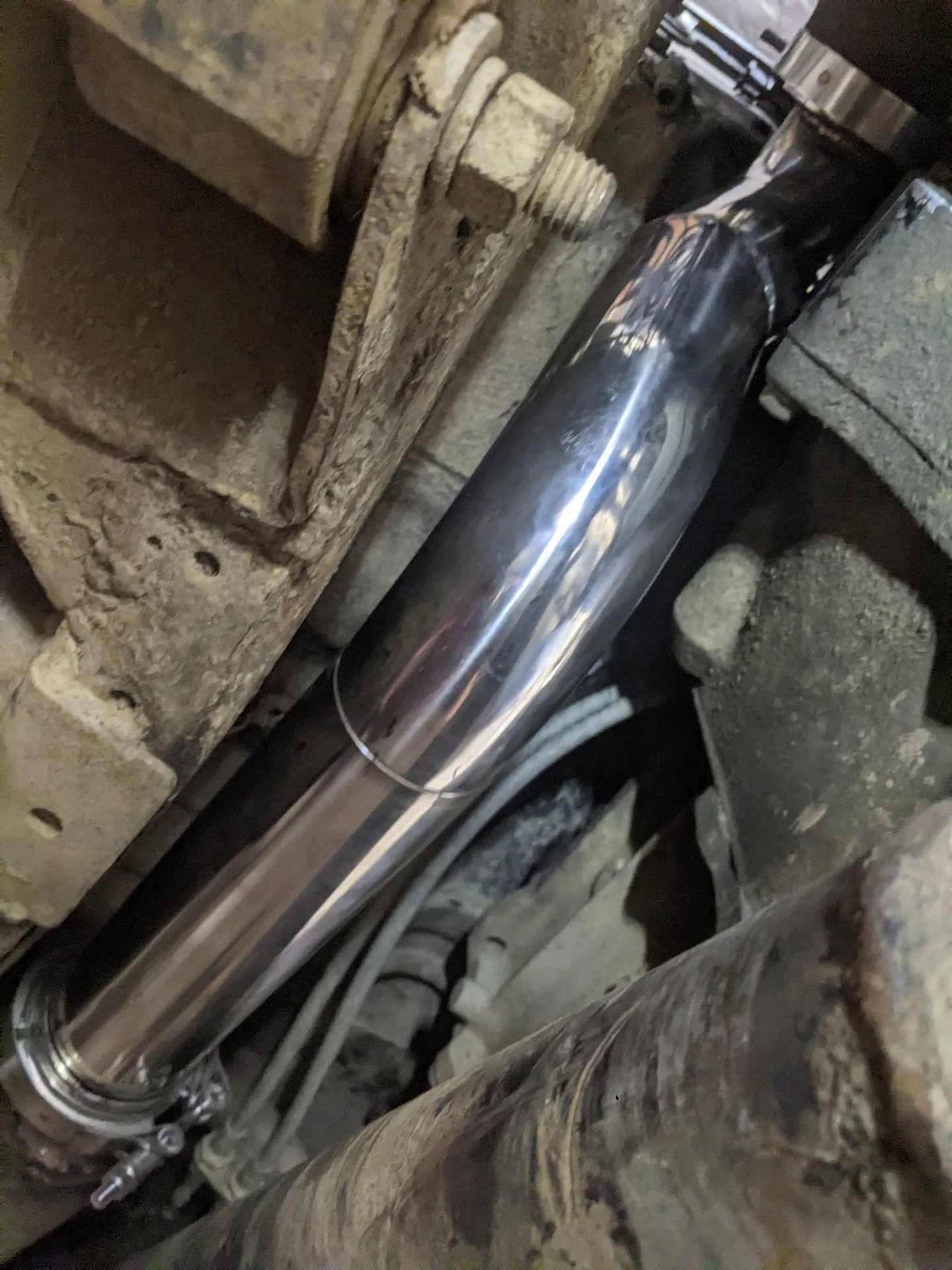

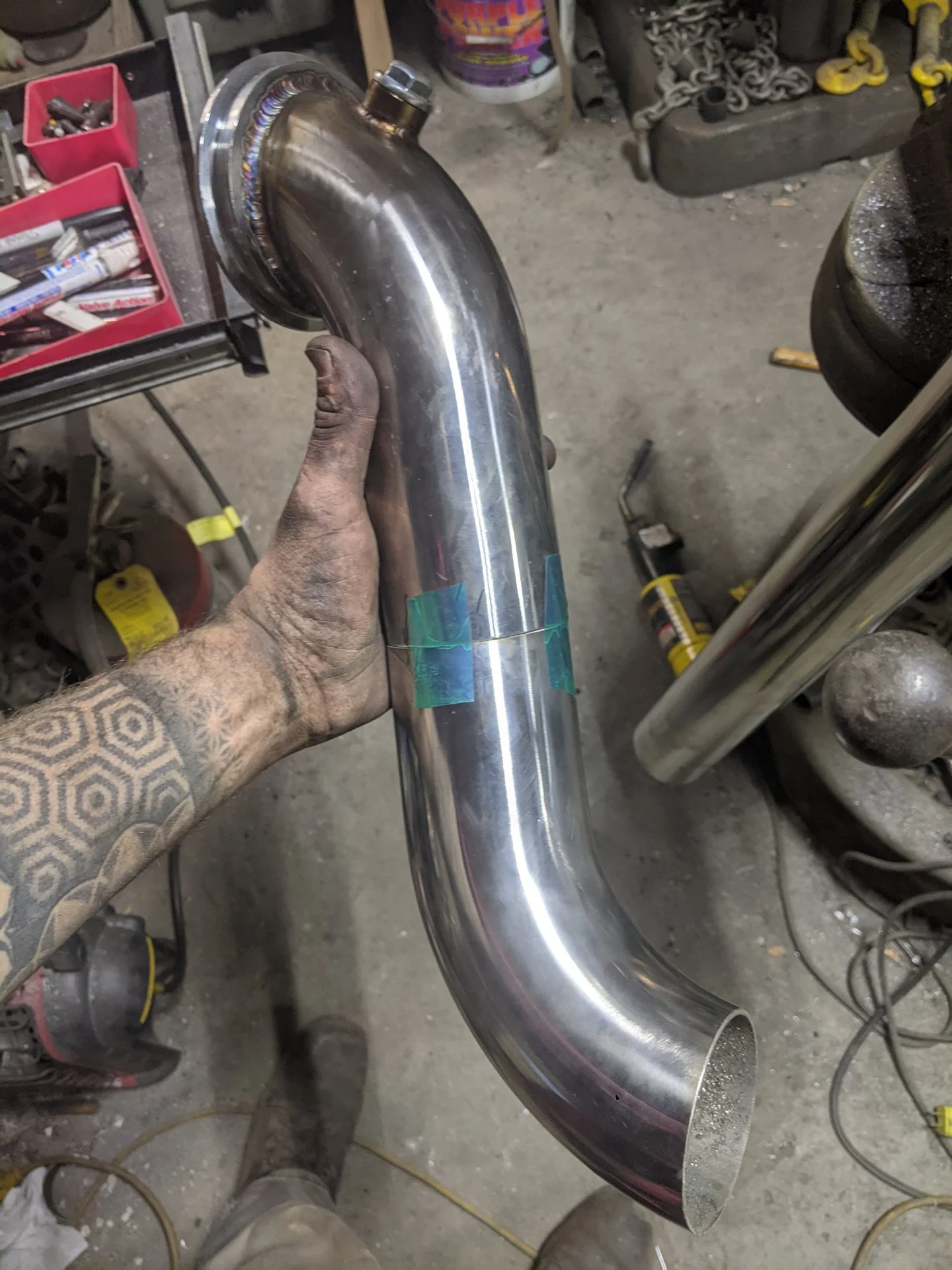

Last night I wanted to get something done before the new vband for the inlet showed up.

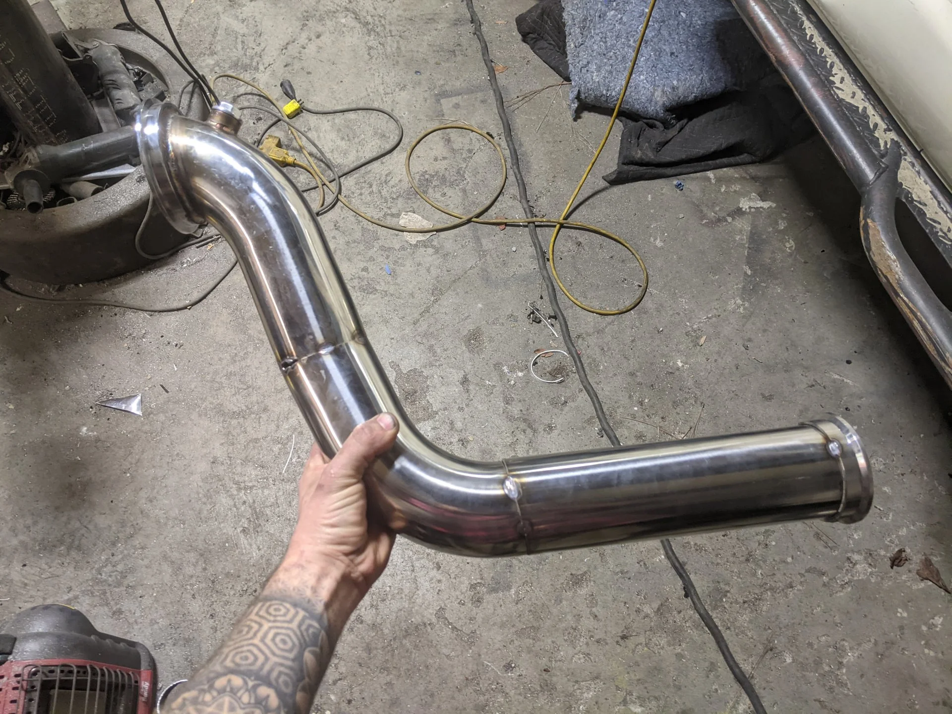

I bought a he351 generic stainless outlet on Amazon, then a 45*/180* section of 3" 304 stainless and 3" stainless vband clamp set from mandrel-bends.com. Using those parts I was able to repair the middle section of the existing exhaust, and fabricate a new downpipe. It went together fairly well. I need to add one more exhaust hange, and finish weld the downpipe, but I'm pretty stoked.
By the way, welding stainless is way, way, way easier than welding aluminum.
Finally, the tape pictured is high temp masking tape, aka powdercoat tape. Its awesome for holding tubing sections in alignment while you tack it together.

What size filler you using for that thin AL stuff.
Learning on that 16/18g tubing is trial by fire.
3/32". I've done a bit of AL tig before, but this is my first time on thin tubing.
Thicker stuff and training on flat plates is easy, but the positioning and fit up for this tube is a real bear.
