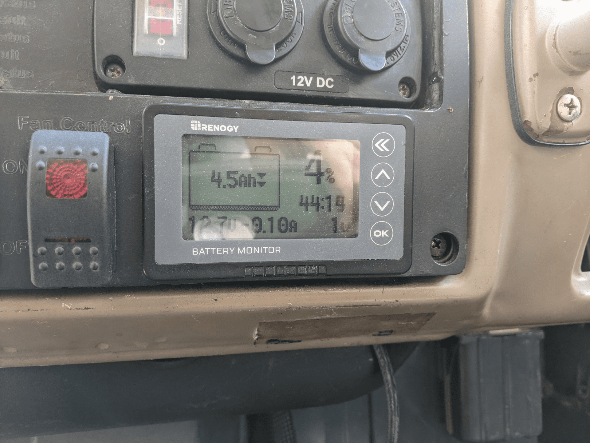

I got back from vacation the other day, and went out to check battery levels just now. The Renogy monitor says 4%, which isn't great, but that's almost two full weeks of fridge use in mild weather! Not too bad.
There's a twist though, and where this gets interesting @J Mack . The BMS says that the array is still at 45% SOC. This would indicate that the shunt is configured incorrectly, which is probably true, because I never set the low voltage setting due to never discharging the cells this low. Even without that, I configured the monitor for 100ah bank capacity, and set the full charge state, which tells me that the shunt is recording too much amperage draw? Not sure, need to read into this some more.
Pretty neat though, the BMS SOC @ 45% after 12 days tells me I should be able to get nearly a month of fridge use with the truck off. Too cool!! I'm going to continue this test until the BMS cuts the array off, then try self-jumping with the battery join feature. If that all works as expected, and I can reconfigure the Renogy monitor to more accurately read discharge rates, then this LiFePO4 array really is the perfect battery solution.
