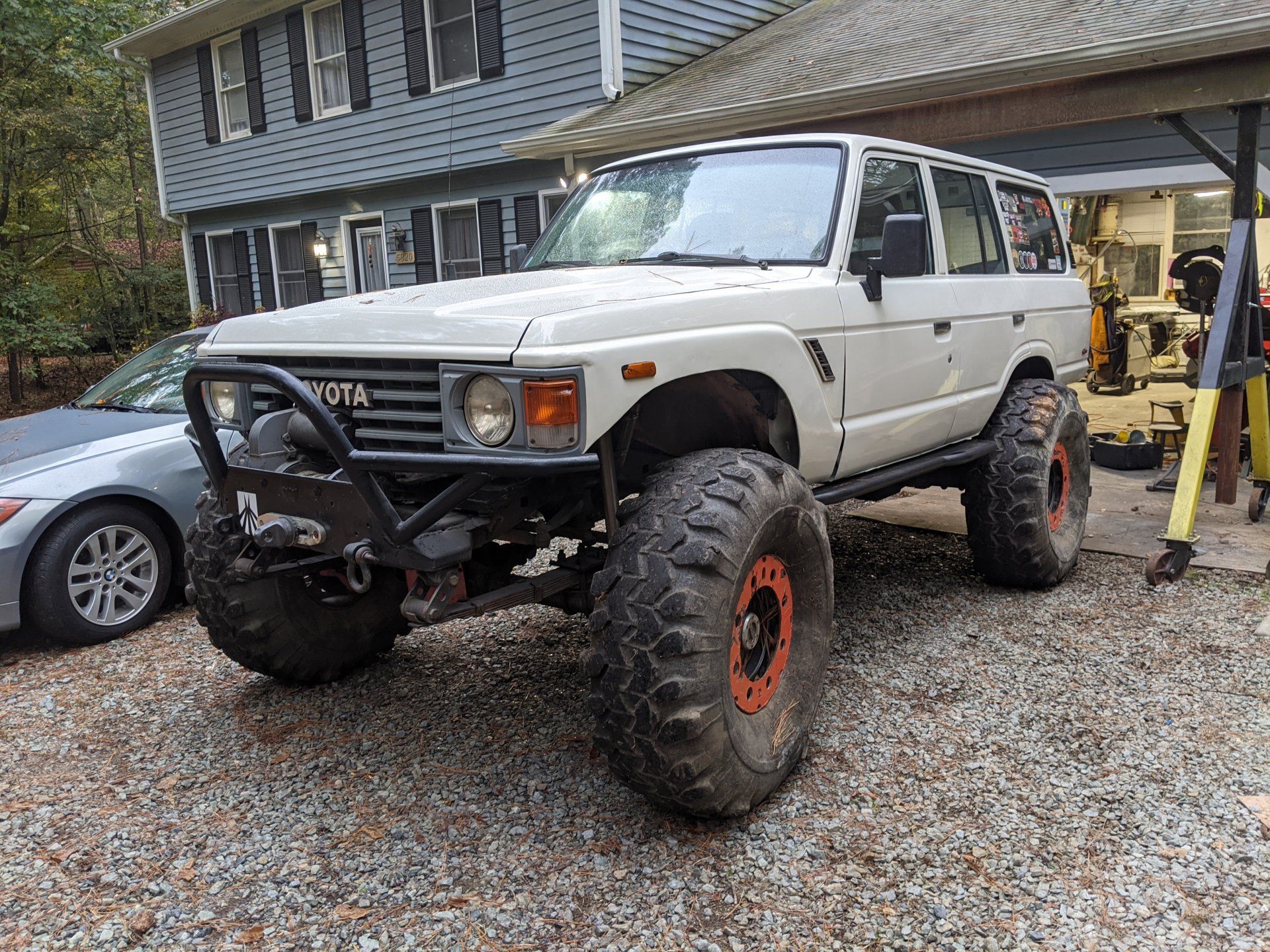

All prepped and ready for gsmtr. Here's some before pics. Hopefully she looks like this at the end of the week :lol:
Packing the new storage system had a bit of a learning curve, but I think I've got it. Stored the hilift beam on the slider, bottle jack and hilift components in the drawer. Made a quick handle for the bottle jack as well.
Sleeping platform also got hatches, and a mounting point for the powertank.
Was able to fit all of my onboard tools into the seat boxes, which is awesome.
Fingers crossed, we're good to go!
