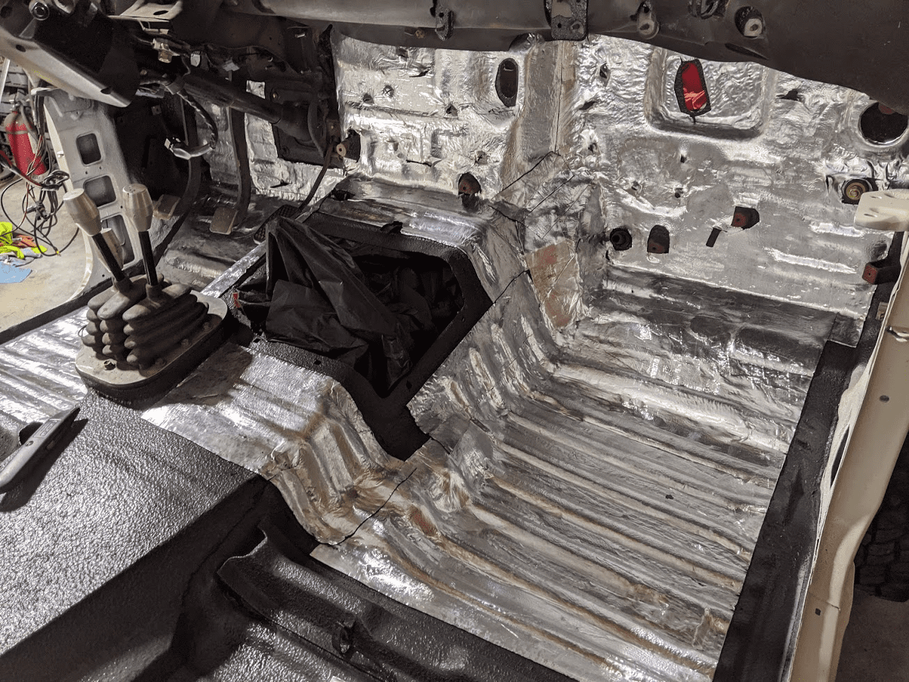

Do you plan on running any sound deadener at the firewall or under the front seats at all? I know you have the spray on, but dynamat (or it's many copies) do work wonders.
Yessir. Current plan is to use dynamat from the firewall to the front seats, then dynaliner, then vinyl/rubber floor on top.

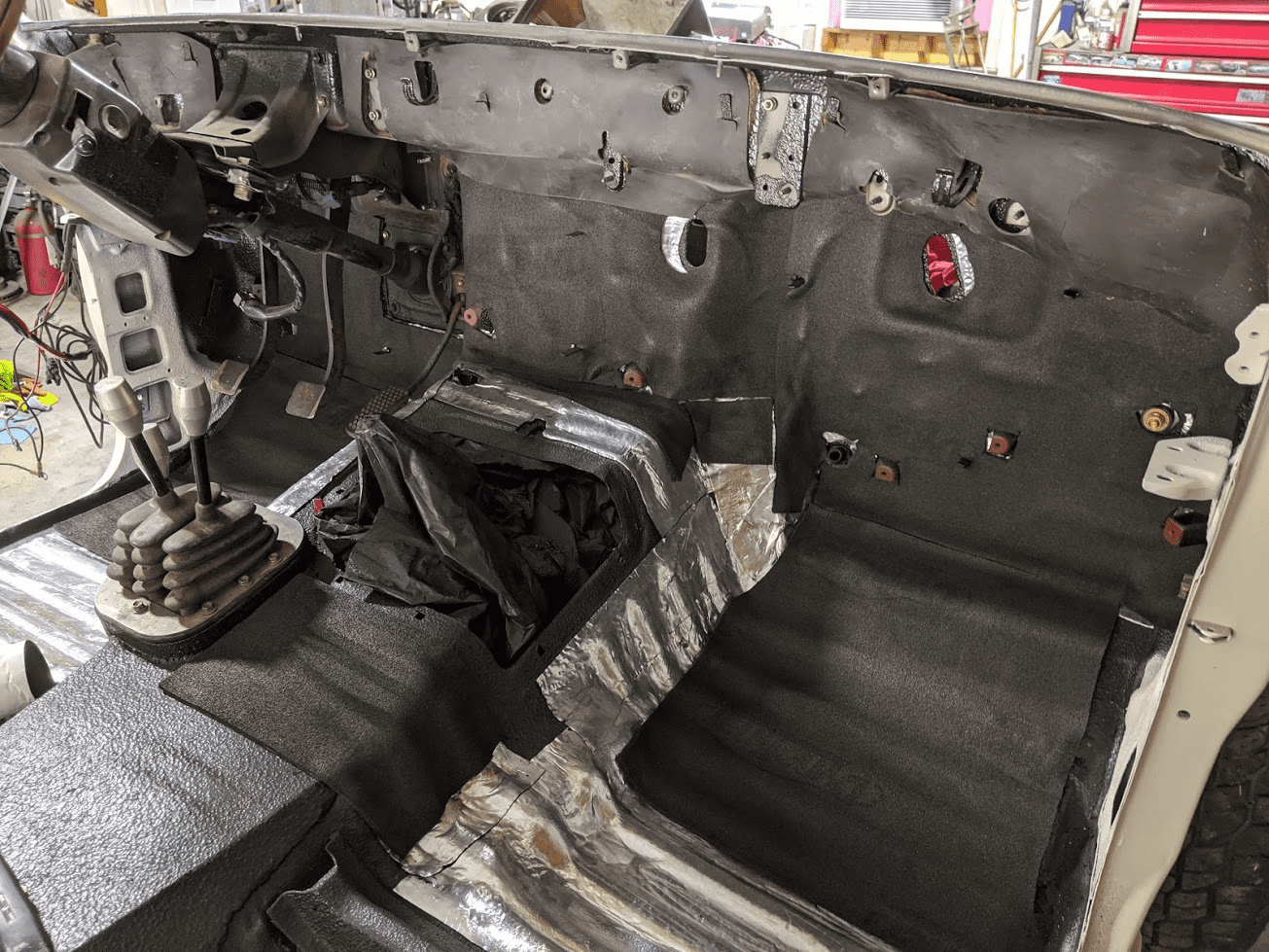

Next up was insulation. Lizard skin sound control and ceramic insulation were sprayed on then painted over. Over that, a second skin asphalt stick on sound deadener (silver stuff) like dynamat. Over that, adhesive-backed dyna-liner. Over that, some carpet underlayment stuff I had laying around. Finally, rubber/vinyl flooring stuff I've had kicking around. I think this will be a good solution.

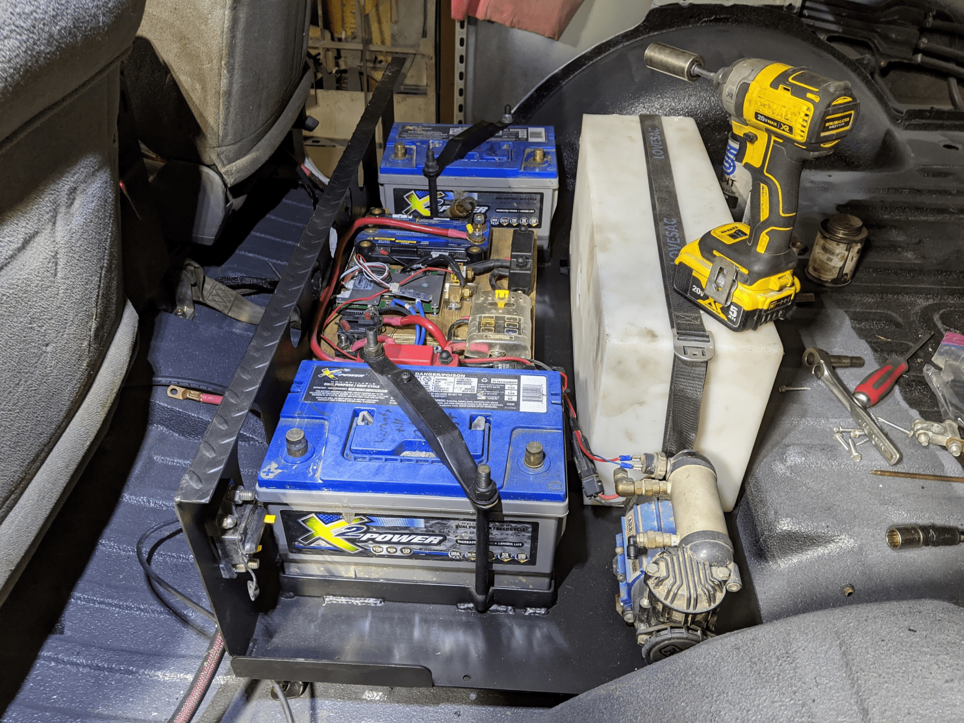

Reassembly continues. I'm a fan of how this battery tray came together, and after a few reinforcements underneath, it's as solid as a rock.
The lithium batteries are insulated on the bottom with two layers of fatmat (above and below the steel tray), a piece of rubber flooring material, and insulated above with some carpet underlayment. The batteries are held in place with two layers of carpet underlayment pressing down on them. Seems to be secure.

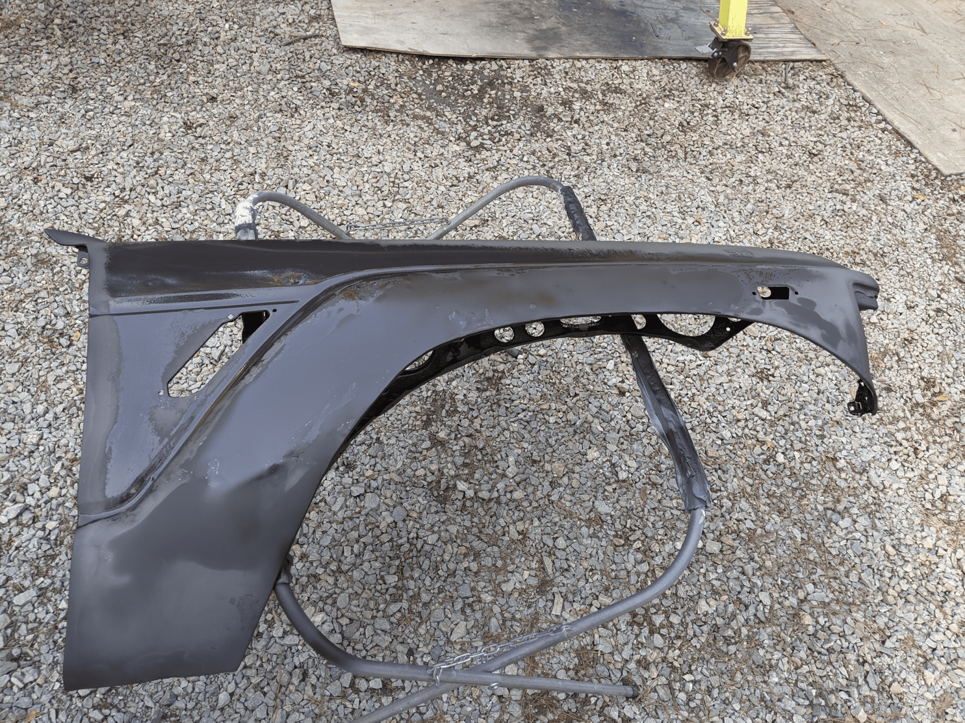

While working on reassembly, the doors and fenders got a skim coat of bondo, final dents hammered out, sanded, and shot with another layer of epoxy primer. They will get top coat paint a bit later this week. The painted pics are from this morning, and the wetness is morning dew.
This fender was the last one to get shot, and it may not have cured fully before it got cold. Will assess later today. Everything else looks great.
