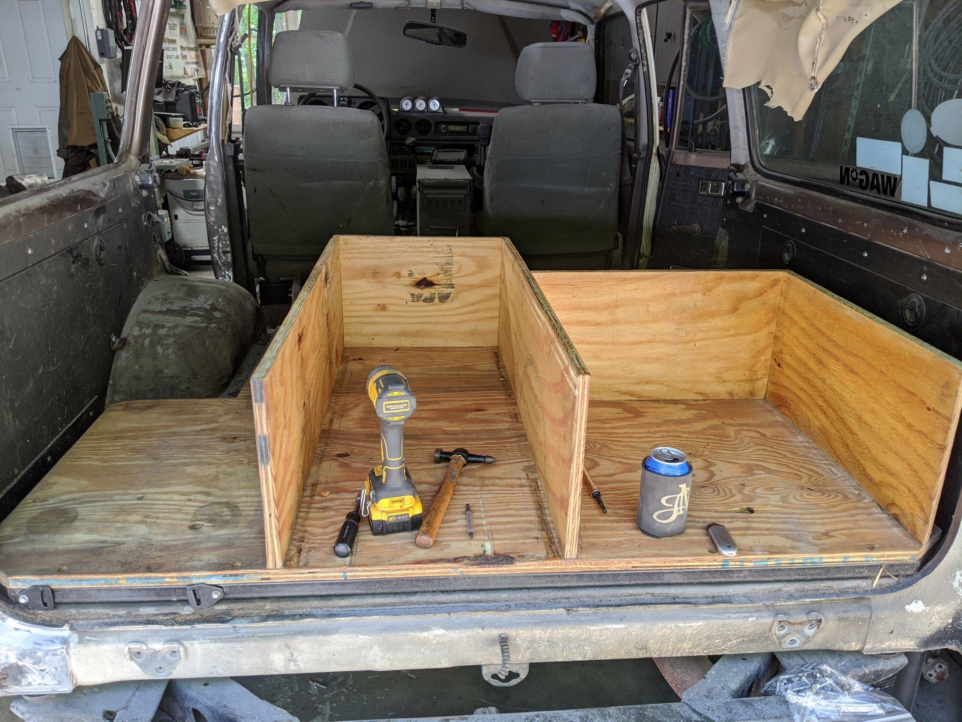

saw your pic above (tired to quote that...hope it works post # 3831 above). Anyway what was the logic on using the metal frame on the floorboard for your rear bead area. I presume the floor (wood) attaches to that...etc. What was the driver to approach it that way? I'm looking to do something similar on my truck (install a wood floor) and then attach various things to the wood..etc. Also I noted you were running what looks like a 90' degree fitting on your ps resivor....what size is that, I have a similar ps resivor and I want to do a better job on venting it (on the vent hole / cap). thanks
At some point I want some type of storage in the rear bed and a mount for a refrigerator / cooler an dlikely will try to cram an air compressor in the area too. thought about using 3/4 marine plywood as the base for this and the metal frame idea looks good to have a good way in which to gain access to the bottom of the flywood floor, obviously I want to limit any holes to be drilled in the floor board.

When I built this rev of the sleeping platform, i wanted to limit the holes in the floor, so I built the metal frame. I had 1x1 box tubing available, so that's what I used. The metal frame attaches to the seat belt bolts up front, then one of the two small holes in the back near the sill.
On top of the 1x1 frame is 3/4 regular ply. Doesn't need to be marine ply unless you take your truck swimming with you, something i try to avoid.
The issues I have with this setup::
1. Too much vertical height is wasted, which is important if you want to sleep in the truck. It's tight for me.
2. The system has to be disassembled to remove it from the truck. For me, this means taking the drawers out, then the top off of the box in the truck, then the metal screws holding the ply to the metal frame, then the metal frame itself.
3. No access to the rear quarter panels.
The things I like:
1. Fridge is super secure and in a good place for access
2. The camp kitchen's folding legs kick ASS
3. Keeps stuff secure
I'm going to come up with a new system after i get done with everything else. Just not sure what it looks like yet.
